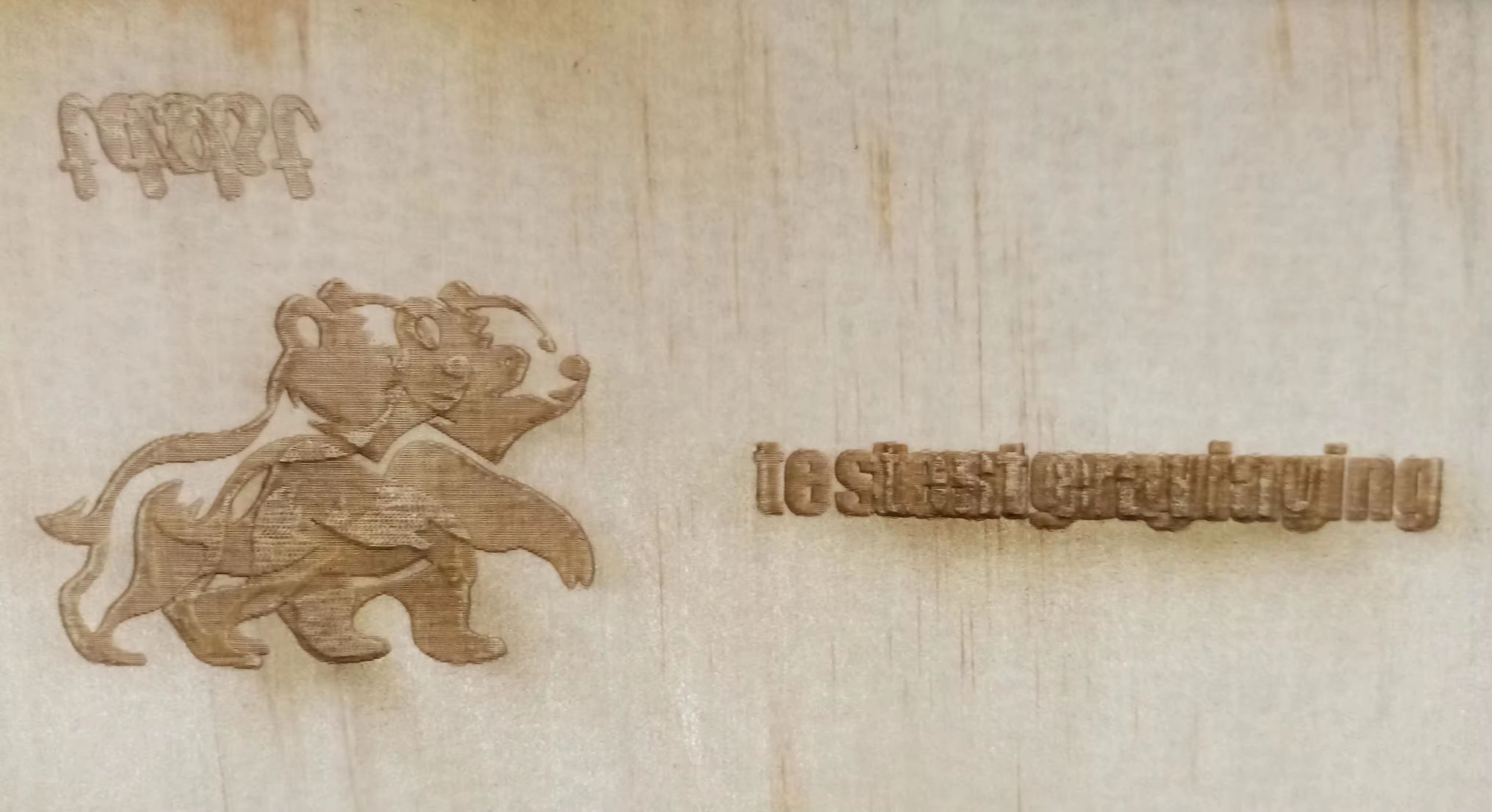

I am attaching a photo of the output. Any help will be greatly appreciated.

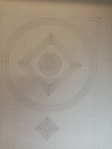

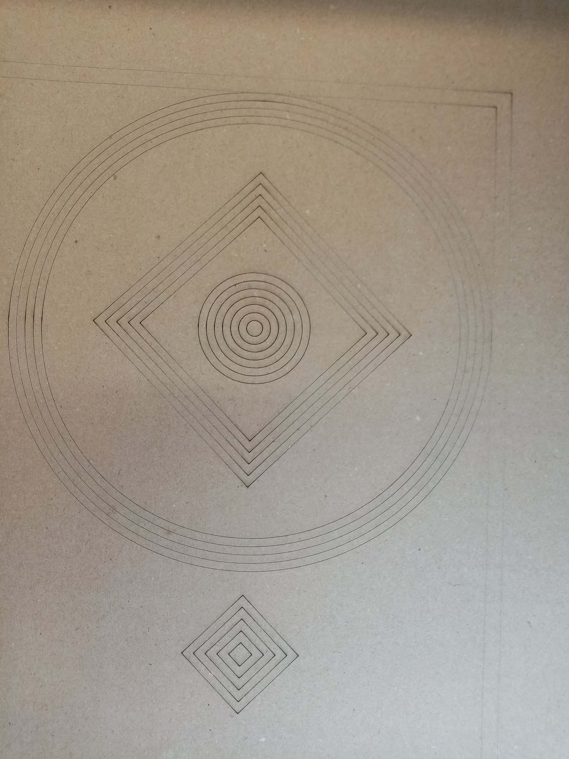

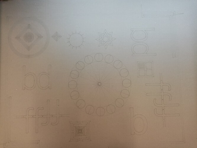

Scale that pattern uniformly to fill the platform and run it as fast as it will go in Line mode with optimizations turned off and power set to mark a sheet of cardboard. Any differences from the design will be informative; a photo will let us look over your shoulder.

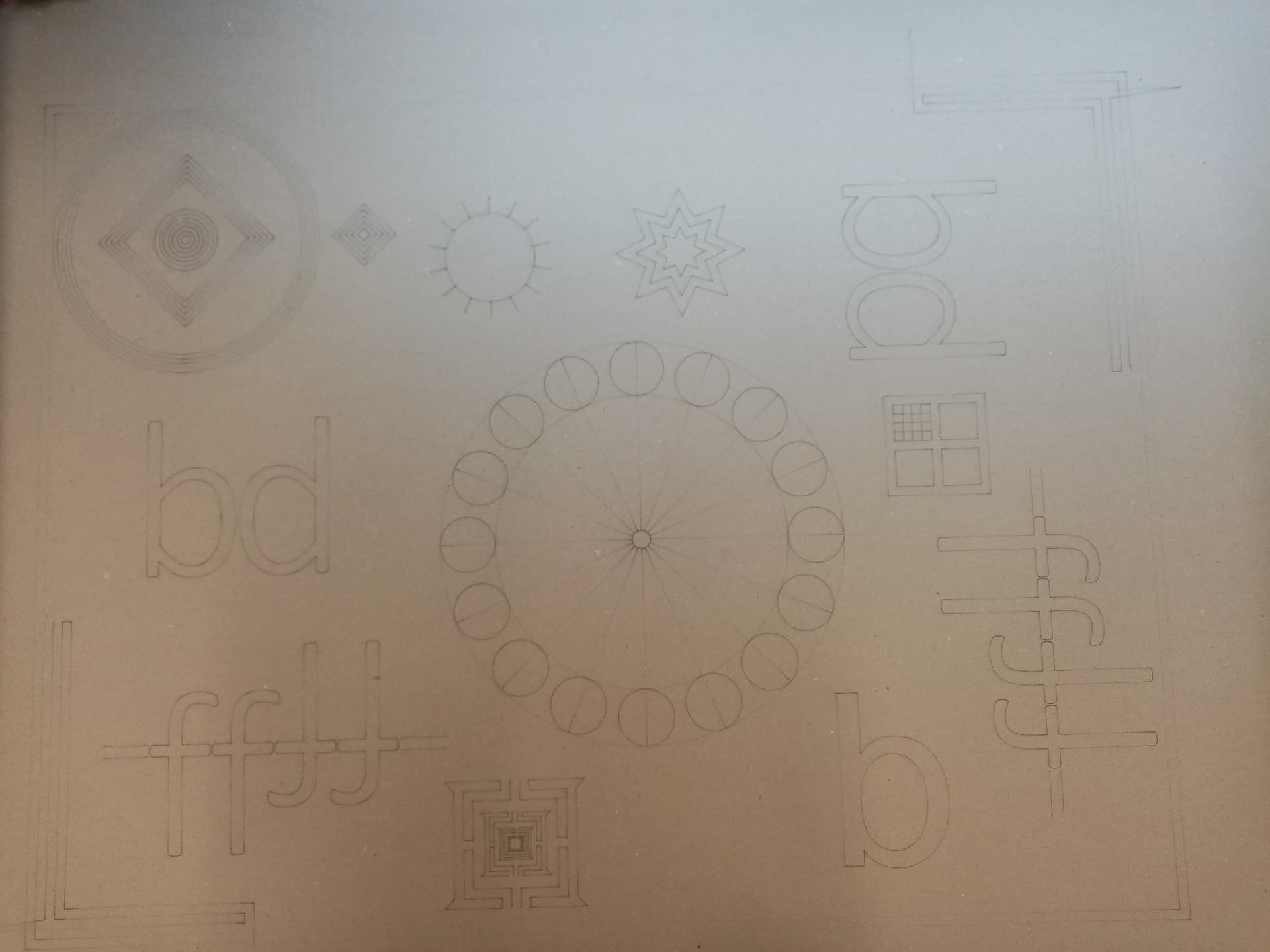

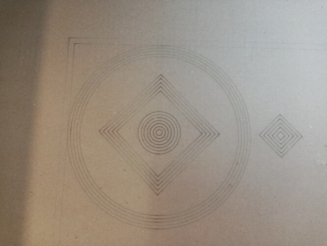

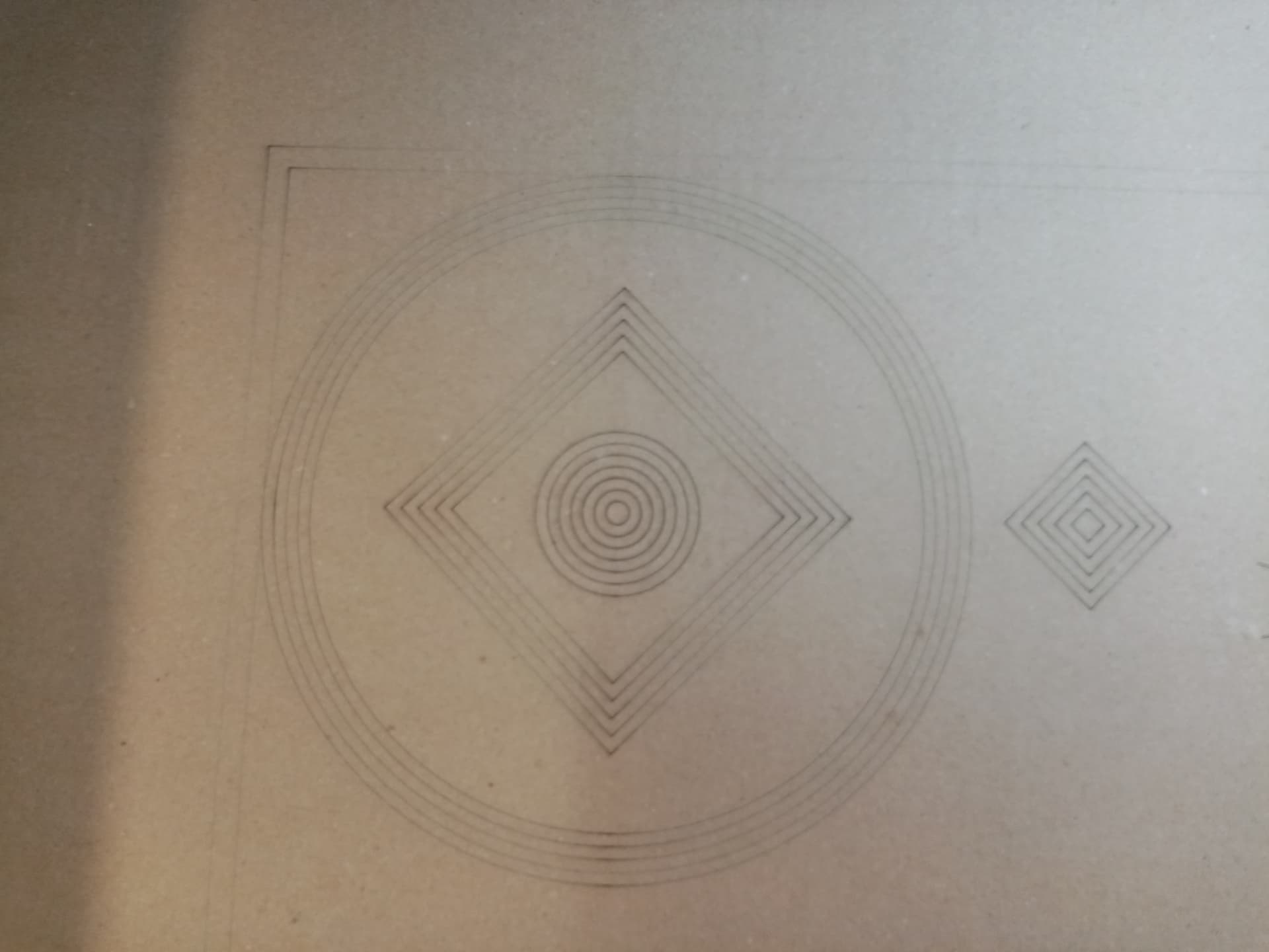

Here are the results of the test file you gave me. The graphic scaled to 700x900 mm and marked at about 1000 mm/s with 15% power.

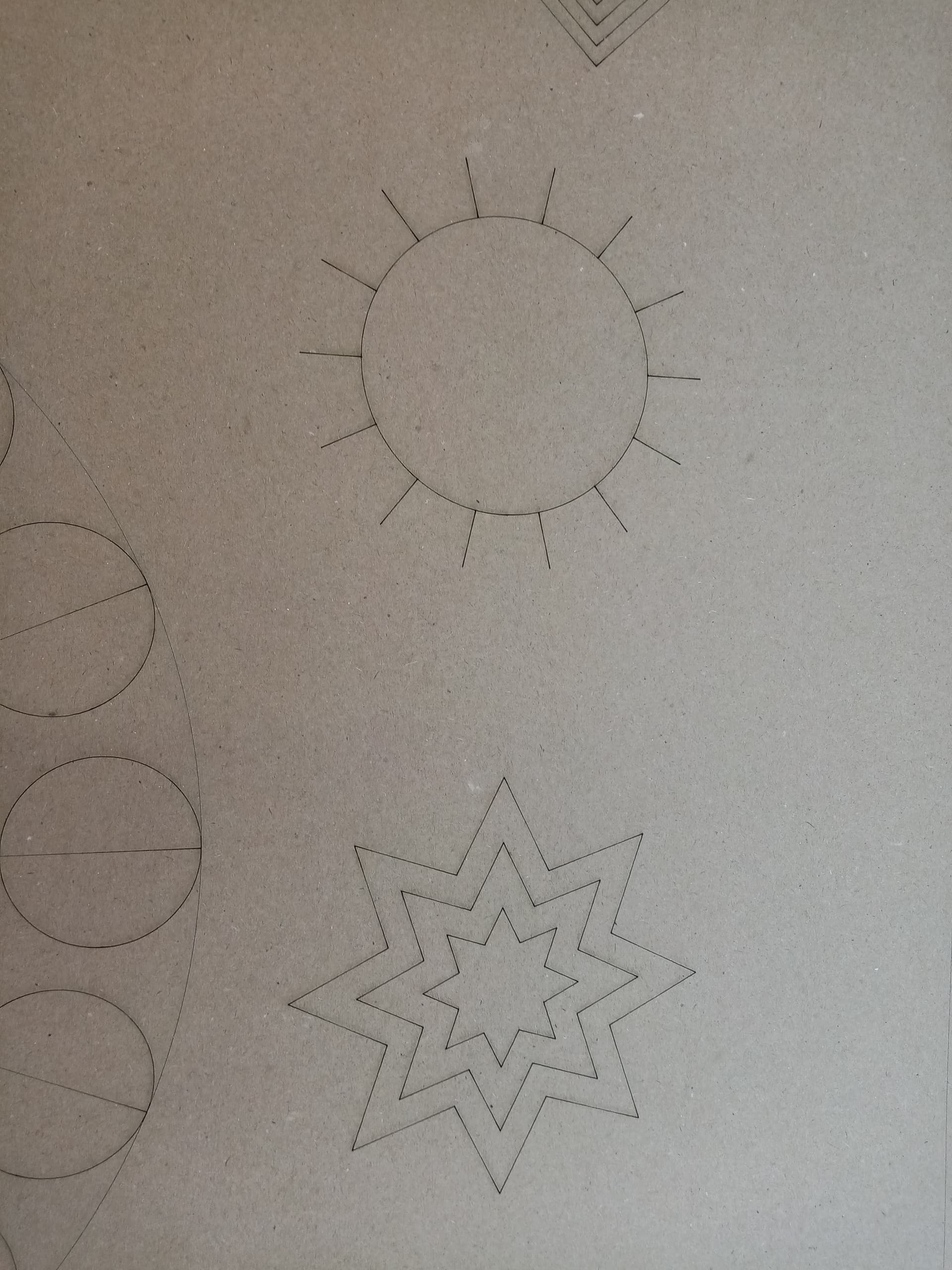

The results seem perfect. Here are some closeups:
As expected these results are flawless because it is in line mode, which is the cutting mode. As I mentioned in the beginning I do not have problems when cutting. Only when engraving in bi-directional mode.

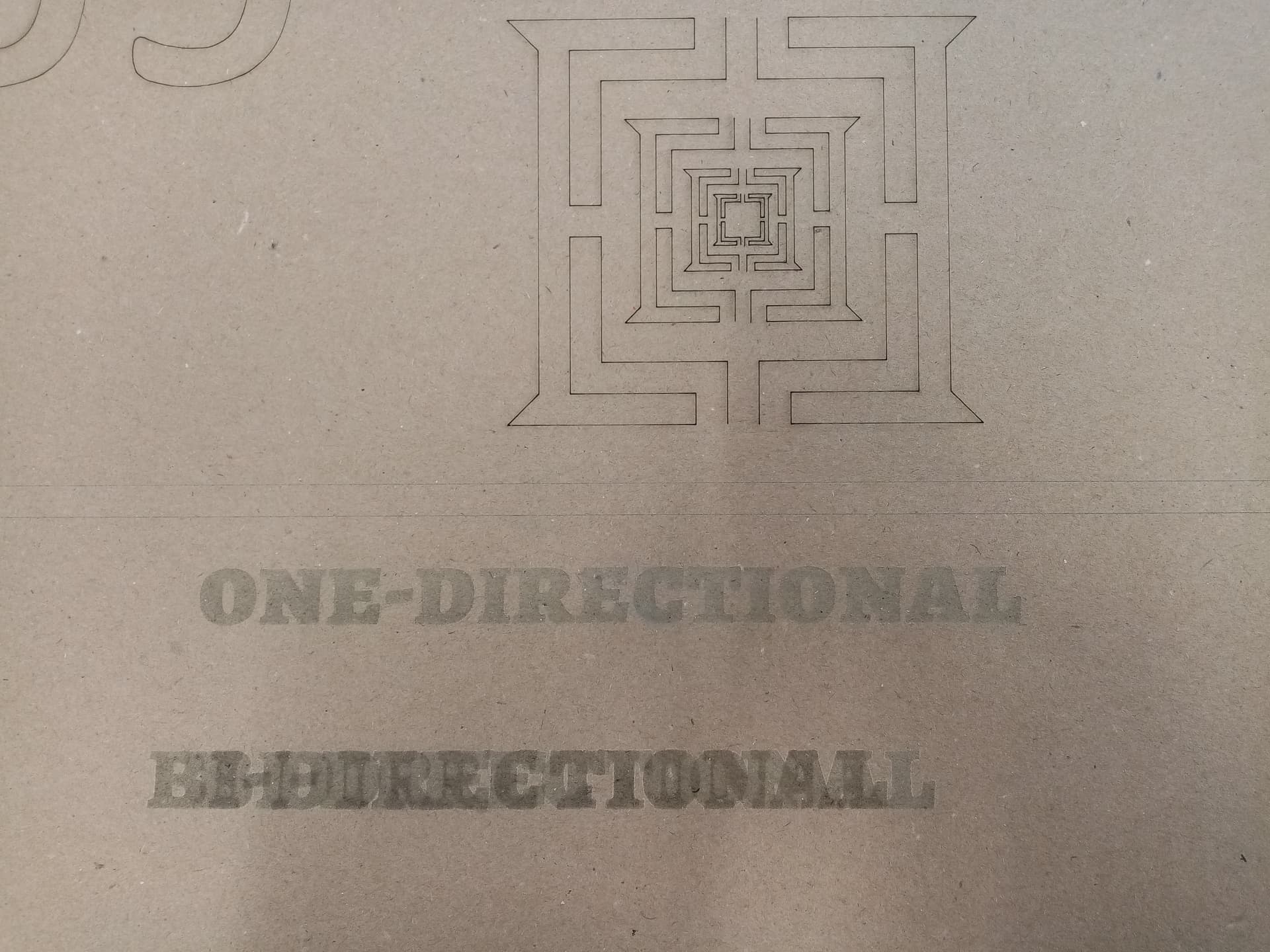

The picture below shows the problem:
The manufacturer of the machine suggested that I do “reverse compensation” in RD Works. This did not help, because no matter what value I entered for compensation the offset only got worse, not better. In fact with 0 value compensation the result was with less offset. I tried positive value and negative value, both produced MORE offset and would not fix the issue.

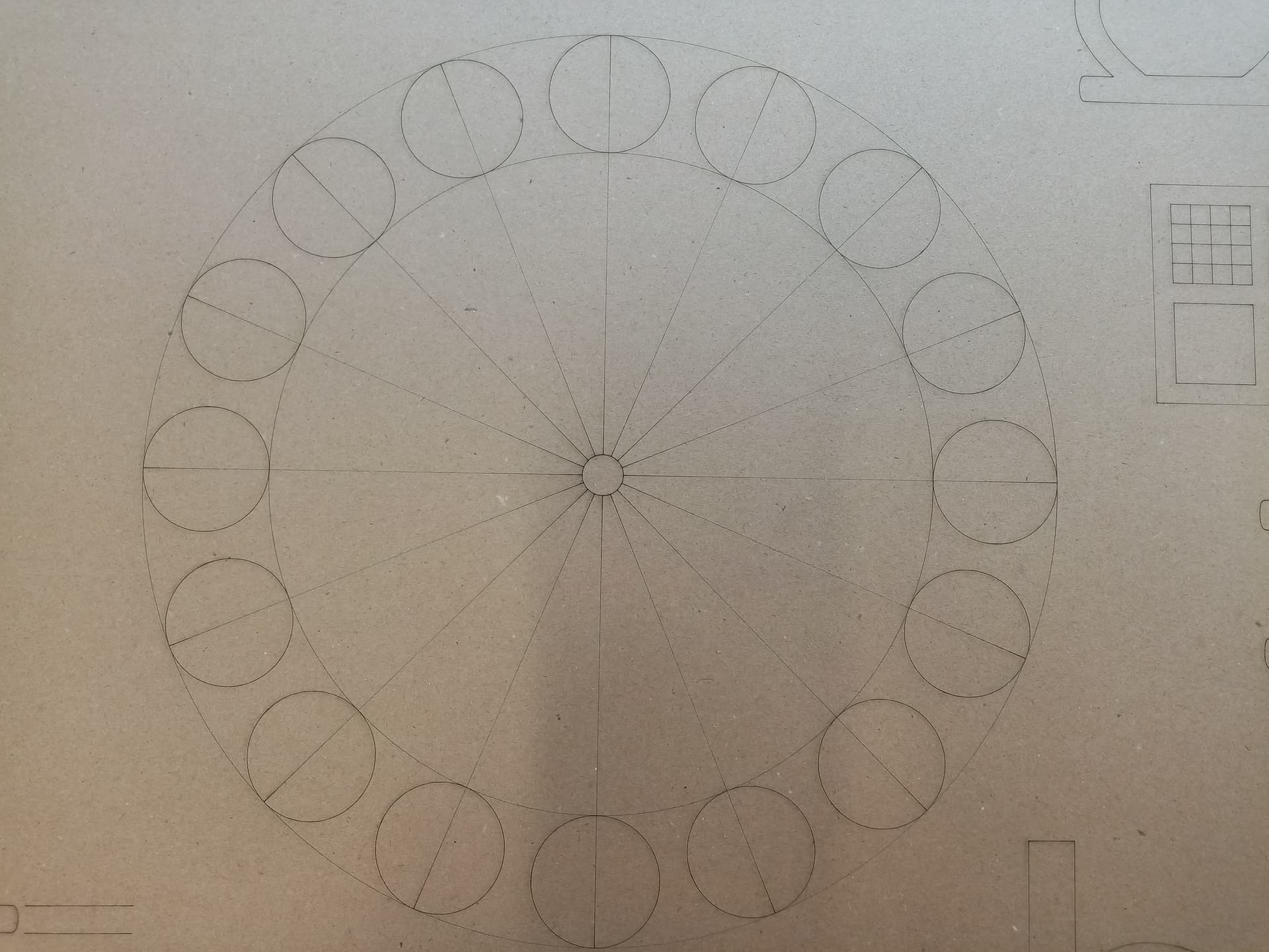

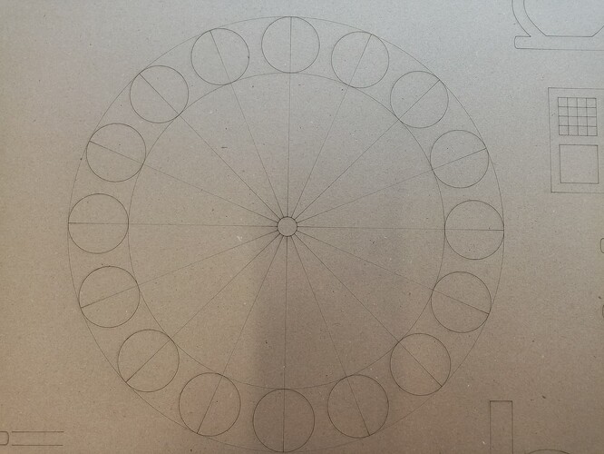

Here are some more closeups from the test file:
Looks good: mechanical problems aren’t at the top of the list.

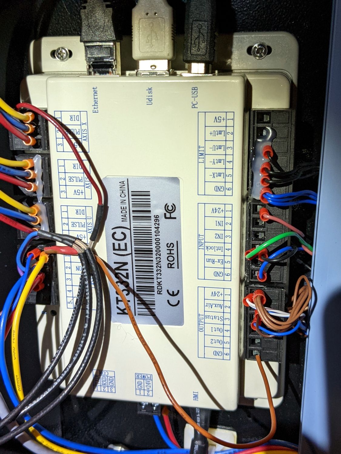

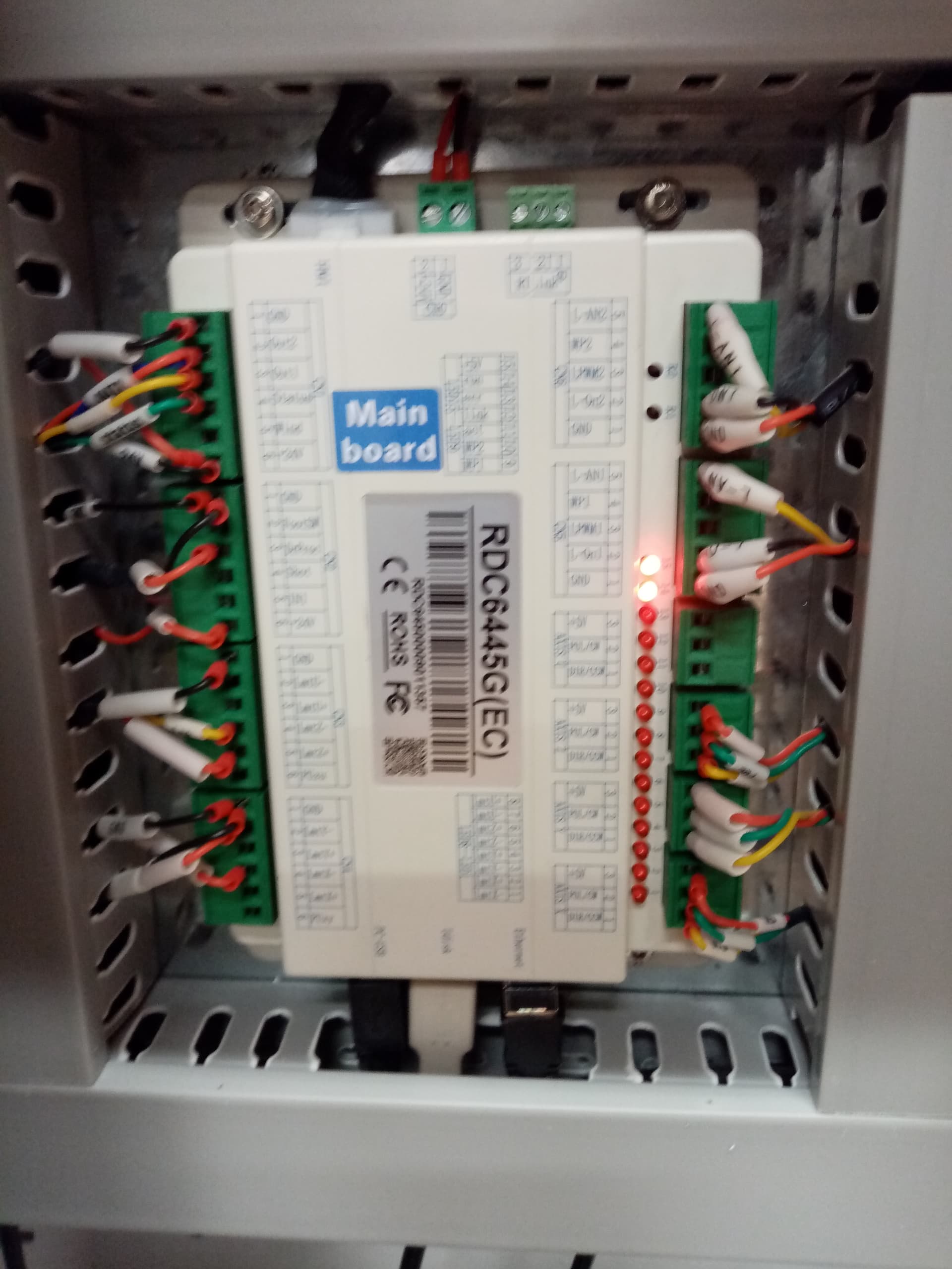

What Ruida controller does the machine have? The model should be visible on the controller inside the electronics bay, like this:
Do a better job than I did about getting the wires out of the way so the number is easily readable. :grin:

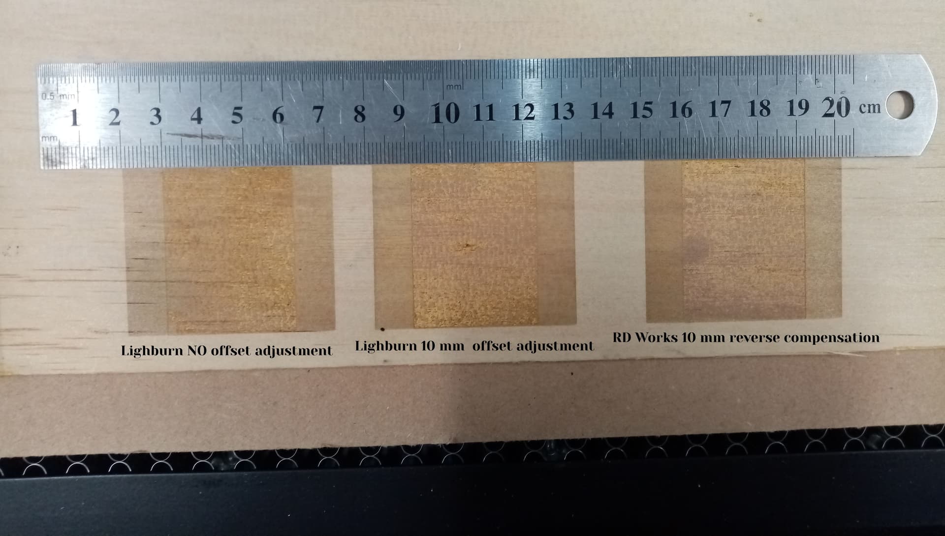

This is the result from the square test. I did 42 mm square and then run it at fill, 1000 mm/s.
Then did with no offset compensation, with 10 mm offset compensation in Lightburn and with 10 mm offset compensation in RD Works. The compensation settings changed nothing, as the offset remained the same at 10 mm.

And this is the photo of the controller:

Does the offset change at different speeds? Run that same square at 250 and 500 mm/s.
Different offsets would be the typical behavior, but the power supply timing is fractions of a millisecond rather than the 10 ms (10 mm / 1000 mm/s) in those photos, so I don’t expect the speed will matter.
