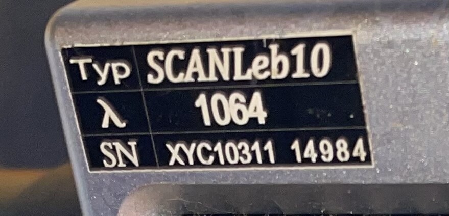

I think it’s a Mac-10 knockoff. I was told it’s a fake. I would guess because of the serial number.
But, I would venture to say it would be a RC1001
What’s in the pic is what I have
Would a SG7110 work on my machine?
Yes. They are all pretty much same DB connector and screw pattern. Where you get into differences as far as I know is if it has focusing lasers, z axis buttons, stuff like that. Google images the model number if you have any concerns.
On the other forum, same issue, Cloudray told the OP it would need a new PSU. Didn’t say why. I think they are all 15v but maybe not. I think it’s good practice anyway, especially if your machine is built from knock off knockoffs.
Anyway, the SG7110 is 15V.
@jkwilborn has a scan head on his that has better specs then mine, maybe ask what he is rocking. Might as well get a good one.

No reason you would go through tracking down exactly which head you have unless you wanted to know. The advertisement you posted the speeds are faster then mine. It also shows at the top it is made by ZBTK Tech. I suggested to the OP to see what you had as an option because he was talking about upgrading. :smiling_face_with_sunglasses:
Serial and model number on the head. Cloudray in the past has used SinoGalvo but your numbers are a little better then the spec sheet for my SG7110. You could compare your specs to the several SG galvos available until you find one that matches, maybe. If you have a bunch of time to waste in the name of science.
Not on mine, there is no manufacturer or vendor names. The only thing on it are two warning labels about laser beams and one that says warranty void if broken.
Would that make it work better? I’m not following, if I did find a match they would be the same?
