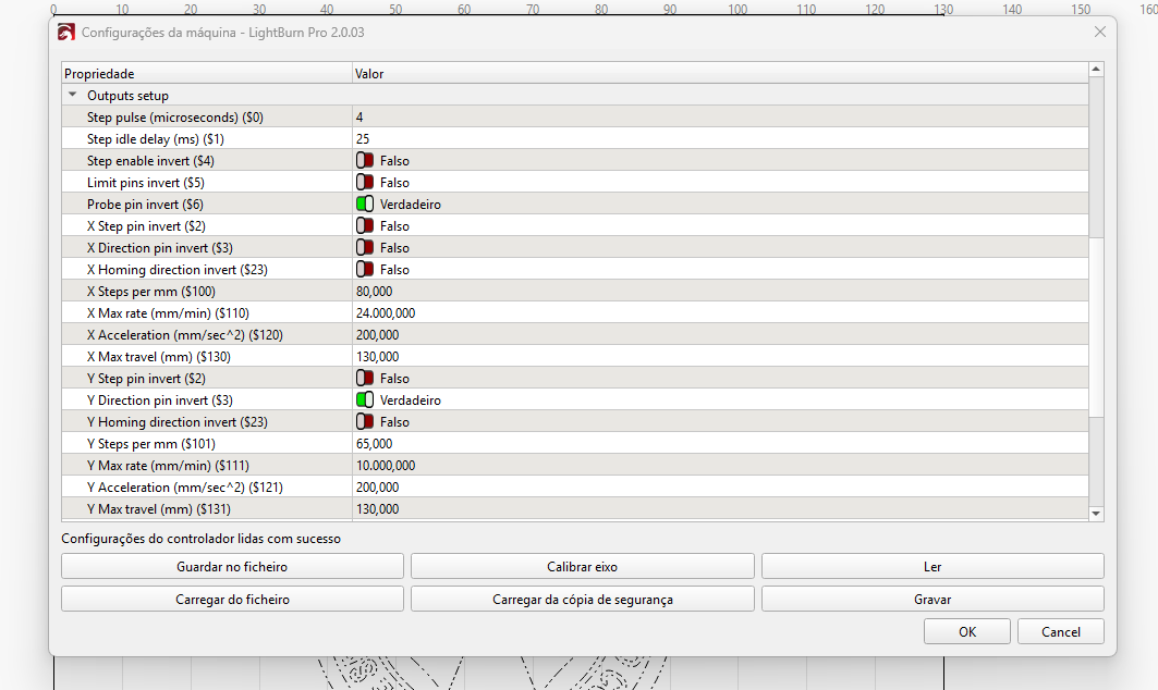

Hello, i was installing the M3 Roller from Acmer, and a follow a tuto from Youtube, and i can remeber what happend to my brand new Acmer S1 mini, due now doenst work properly. I wandering if someone with the same machine could help.
Pedro, you have not told us very much. Can you describe what you did and what was the result? Details are important.
hi, i just change some output setting, and now the machine its the opposite side working.
i have a pics from it.

I have a Acmer S1 mini 3,5W.
OS Windows 11
Lightburn 2.003
I just need to now how those āFALSEā or āTRUEā its wrong.

Did you change settings in āDevice settingsā I searched online and the instructions for use with lightburn 2.03 said the configuration should be already set and changes are best made by advanced users and for specific reasons.
Do you have a specific reason to change cofig settings?
If you have changed settings but cannot remember how they were set previously you may be able to reload previous settings if they are stored in memory from a past date.
Could you also reload the original configuration file and start over.
You can search previous conversations using suitable keywords and check Lightburn Documentation for answers to these questions.

GRBL Configuration in lightburn Docās gives lots of info.
I think maybe you would have to save the configuration file and save it somewhere to be able to know how settings were previously.
I think if you go to the āconsoleā window and type $$ it will list the configuration as it is now, after that someone may read it and tell you how to improve things.
Also if you can explain exactly what is happening and post any pictures that might help.
Does this mean something is backwards?
- Does the Acmer S1 mini 3,5W have limit switches?
- Does it try to Home?
- Are the JOG directions backwards?
Home (if enabled) and JOG direction must be correct for everything else to be right.
