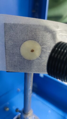

Hello, is it normal for a brand new EFR X4 100w, to cut 10mm cast acrylic with speed 3% and power 99%?
Anything faster or lower power wont cut it. Also get not vertical cut
This is an alignment issue… it’s likely causing the poor cut ability.
The tube was stored for 12-14 months. Is there any possibility that this wears the tube?
Always a possibility, but doubtful.
Have you checked the TEM resonance mode? That would be a good idea…
So as I understand, only TEM00 pattern on mirror 1 is acceptable to have good laser tube?
Got 3 pulses on first mirror. One looks like Tem00 but the other two look like Tem10
Is this a reason for low power?
Yep… nothing you can do to fix the resonance.

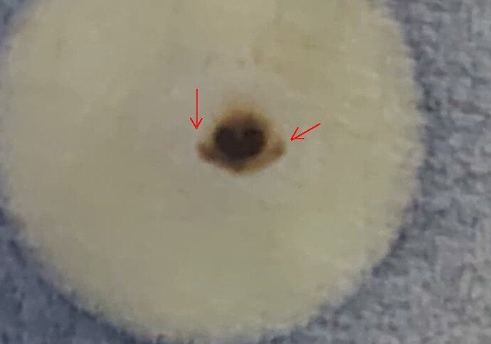

If you look at your first post, it’s pretty clear it’s failing there. Besides the fact the center area isn’t round … the two tails that I’ve marked should not exists… this is power outside of the beam.
This is the ideal power distribution… Dark in the center (higher power density) and lighter as it moves outward. All even…
Sorry about your tube, bearer of bad news is never good… at least it wasn’t a surprise.

Soyou think the tube was bad from the beginning or got this after 1 year sitting in the box?
And this means that the tube is dying, or its weak because of the non concentrated beam?
Possible… less likely if you live in the N Pole than at the equator… I think a lot of shelf life is ambient temperature… If it’s been this way since you got it, what would you conclude?

A lens on your machine is like a camera lens. So if the power is not distributed corrected, it can’t be pinpointed correctly. This results in a vast amount of power loss at the focus point… your focused dot looks like the input beam, just smaller. Just like a picture looks like the real image, just smaller.
Make sense?
Probably a good time to contact the vendor and see if they’ll replace it. Send them the photos.
