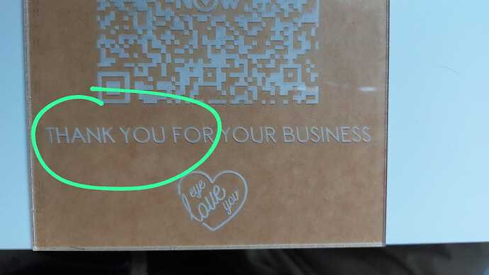

Feeling frustrated that I cannot engrave properly. I created the texts using lightburn or via SVG files which I created on Inkscape. However, when engraved, certain levels of wording will be slanted. Cutting is ok. Any help will be greatly appreciated.
Using a gcode laser cutting machine. I connect via usb cable to my lionforge laser cutting machine
this is my setting

The most glaring thing for me is the engrave speed units.
100 mm/s is 6000mm/min.
This is likely responsible for all the frustration.
I suspect it will clear up if you keep it below 2000mm/min.

And yes, speed is too high for lionsforge since it uses screw rods rather than belt. Try lowering it to like 15mm/s with lower power settings. In my own tests, even higher speed setting doesn’t seem to have any effect.

yeap. he trying to help as well. what we experience is that image text is ok but when text directly done on light burn or vector text then the problems comes in.
@Johann1314 i see your engraving speed is 1200mm/min and when converted to mm/s is 20mm/s ?
am i right or my calculation is wrong? :smiley:

you are right. I just decided to try from that speed onwards since i already had the settings that worked on another test piece.

While neither of those seemed to be the cause of your problem, it hints to me that the controller has some limitations, so it’s best to try to slow down the speed if possible.
I hadn’t come to the same conclusion based on the symptoms. Communication issues typically manifest differently. But this could be checked by using LightBurn g-code and using something else to send to the laser.
alrighty…shall take note of the speed…cause previously keewee told me to be 130mm/s
