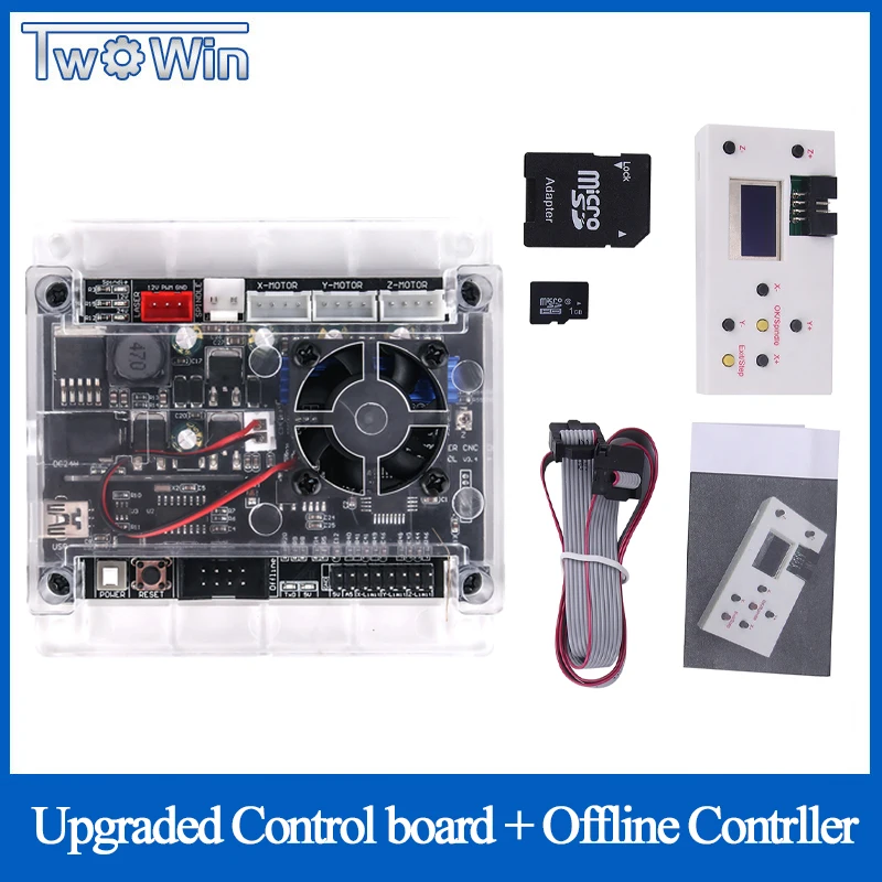

I would say a bad board. It happened to me, replaced board with a different brand, never happened again. Replace the control board especially when it happens at the same time and place.
It is hit and miss, if I re-run the job after it fails, it runs completely through, but first time engraving a picture seems to fail anywhere between 4 minutes and 18 minutes. What board would you suggest? are there any boards that have enough memory to engrave a picture on them? that would eliminate the USB cable comm. issues. Thanks
Here is what I am now using:
I t 3 axis but only use 2… for now.
Is this a plug and play board that will work with my Laser Master 2 20w or will I have to make some custom cables? With the offline control and memory card can you download lightburn jobs to it and run them from the card? Thanks
It was plug and play for me. I think I had to flip 2 wires on each stepper motor. Load your machine settings, maybe calibrate your step moves, maybe not. I think the steps are steps in your machine settings. But best to check and adjust. Otherwise it was plug and play. I flipped the wire connectors by using a tiny jeweler screw drive to release the lock on the pin and reinsert as needed.
Thanks - sounds easy enough. Just had to switch polarity on the stepper motors. Do you have an Ortur Laser Master 2? Are you using the offline option? If so how is it working? Thanks
I have a 65 by 50 CM china set up, no brand name as I know. USB from dedicated pc connection with Lightburn as my connection to the board.
