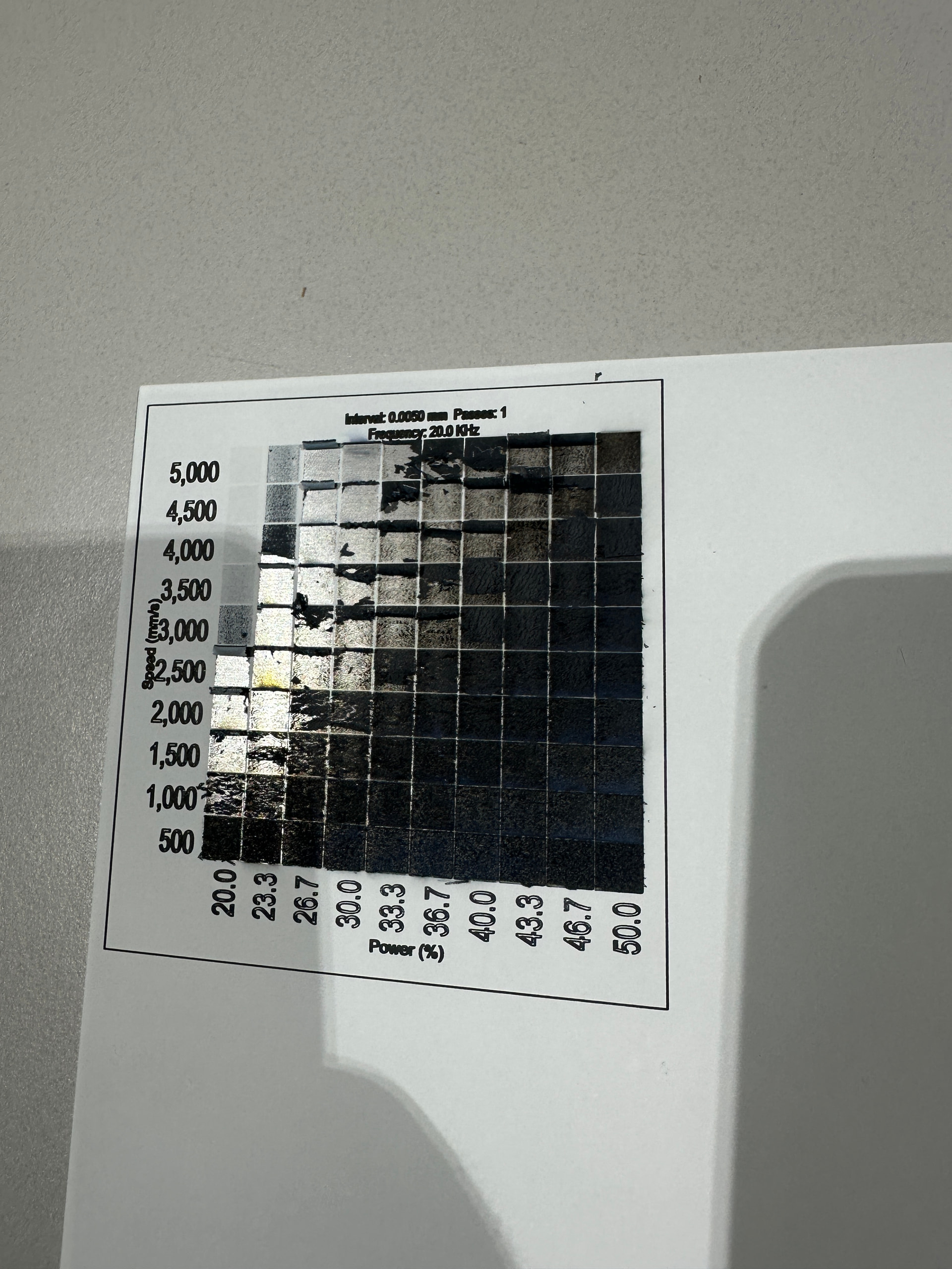

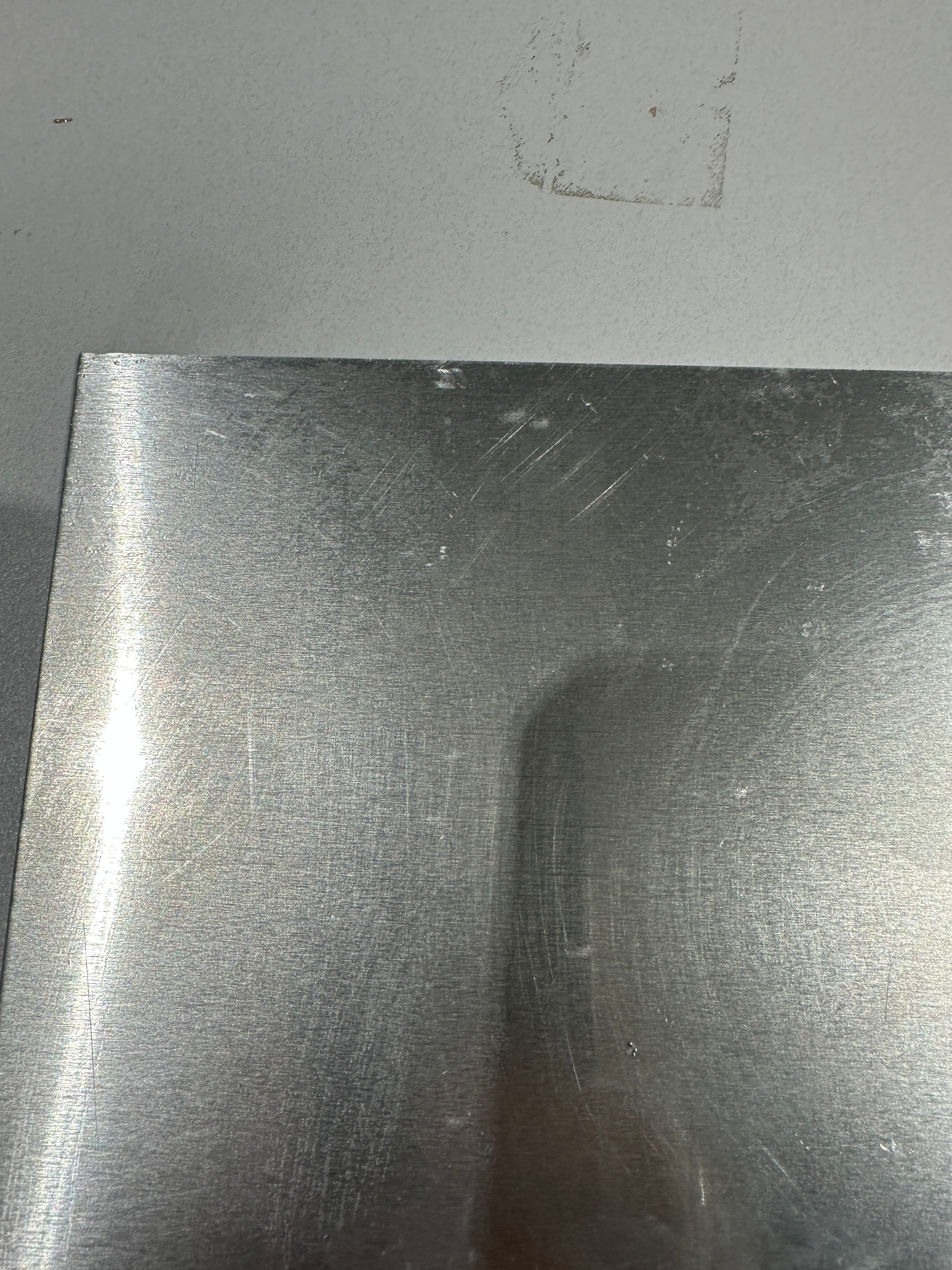

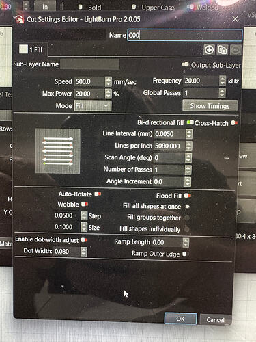

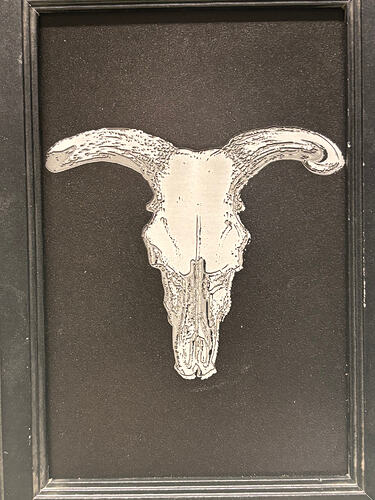

I am trying to engrave some Aluminum with some Brilliance Black Marking Spray with a Diode laser. I am not having any luck. Attached are some

photos to show the settings and the results.
Please let me know.
Thank You

  2. I marked aluminum dog tags using Cermark spray and a 10w diode laser. Success likely depends a lot on the mass of the aluminum.
Give your images another try.
I agree with Mike’s words.
The greater the mass, the greater the heat distribution instead of the greater heat concentration, which is what matters in this case.
I, with a 5-ish W diode laser, can engrave black anodized business cards with “considerable” ease, I would say.

Here are the photos.

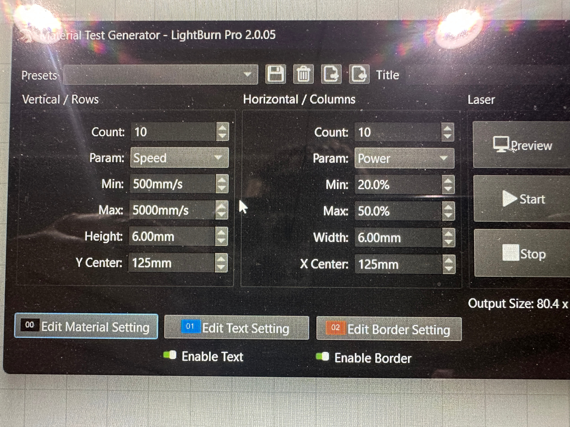

The mm/s speed unit is incorrect for a diode laser.
Change the unit to mm/min with the same numeric value and the results will dramatically improve.
https://docs.lightburnsoftware.com/2.1/Reference/DeviceSettings/DimensionsUnits/#control-units

That second image is not for a diode laser. There is nomFrequency setting for a diode. It looks like fiber or galvo window.
Please clarify…
I asked omtech that question and they say you can set frequency to whatever you want it just won’t change anything.
Omtech doesn’t offer any diode lasers, as far as I know. What is the exact model of your laser? You either added the wrong device type or have a different laser.
Anyway, with a diode laser, it’s nearly impossible to mark any aluminum; you would need extremely high powers. Even with marking powder or similar, you can usually rub it off.
I have a OmTech Solis Duo which is 50 watt fiber and 40 watt diode.

Then I guess your issue is that you need to switch to the second laser source, the IR laser. That one can mark aluminum directly. The blue diode can’t.
So what you are saying is I can not use a Diode laser to mark aluminum even with a marking spray?
Not a blue diode at 450nm. It’s just physics. Wrong wavelength. But with a 1064nm, you will be more successful.

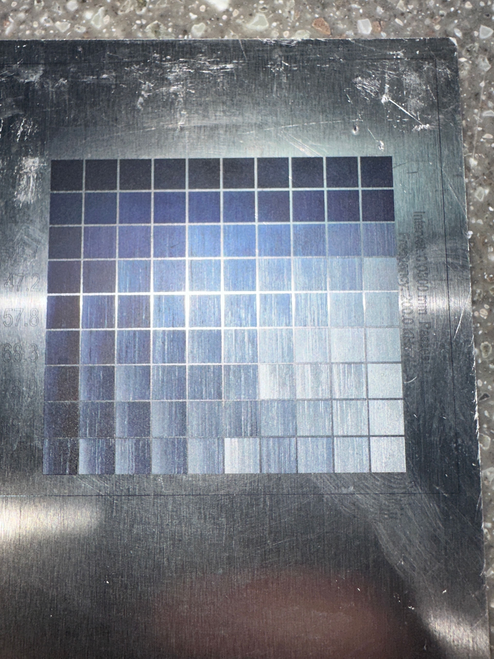

Hi Guys
Thank you for all your advice. I tried with my fiber and it works super. The best setting I found was 150 mm/s at 16% power and 200 KHZ. Looks good to me. So when engraving anodized aluminum
what laser is the best for that? Fiber or diode.
