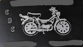

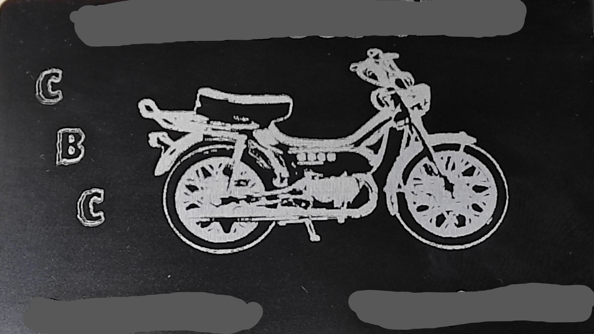

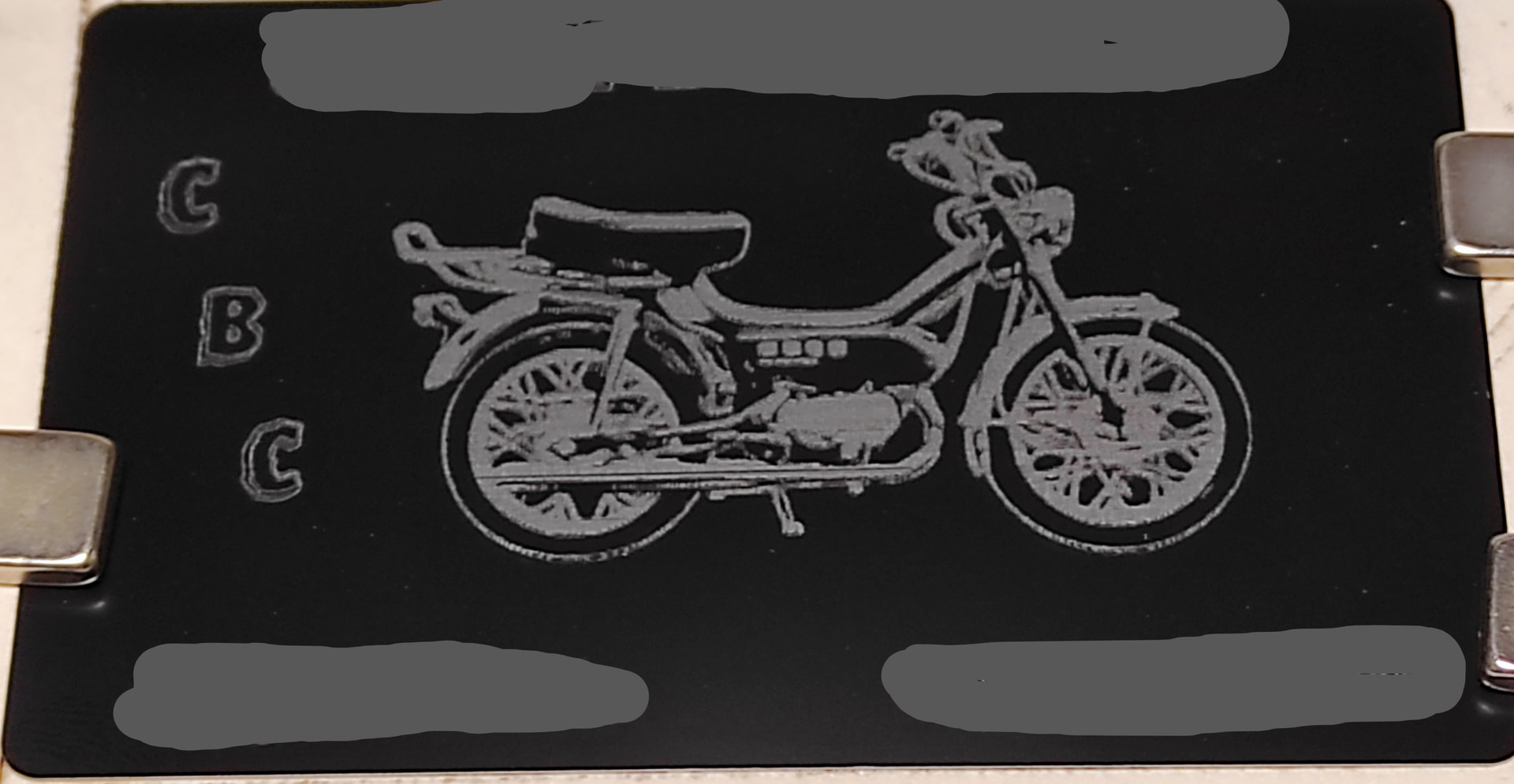

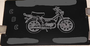

My second aluminum card I did.
On the machine:
After cleaning:
24W diode, 800mm/m 70% Image: passthrough.

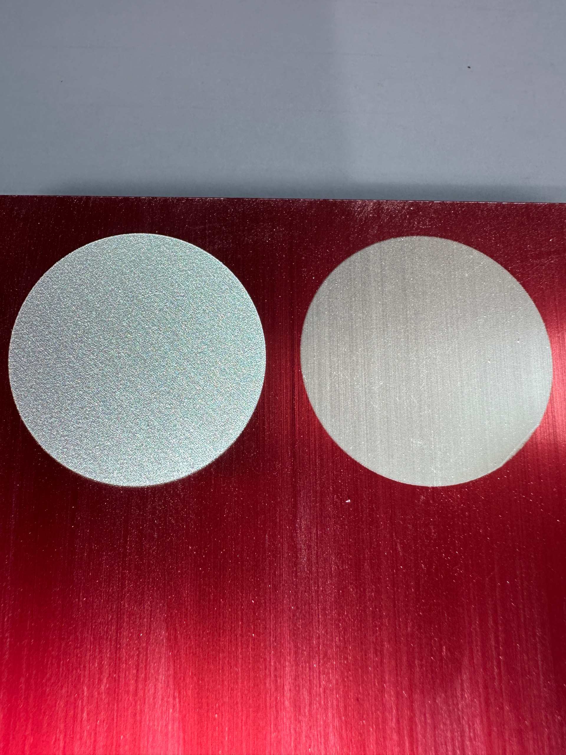

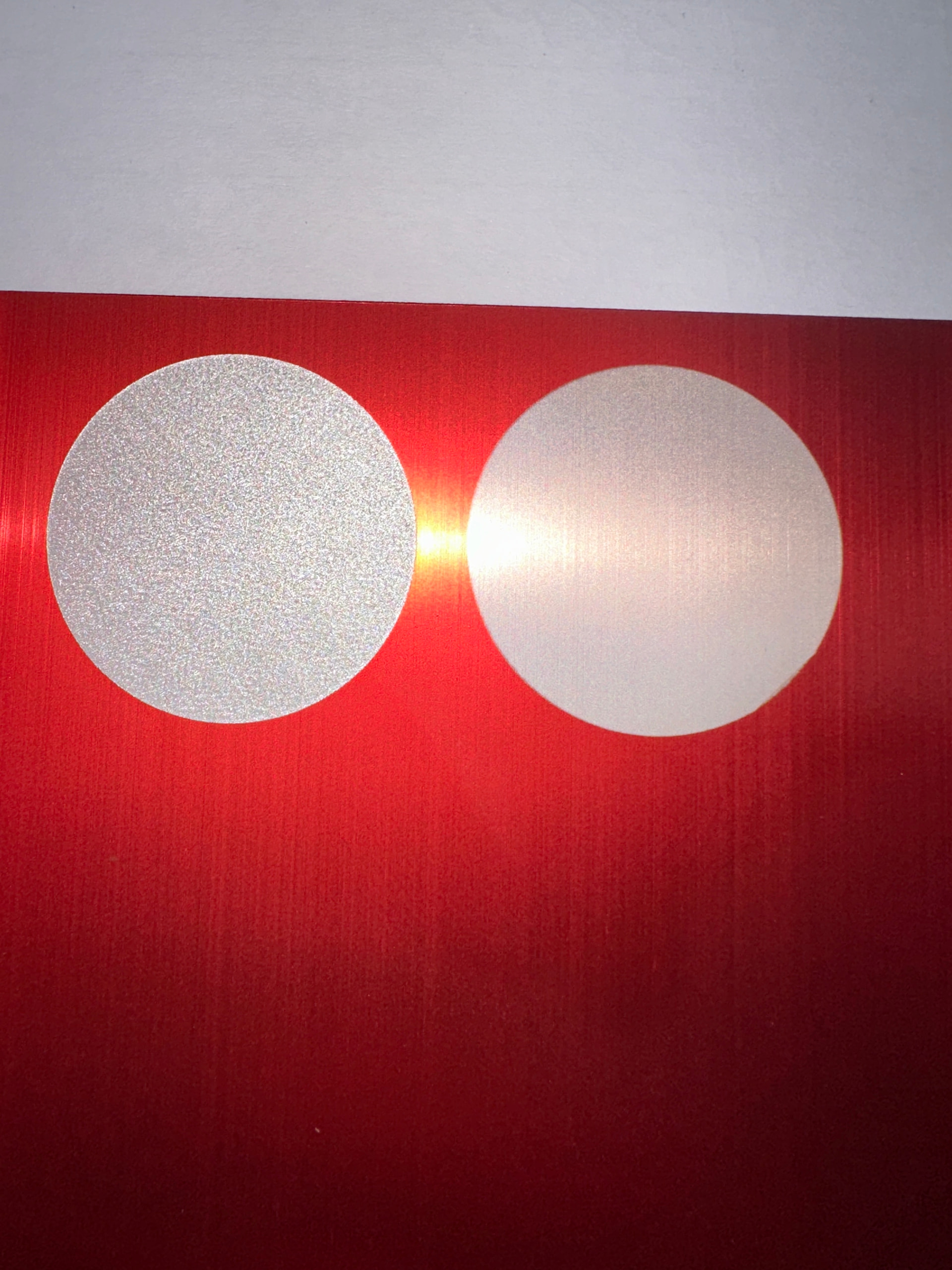

Correct me if I’m wrong but then engraving Anodized Aluminum with a fiber laser it will remove the anodized layer but when engraving it with a Diode laser it just makes the anodized layer whitish. Attached is a photo the left circle is fiber and the right is diode. On the fiber laser I can feel it went into the aluminum but on the diode circle its smooth. Let me know
What?
Generally speaking the visible led is not applicable to metals. It only can effect the anodizing so wherever is happening is probably what you get. You could see if someone here a better suggestions for speed and power using your visible light led when using anodized aluminum.
A lot of people have good results with the coated aluminum cards.
The fiber is the right tool to remove the metal and shows you that in the testing…
So, what’s the question?
:grinning_cat:
The question is I have been engraving LED lights for customers and on some when I take the anodized layer off with the fiber the aluminum doesn’t look the best and some look perfect. So that’s y i just want to bleach the anodized layer that way they all look the same. The edges with the fiber look sharper but some backgrounds look pretty bad on some.
