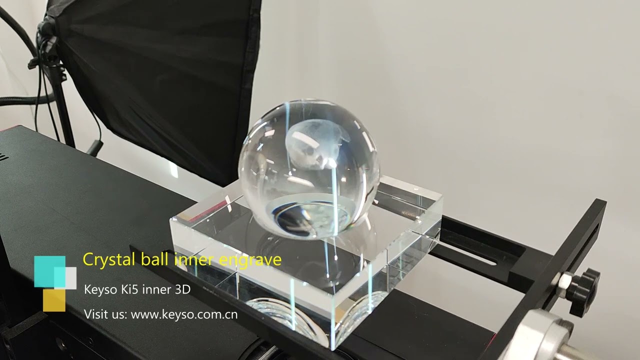

I recently added a Commarker Omni X to my other lasers as I wanted to play with crystal internal engravings, and I can see on their webpage some pictures of those, including spheres:
I made a few engravings inside square blocks and they turn out lovely, but trying on a sphere I get no results. I do believe there is some calculations going on to account for the refraction of the laser beam when it transition from air to glass, and I believe those calculations should be VERY different if the laser hits a planar face or a spherical surface, but nowhere in their software I can find a settings for that… I sent an email to commarker support and so far no answer… I tend to believe that inside engraving in a sphere is not possible with this machine, then why do they put those images on their website? plain marketing deceivement? or is there something I do not understand?

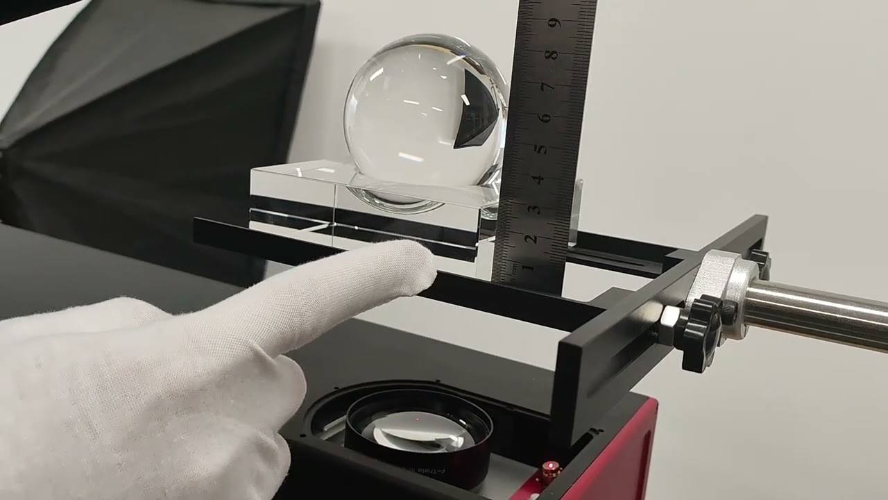

Have a look at keyso’s video; they use an “adapter” of the same type of glass and a little water to create a planar face

In their defense: they didn’t tell you how it’s done. The technique in the video above should work, but I get what you mean!
Your supplier of the glass spheres might be familiar with these physics limitation and have the other half of the sphere available?
Turning the machine upside down and getting a custom made optical glass mold doesn’t sound like something the machine can do, it’s just a hack

Yes, you’d have to turn the crystal and the mold upside down instead.
The mold would need to be a perfect fit, and come from the same supplier that makes the ball. That might be hard to source.
