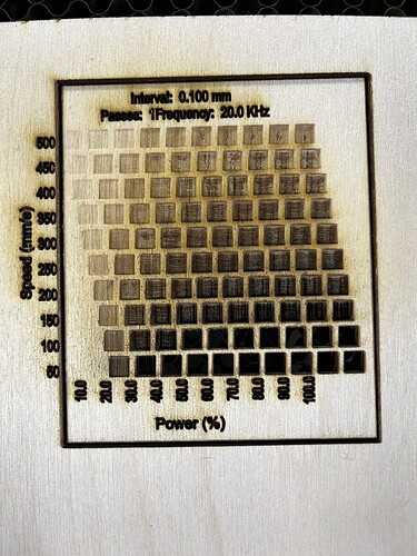

Engraving and cutting aren’t aligned and engraving is skewed or tilted
I am having a problem with my laser, I first noticed it when I started work on a 900mm by 1300mm piece of wood where I noticed that the engraving and the cut layer aren’t aligned properly as if there is a shift between them that makes them overlap. I have tried everything and tried other software and every-time there is a different problem. My lates trial was to run the material test of lightburn with all its default settings. Yet the result is still skewed. My machine is practically new.

Tried it and as per the photo 8 guess everything looks fine. However, I believe the problem only appears either when filling (engraving) or even with lines (cuts) but if they are on different layers.
Yes, that does look good. With that info we should be able to rule out physical slipping.

Here are all 4 variations. The shifting seems uniform but either to the left or to the right depending on the PWM values

That setting seems to produce a pattern marginally better than the others.

Finally it worked out, and it was the simplest thing.
It was just as you said, I had to just make sure that all the switches on both step motors are exactly the same. Apparently, It was just one switch.
And just slightly bumped!
