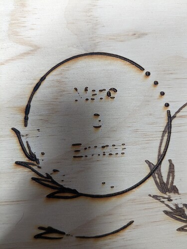

Hi! I have been trying to engrave from a picture and i have a lot of difficulties to make it look good. I create the design in canva and then i download it into a jpeg. Then i change it to png. Has anyone ever done someting like my picture? I would like to have your input on how to make it look neat. Now the only option that kind of look good is if i trace the image and then use the option line, but the laser will trace both sides of the line instead of doing only one. Before lightburn i use to have a portable laser engraver and everything works fine.

Change your layer setting to FILL, rather than LINE. Then use the PREVIEW function to see how it looks.

Hi Laurie, It looks like your focus may need adjusting.

For that file, I’d use a trace function, then fill. I think it’ll come out a lot cleaner.
Traced and this is how it came out. Had to cheat and use text for the S&L & Date.

i tried doing it as a photo and also with trace/fill. True it looks better when i trace, but the laser is never constant and some part of the design is not engraved.

Hi, im trying your file right now and nothing is engraving at the speed you put. Is it possible that my laser position is too high? i use the little piece that they gave with the machine to adjust it.
I wouldn’t use my speeds, that’s on the 80W CO2. Adjust your speed to something a little more appropriate for a Diode. Maybe run 1200mm/m @ 90% power? What laser do you have?
two trees 40W TTS-55
This is what I got with your file.
SPD/pwr = 1500/100
