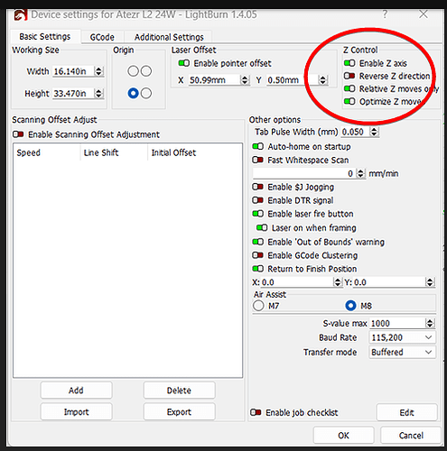

Not sure what is happening, but I have had issues with error 24.
research says it might be a communication error, so I changed out to a different USB cord. as soon as I hit frame, it says error 24. I went to a file that I used successfully the day before, and it gave me the same error.
Rebooted the laser and computer, decided to start fresh and draw a rectangle and tried to frame, still got the error 24. I am using the GRBL language.
More research suggested possibly eliminating the USB cord. I saved the file to a USB stick, and loaded it. It did frame, but showed an unknown error when I tried to run the file. (Atezer L2 24W).
attached is a file that worked before, but now doesn’t. gives me the error 24.
any help would be appreciated.
g code file that worked before.gc (413.7 KB)

Something changed on your Device settings (profile of the machine)
and now the error / missing configuration is being embeded on the code
Which is why even exporting and running offline errors too?
A image of Edit > device settings should clarify
Here are the device settings.
Also, you asked for the exact error. See below.
Couple diagnostics things you could do
In no particular order
disable temporarily the Z axis settings here
check again if you get alarm 2
Also Laser panel - start from
Make sure you are in absolute coordinates
Lastly, i see you have extended lenght
And i see you configured it on Edit > device settings
But did you tell firmware too by changing the
$131 setting?

weird steps per mm.
are you sure these are the defaults?
i never actively changed them
Try
$RST=*
press enter
Then recheck $$?
maybe you ran a step callibration ?
how do i go back to default?
$RST=*
[MSG:Restoring defaults]
ok
Grbl 1.1h [‘$’ for help]

that looks more like it!
retry something simple as a simply silly 1% power square at the center in absolute coordenates
also did you check the Z uncheck?
