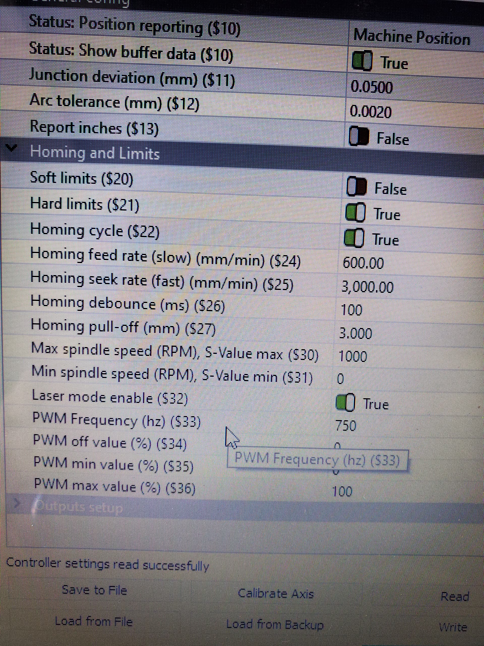

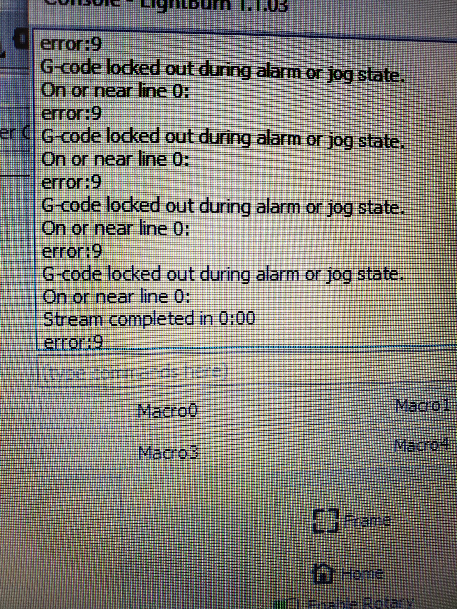

Machine was working fine with rotary then gradually started getting Gcode locked out during alarm or jog state. Now it won’t do anything. When trying to disable homing cycle it automatically turns itself back on.

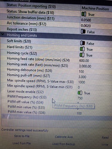

Post a screenshot of the whole screen… It’s easy to inadvertently leave Rotary mode engaged.
Rotary was enabled. I was in the process of doing cups with the rotary when this started happening. I id find a code $RST=* that will unlock it temporarily and go back to Error code 9
Turn the homing cycle $22 off when you’re using the rotary.
The engraver will hunt for home and there won’t be a switch in the rotary to inform it.
In the Console window type $22=0 if you’re still working with the Rotary.
