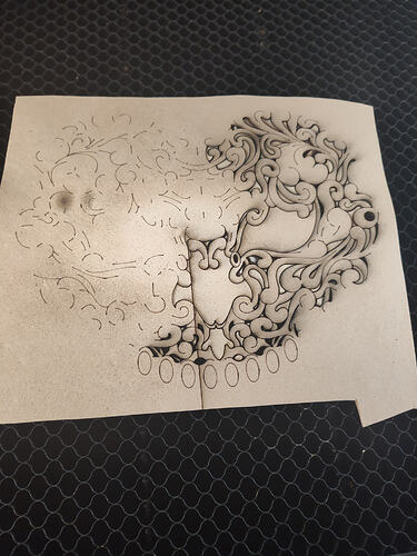

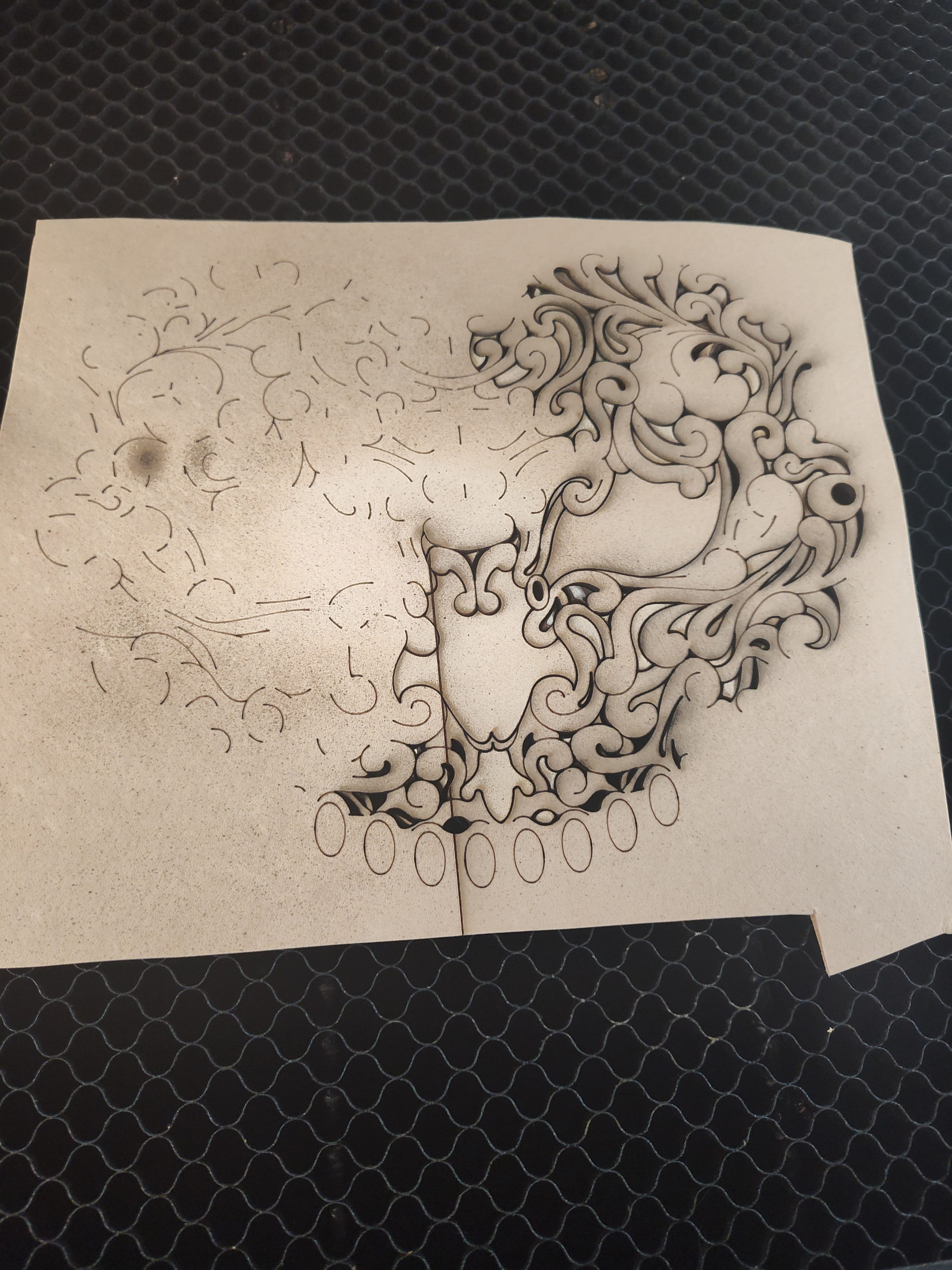

Using an Atomstack Kraft 20w Diode laser, most of the time it runs fine but sometimes in the middle of a project my laser will put a line through my project and stop in place with fans still running.
The door open error is from opening the lid after the laser has stopped, typically my laser will pause when open and resume when closed but not in this case.

This is almost certainly a USB communication problem.

Assuming that is a direct copy-n-paste, you have just seen a USB communication glitch in action:
[echo: 198.34G1X221.997Y196.814]
There should be an axis letter (probably a Y) preceding the 198.34, but it (and probably a newline and a big chunk of the previous command) was chopped out of the bitstream.
Unfortunately, this now becomes an Easter Egg hunt.

Tried elevating the power supply for good ventilation, with a fan blowing on it. Even plugged it directly into an outlet instead of a power strip. Now I’ve got this grouping of errors:
[echo: 256.5Y98.075]
error: Expected GCodecommand letter
On or near line 111472:
[echo: 221]
On or near line 111478:
[echo: G1XG1X258.613Y97.98]
error: Bad GCode number format
Job halted

Successive errors show parts of the G-Code commands sent to the controller are missing, which means intermittent problems in the same job. Because you’ve tried several (presumably) better cables, suspicion now falls on the controller end of the link.
As @MikeyH notes, the power supply can often pose a problem. In this case, however, the controller is not completely restarting in the middle of the job, so the problem is likely elsewhere.

I may have found a possible solution, and if so some further complications.
I noticed sometimes when stopping a project I would receive this error message:
Your Grbl may not support Variable Power mode (M4)
If your laser does not turn off between cuts,
switch to the GRBL-M3 device
My laser does turn off between cuts, but I tried disabling “constant power mode” in my layers and I have now successfully completed 3 runs of this project without any errors or stopping.
My new issue is I am cutting primarily leather, and without constant power mode the corners of my design are often hanging on by some fibers, rather than falling right out, making clean up much more time consuming on intricate projects. Is there a way around this? I don’t see GRBL-M3 as a device option.
If it works, it’s all good, but it does not explain the missing chunks of G-Code.
The controller ramps the power down at the corners to avoid overburning the cuts, but that can sometimes reduce the power below what’s needed to get all the way through. For a GRBL controller, the solution generally requires increasing the layer’s power level or decreasing the layer’s speed.
