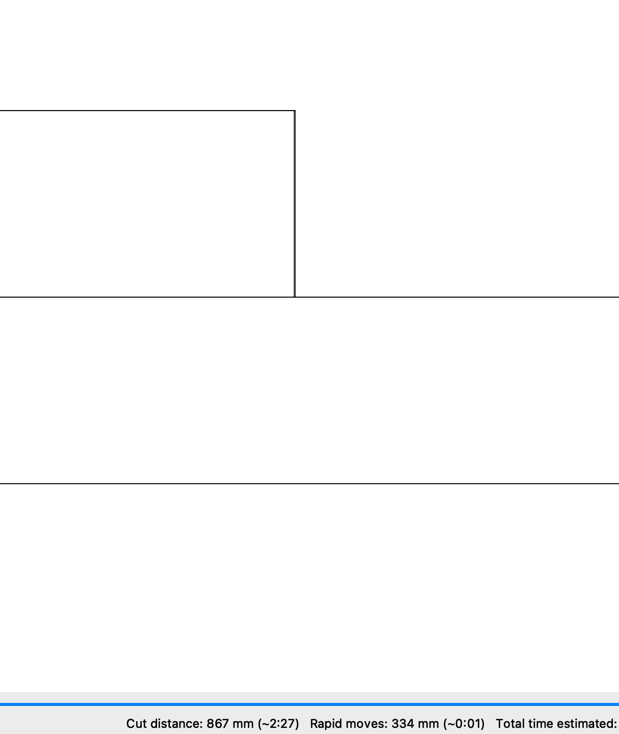

having issues with some designs bought on Etsy. It’s a set of houses and the cuts are very loose. I read thru some threads and watched some videos about kerf but I might still need some help. I attached a lbrn file for reference, my cut layer has the kerf offset set to 0.
I tried some kerf tests following Rich from lahobbyguy and measured my kerf at around 0.100mm. But if I now would set the cut layer with that kerf I assume the parts would be even more loose as they are now. Am I right? Should I inward the kerf or what? Thanks for any help.

Okay. I think there may be a couple of things going on:
  1. As you suspected, kerf is a likely factor in this.
  2. The parts themselves have gaps in the design. Check out this example where the tab doesn’t quite line up with the slot. This doesn’t seem significant but when you’re chasing a very specific fit these things can add up.
Kerf works in two directions. For outside cuts you want to cut larger as to account for kerf. For inside cuts you want to cut smaller. If you express the kerf as a positive value it will generally do the right thing, even for inside cuts.
Note that the value you use for kerf adjustment should be half of your measured kerf. So if your confirmed kerf is .1 mm, your adjustment would be .05mm.
For your current issue, I’d suggest you modify the design to perfectly size all the components as if kerf is not accounted for. Then use kerf adjustment to manage fit.

Can you make a file with the connection that doesn’t fit? On the last file you sent, the measurements and fit are correct, see picture.

thank you for your answer. Maybe I just don’t get it. Please take a look at my attachements. These are two parts, which sholuld fit together. I separated it into two layers so it’s easier to see the details. The green one has the opening and the red one has the finger of the joint. If I center align them and zoom way in, the green line is longer, so the finger is longer as the width of the groove. Sorry for my bad spelling, hope you understand.

When I use your 2 parts (from your file) there is no overlap, not even at maximum magnification.
As I see it, you have received/purchased a file for 3mm material - without kerf compensation.
