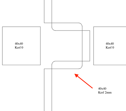

I’m a bit confused, either I haven’t understood how kerf compensation works or I don’t understand what I’m reading.

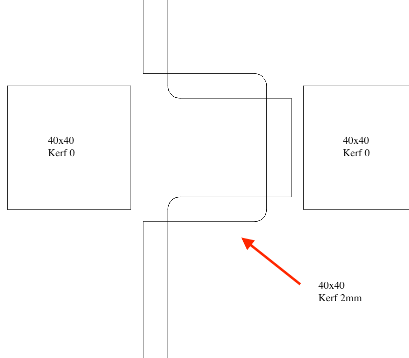

In this example there is a connection of two elements with (very large :wink: ) kerf. Picture is from the preview window and if I cut it out of cardboard - this is also what I get.
Picture 2 is without kerf

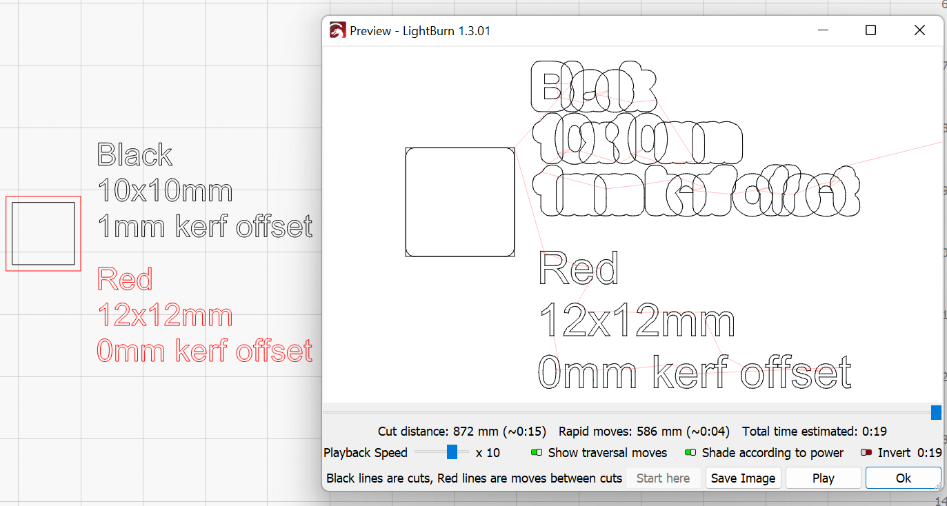

I believe this is incorrect. The kerf adjustment as input is precisely how much the offset is applied. Since you only need to account for half the width of the kerf you need to input a value of kerf divided by 2. If you enter the full value of the kerf you will be overcompensating.

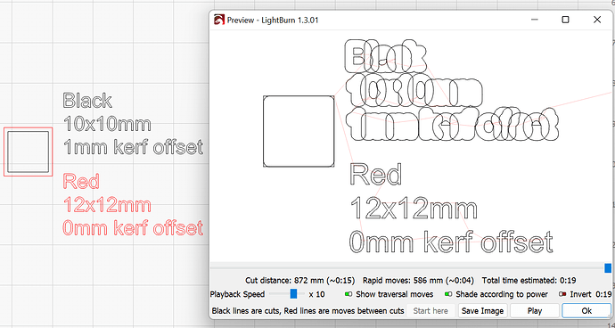

Check out this setup. Black has 1mm kerf offset configured. Red has no kerf. Note how in preview that the two objects overlap.
Hi yeah seems I misinterpreted the dialogue box - to be honest I think there should be an option to put in the laser’s full kerf width and let Lightburn do the offset calculation instead having to make the user do the extra legwork of dividing by 2. Somehow I got stuck into my head for some reason that the kerf offset was the actual kerf width.
