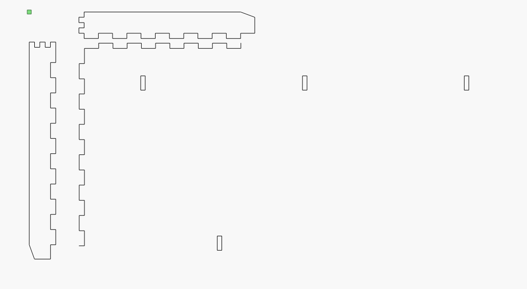

The problem with kerf really shows up when you do something like a box. If the kerf is good from base/top to side, then where the both sides meet they have the same kerf… I’ve found it better to split the kerf equally under these conditions…
There are other issue on how Lightburn has implemented this.
I have a ‘cover’ for my stereo that is simply a piece of flat mdf… each corner has two short sides to keep the cats from sliding it off the top of the stereo…
It’s too large to get into the machine, so I have to do each corner separately…
This is a corner and the rectangular slots are ‘feet’ or standoffs to allow air movement out the top of the stereo. You can’t apply a kerf to the open segment or line that is the edge of the cover…
Another problem is if you don’t have the same kerf on top and sides, where the sides meet each other, they won’t fit…
In LB I probably done my “fix” all wrong but…
I used the Edit Nodes to set exactly where I wanted to change the dimensions of tabs then applied the value/values.
Time consuming but it works for me.
