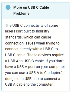

Many, if not all lasers with a USB-C connection won’t connect with a USB-C to C cable.
We have this documented here:
USB C Cable Problems
Here’s a more detailed ZDNET article
Why some gadgets don't charge with USB-C
Although the printer may have a USB-C port, it lacks the necessary hardware to support USB-C charging protocols. On a more technical level, the manufacturer opted to save a few cents by omitting some basic components (typically just two resistors, which cost virtually nothing) to accommodate different power inputs. Since USB-C doesn’t supply power without first negotiating what the device needs, no power is delivered.
By contrast, USB-A always delivers a default 5V without any negotiation.
