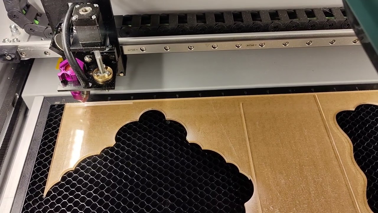

There is a bug in the latest versions of LightBurn. Version 1.4.01 is stable, and does not appear to have the bug.
A lot of users of the OMTech Polar have reported LightBurn crashing after or during almost every job run. Users of other lasers have reported similar issues.
When running 1.4.03, I could not laser anything near the top edge of the work area. This would cause a red ring error (most likely Y axis limit error, as others have shown that with the panel). I don’t believe the Y axis is the only issue, but it’s worth checking.
After downgrading to 1.4.01, I have not had any crashes at all. I’ve run detailed jobs for over an hour without error. I also tested by putting both Fill and Line boxes at the Y axis limit (very top edge) of the work area. Those completed with no error. Previously, if I was within 5mm of the edge, it would cause an error.

Here’s a weird error/behavior that happened yesterday in 1.4.03:
I was able to recreate it in 1.4.01 as well, and it causes issues consistently, though the behavior isn’t consistent. The Polar halts when it gets near the top (assumed Y axis error, still haven’t installed my panel yet). I can press the start/stop button on the Polar to continue, and that’s what happens after the delay in the video linked above. However, today I crashed it twice using a new file with a simple rectangle. The first time, it was much like the video. The second time, it was wackier, and went to the right instead of the left, and I pressed the Start button (again, on the Polar) was required multiple times for continued odd behavior.
Power cycling the laser prevented LightBurn from crashing the second time.
Rectangle Crash Test.lbrn2 (3.0 KB)
Power is set to zero on the file, only the movement is required for this specific bug. It does appear likely to be two separate issues.

With the panel installed, I ran the rectangle crash test file, and the panel said:
hard Limit Prot
Please ESC
I pressed ESC and it homed as normal. LightBurn didn’t crash. I ran the rectangle test a bunch more times with 1.4.03, and it didn’t crash at all. The panel beeped with the error, and I could press Stop in LightBurn, or ESC from the Panel and it didn’t freak out or crash. If I press the stop/start button on the Polar, it did get goofy. I don’t know if the panel has any affect here. I reinstalled 1.4.01 and the file that was crashing it every time no longer crashes it at all with the panel installed. :person_shrugging:
I also screwed around with the rectangle positioning. Within 3mm from the top, it sends the hard limit warning. 4mm or farther away, no issue.
To answer your other question, the Enter key on the panel responds the same as hitting the ESC key. I thought the Start-pause button on the panel might do the same thing as the Start/Stop button on the Polar, but it did nothing at all instead.
I installed the beta 1.4.04 to try it out and behavior is similar now with the panel installed. However, I tried other keys and pressing Pause inside LightBurn after it halts is similar behavior to pressing the start/stop button on the Polar.
I’ll try some more complex stuff again and see if I can get it to crash.
