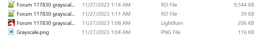

Just to check something, I grabbed a Grayscale image of a camera out of our docs here: Image Mode - LightBurn Software Documentation
It’s showing in Windows Explorer as 116 KB.
Then I saved the LightBurn (lbrn2) file.
It’s showing as 206 KB
Saving it as an RD file makes the file 39 KB (ahh… it was set for passthrough)
Setting the Image for Stucki made the .rd file 9.5MB.
@KungFuJosh
If you’d like to know how much space the file might take on the controller you can load it as you had it in LightBurn and click File, then click Save RD file and check out the difference in file size. :slight_smile:
