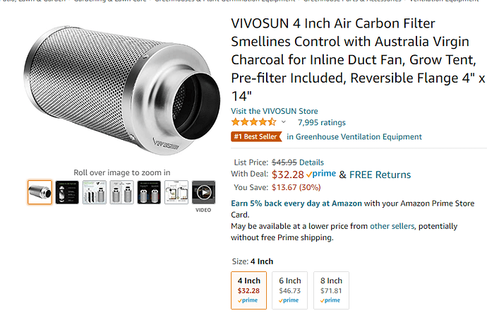

Willie, your filter looks interesting, I hope for you it works. But when working in an apartment, I think it will be a good idea to also minimize the noise as much as possible. Does it make sense to put your fan in the filter box?
Going back through some of my things that I looked at during my search for an extraction unit is one person needed to replace the expensive filter too often. The solution was a home ac filter that he put in before the expensive filters to catch the ‘large’ stuff that plugs his more ‘expensive’ filter.
They claim extended life over 6 months, instead of less than a month they were dealing with.
Notice in your ‘box’ you have room for something similar before the filter.
Just a thought…
This inline duct fan is very quiet. You can only really hear it in the early morning before most people are up. At most it kind of hums like a refrigerator. I’ve already tested it’s abilities small scale with my Diode laser to see if it would vent gas or clean air. While I don’t have a gas analyzer, my nose reports it’s just fine. We will see how it does with larger volumes of smoke and particles soon enough. I already have a larger design and enough wood to make it should the need arise. And if needed I can add another inline duct fan or get a more powerful one. But it’s a very short run and most likely won’t need it. As long as there is negative pressure inside the machine and filter box then I’m not worried at all. I have a valve inline to prevent air from backflowing gas into the living area.
I do have room for that, however the white thing you see is a filter sleeve for the larger particles. The filter itself is a common Charcoal filter that most marijuana setups utilize. I can force the air in and through, or draw it in. I left room for another filter in case I decided to change the way it operates.
I’ll see if it needs more than a shake out here and there. I was also thinking of adding a dryer dust trap to catch larger particles. The possibilities are endless really.
Since HEPA fans are so common, there are all in one filter solutions for $20 -$30 that do it all, I’d just need to modify small bits to make it work.
Overall the output is very high, but we will see how it works with the laser. The machine has lots of places for vapors to exit so I am thinking I might seal up the worst offenders with weather stripping to help prevent exhaust gases from leaking out. I have a brand new Carbon Monoxide detector nearby as well. It will be watched closely.
Thank you both for the recommendations though.
I’d recommend to ‘suck’ through the filters. Keep the junk off the $100+ fan assembly :slight_smile:
I have had to clean my fan off already.
My inline duct fan was not that expensive, but it does indeed “suck” through the filter first. I can reverse direction without it going into the fan first no problem and the white particulate filter can be put inside the canister.
And incase anyone is interested in the Carbon Filter itself. If my Uncle inlaws setup is any indicator of how few odors will escape, then I’m pretty set. He has a grow operation and a few of these and you cannot smell anything unless you open the doors.
