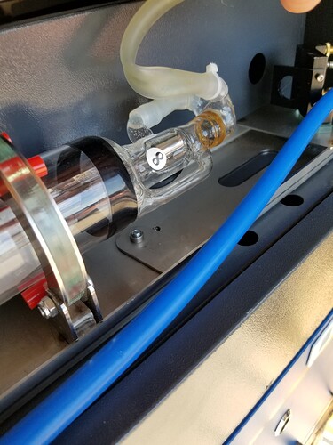

When ordering a laser alignment device, don’t just take American Photonics word for it. Most Chinese lasers do not have a removeable tube. I was busy, didn’t try to dissemble the head and took their directions. My Chinese 60 watt Red and Black has a compression twist fitting that holds the lens and THATS the tool I wanted. I thought they might take that into account but no. Check the INTERIOR of the head tube. I debated before I purchased. It’s costing me a couple of weeks.

I’ve followed the videos and I always just get ballpark. This is the closest I’ve gotten and it was way faster than manual everything. Might need to replace the current tube holder with an adjustable one to help with alignment. Since I’ll eventually be getting an RDWorks lightweight head I figure I’ll get quite a bit of use out of it. If I had a 3D printer I’d have just created my own to fit inside the tube.
When you’ve done it 50 times, you may think differently.
You have a nice laser, use it to make your part. Might have to think of a different angle for it… Most of Russ’ stuff development is lased out of acrylic. The spacers in my ‘Russ tube mount’ are lased out of acrylic. My tube is only 50mm.
And YES there is a ‘kink’ in the coolant tube. I’ve changed it out for a 180.

Good news, the correct alignment tool arrived, cannot say enough about American Photonics customer service. I was able to align the laser (or have I?) and would not have been able to do it without the tool.

The head bracket itself is bent from initial power up (see other thread) I bought a new level and square that could fit in the machine and verified it along with the alignment tool. ID 10 T error on initial power up.
I had heard the batteries didn’t last long, maybe 20 minutes or so, but was shocked that they crap out after about 10.minutes. Very handy tool, terrible battery life. When it has fresh batteries you can align in just a minute or two if the head bracket isn’t bent like in my case. There’s a niche market out there for someone to make these that last longer, especially at $40 a pop. Once this things up and running I’ll likely make my own or maybe hit a maker space and 3d print one. Once I have the bracket I need (maybe I’ll replace the whole head anyhow) I’ll make a quick video so people can see how it works. Battery life is the only real complaint.

I don’t have a ton of tools, my square was a speed square for carpentry so it doesn’t really work, and my level is very long so I couldn’t square it unless I bought new tools. It looked like it was square but when trying to align with the tape method I could never get it to work. The tool shows a bright red dot and as you move the head the dot would move form 3rd mirror to 2nd mirror. This means the head has a tilt of a few degrees, confirmed with new (small) level and square. It’s very handy.

I squared everything after milling a head bracket and it’s the tube itself it appears that’s off. I am looking to buy a new head etc. Might go with Russ RDWorks if he has time.

I ended up with a tube holder/m1 mount. It was a pretty simple install, but had to 3d print a cover for the tube that now sticks out…
Mirror 3 never aligns to mirror 2 no matter what. The rails are straight and level as is the bed and machine. Due to my ID 10 T error I am sure the tube is bent. If not I will keep on.
