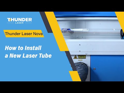

Thunder Laser publishes this video on changing CO2 lasers in their machines and the OP may find that helpful. Not the heavy-walled connector between the two high voltage wires.
