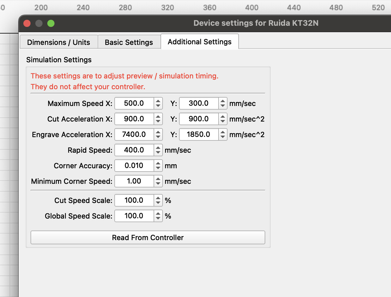

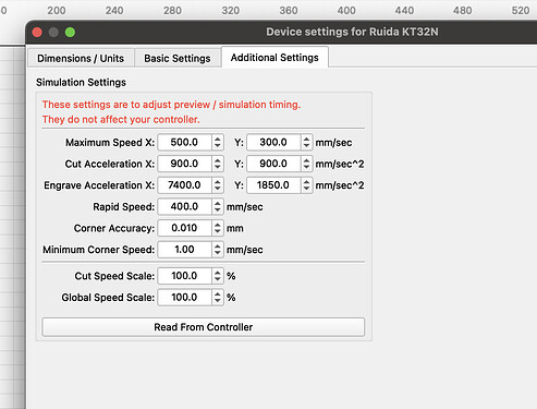

LightBurn needs information about your machine to be able to calculate the time. On DSP machines, LB retrieves this information via the function shown in the picture.
With my setup, the processing time fits reasonably well, and stays within 10%, which gave me a good indication.
The transfer of data will be a little faster and you have probably shown some extra functions online such as online change of speed/power, framing…

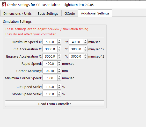

THANKS! For what it’s worth, there was a file on the micro SD card that came with the engraver.
CR-Laser Falcon.lbdev
I had imported it into lightburn.
And now I have these details for the engraver:

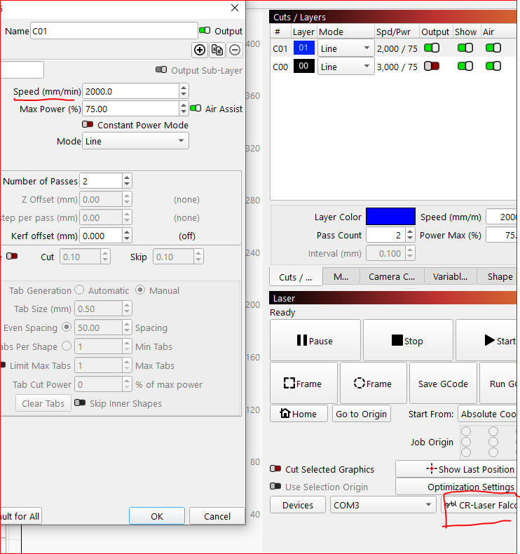

Intersting / disappointing… that image shows max speed of 400 - 500… I’ve been setting a layer to 2,000 - 3,000 - 4,000.in lightburn. And lightburn didn’t complain. Changed the 2,000 for the layer to 20,000. Yep, the total time in preview dropped. But it’s pointless - the engraver can’t go that fast.
I’d think the software would warn that the speef for that layer isn’t possible with the engraver that’s selected?
Am I doing something wrong? The device does talk about com3… but I am getting the gcode to the engraver with a micro sd card.
I know with 3d printers, you need to slice the design. and then the system will warn about errors. Am I missing a step to check layer speed vs. actual for the printer? A setting to warn / not warn if I choose a speed that’s too fast for the laser?
I have noticed error in total times shown between preview and actual, and have read from controller that is the same as shown in machine settings.
I have noticed if on a line say cutting on 2 passes or 3 the preview time is way off with the more passes set, but pretty acurate on images and one pass!
You are comparing MM/MIN to MM/SEC. One is 60 times larger.
DOH! Thanks!
