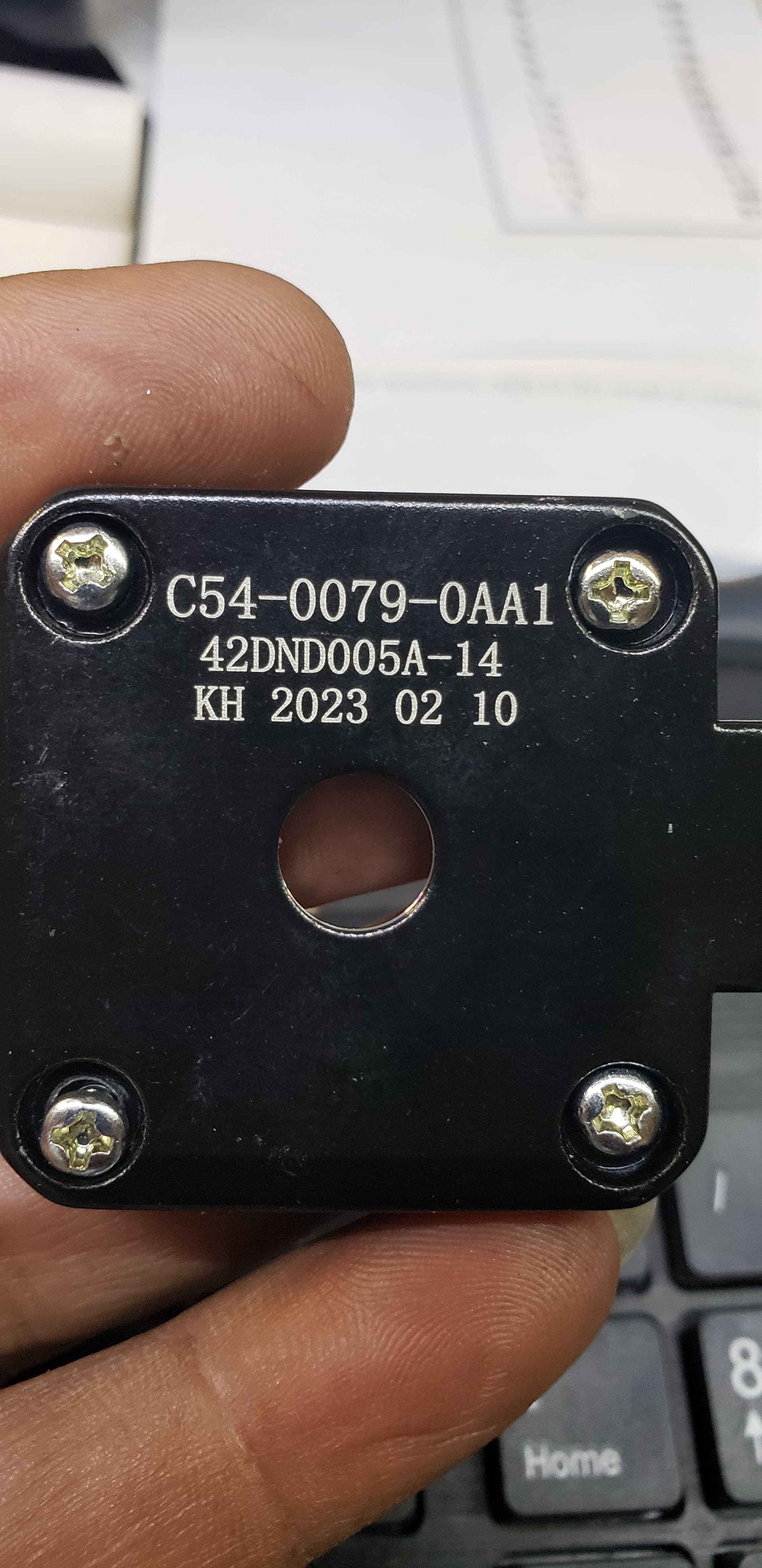

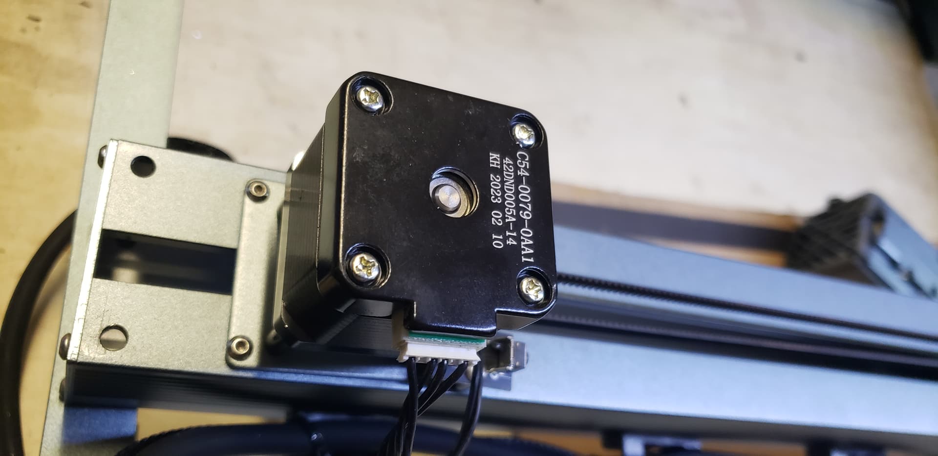

Thanks guys after few hours checking i found out that z axis stepper motor is frezed and not moving the belt i open it looks like there is plactic gear inside that is strriped and pully is not turning the belt and the beeps sound is the gear not enging so i am f… can not find the parts on line and the company dose not have any iformation on this part . love the machine but no support.
Z axis stepper with pulley? Only the L2 model has a Z axis stepper and it has an integrated lead screw.
Can you upload a picture of your machine and the problem part, please?
Thanks chirs i think my machine is gone even the laser is not firing so it could be the controller is gone as well with stepper .i can hear the buzzing on the stepper butthe gear is jamed .
Anything is possible.
That looks like your X axis.

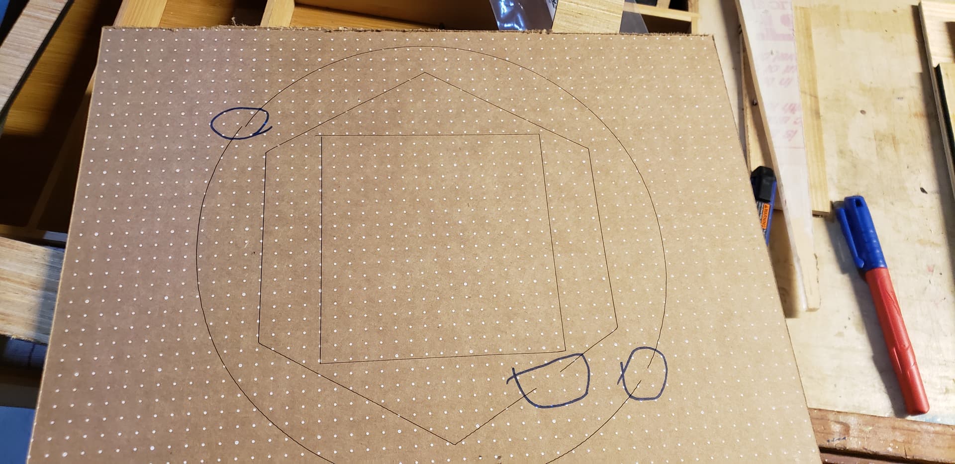

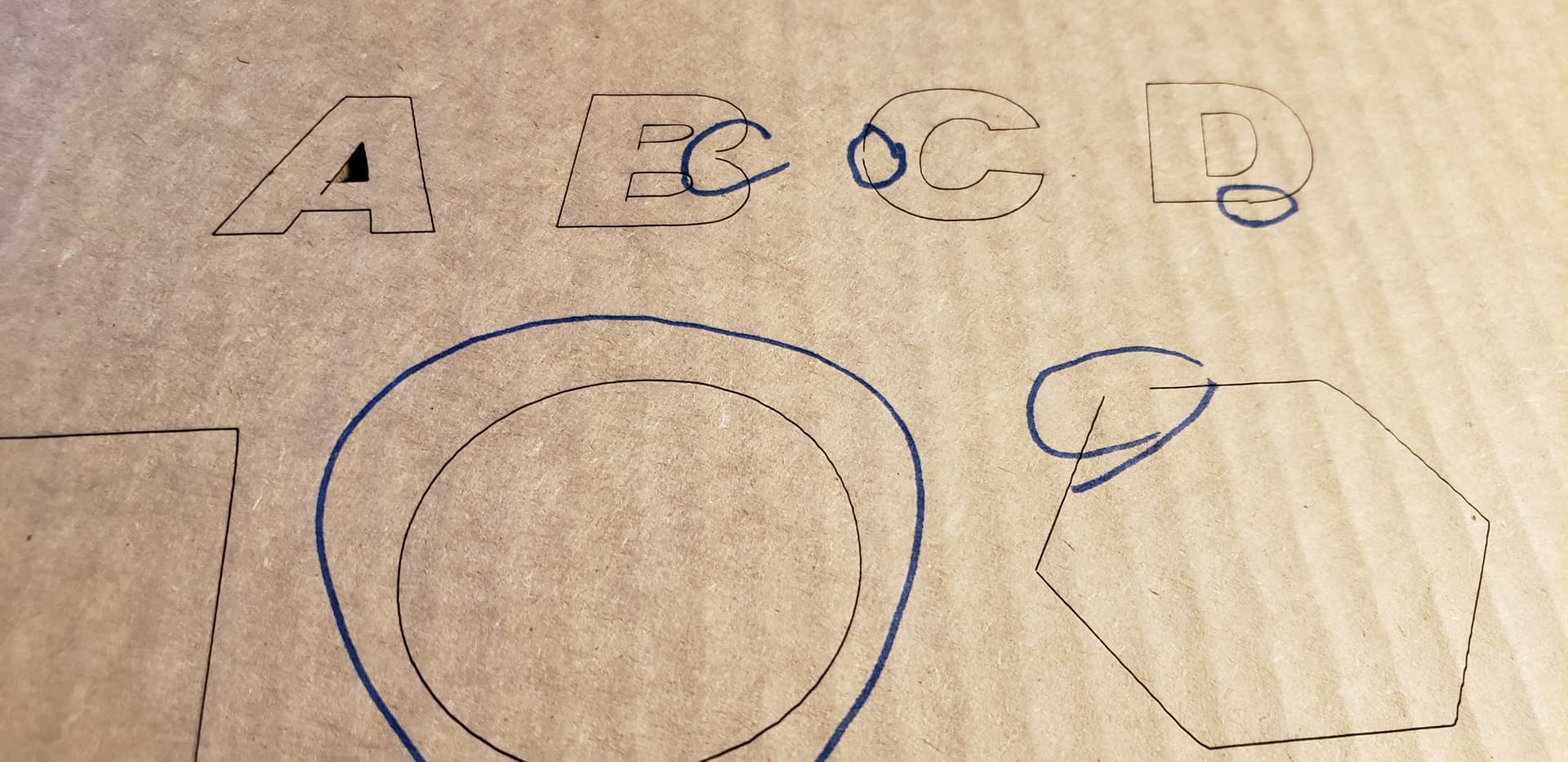

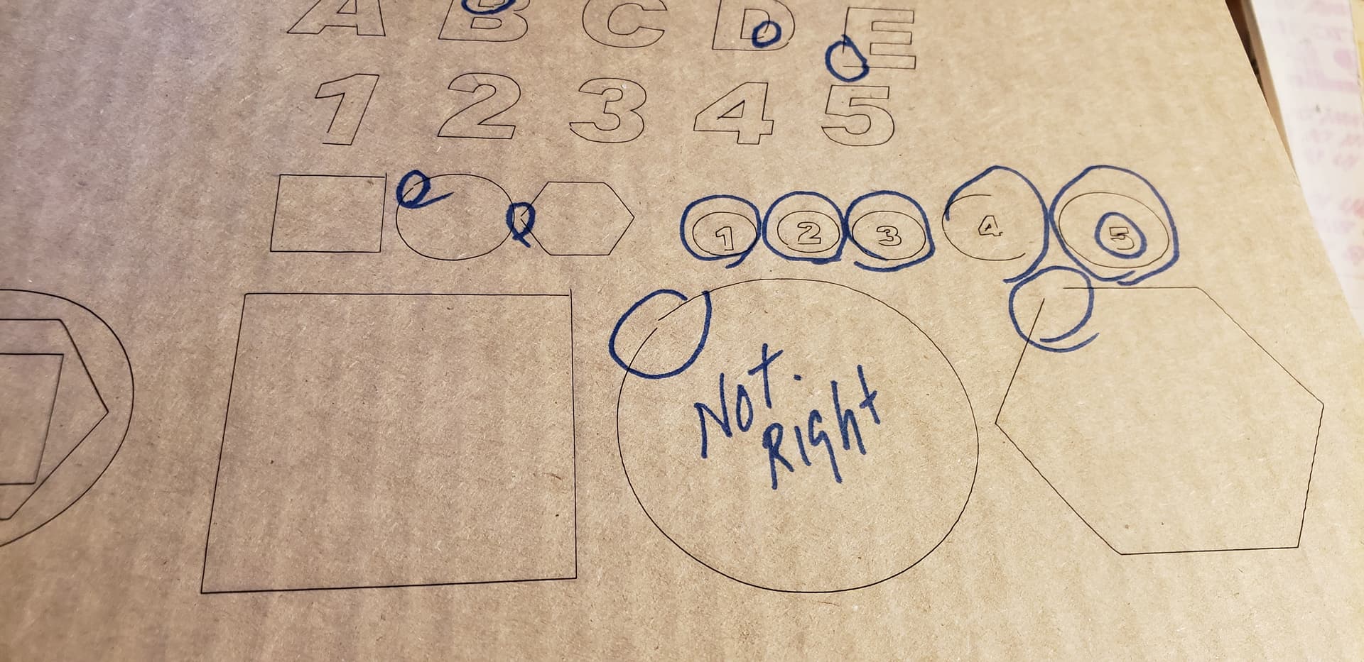

Thnaks Chris you help me alot and i got the machine running with some adjustments on rails now it runs smooth but i notic the laser cuts off some area that dose not cut thrui did some test cut which i send you to see and see what i can do for some reason the bigger scale dose better thank small and circle still is not 100% round .
Lets see if @misken has any input on this…
It seems like both X & Y are behaving erratic. I’m tempted to say it’s missing steps from things being too tight, but I have zero experience with a machine of this construction type.
The whole mechanics is still very wobbly. The open circles are just a result of the laser not returning to its starting position. The numbers also don’t look good, as far as I can see.
Check the steps per mm value again, to make the rectangle be a square / the circles round. But this has nothing to do with the backlash problem.
First, check all belts, wheels, and gears. If you touch/push the motor while not moving, does it feel stable?
Next, what speeds did you use?
