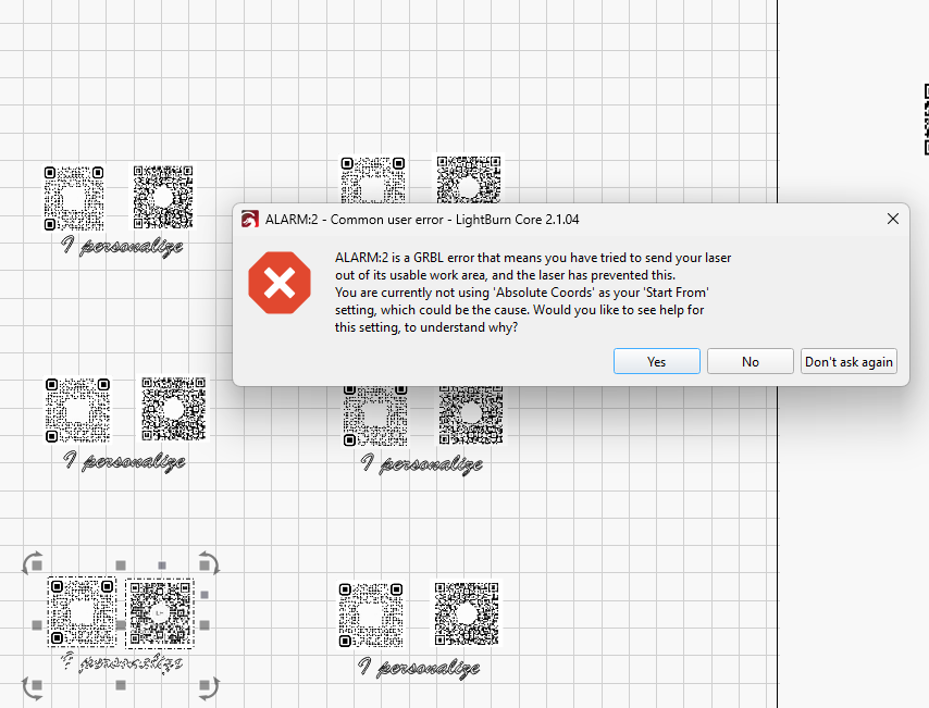

Frames correct starts 1.5 inches away from where it started the framing

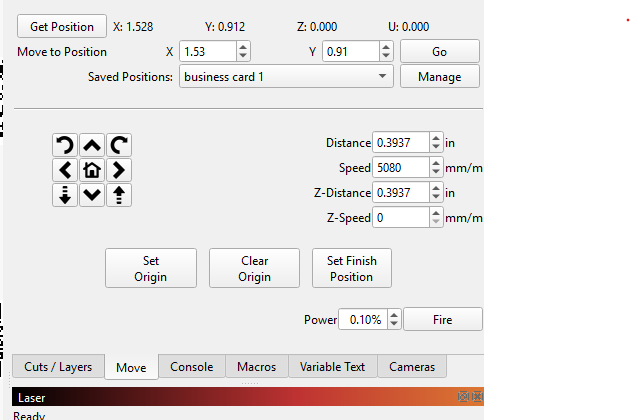

I can frame any project correctly, however when I hit start, it always starts to the right of the project it just framed, even with using any of the 3 options as to where to start. If it starts from the right, I then get a possible out of bounds when using Start here and also User Origin. I have screenshots of the Move window and also the error message when the setting was Start Here.

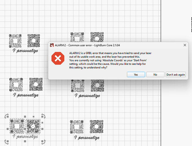

Screen capture (no cell phone pix please) your screen showing the design grid.

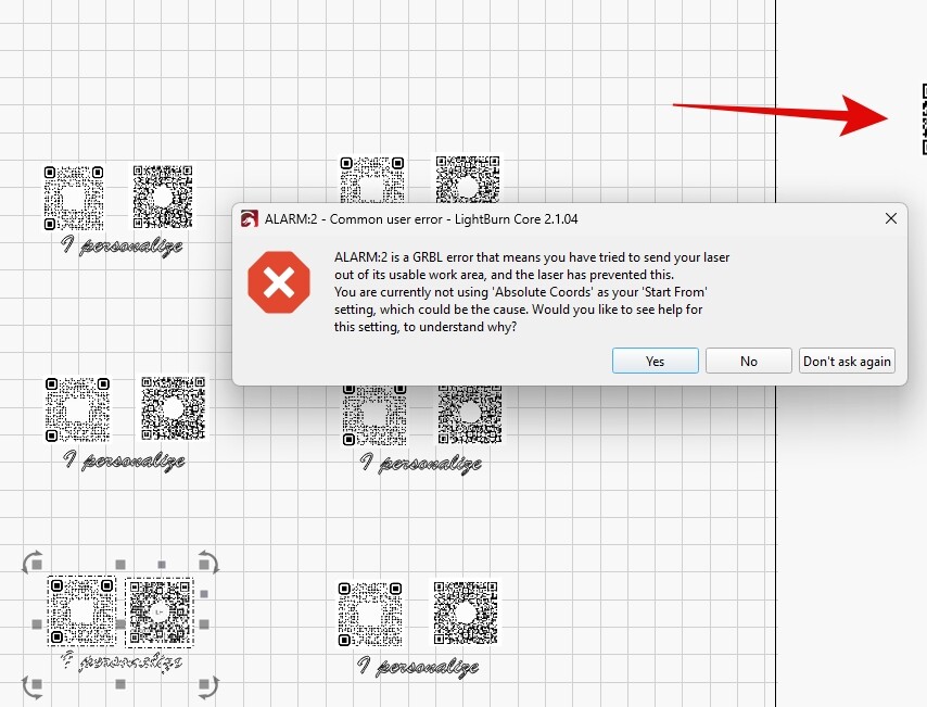

I’ve already noticed, from the previously published image, that there is at least one object outside the grid.
To what extent this might indicate other objects influencing it, I don’t know. More information is needed.

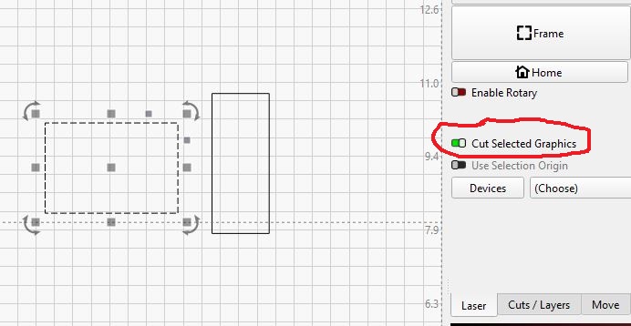

Is this turned on?
It does not matter if that is turned on or not. It does it anyway. Yes the image shows a selection, but again the problem occurs whether Cut Selected Graphics is selected or not. Logical question though. Thanks
This is another page or group that is part of the file. It is totally off the desktop and those never affect the engraving or cutting

Ok thats good. I’m not sure what else would cause a framing and output mismatch? The ‘current position’ mode is the one it sounds like you are using usually? Pay attention the the position of the small green dot which indicates the job origin - I could not see it in your screenshot? and as @Kuth and @MikeyH have been saying its important to know where that is. Enabling both “Cut Selected Graphics” and “Use selection origin” works well with the current position mode.
