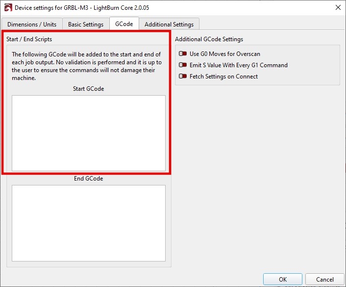

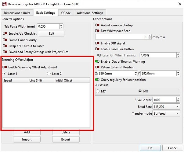

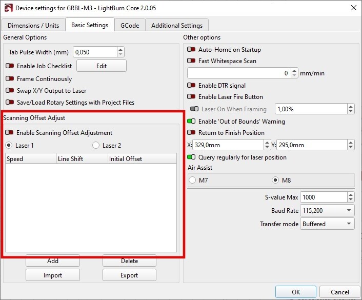

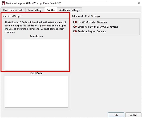

Are there any definitions entered in these fields?
Something it will be. :innocent:
Good question! If the device is changed, it could be populated for one and not the other.
I have no idea what definitions are, so I am going to say no to the question
I just saw the images above. No, I have no definitions added. I have no clue as to how to use that section of hte software.

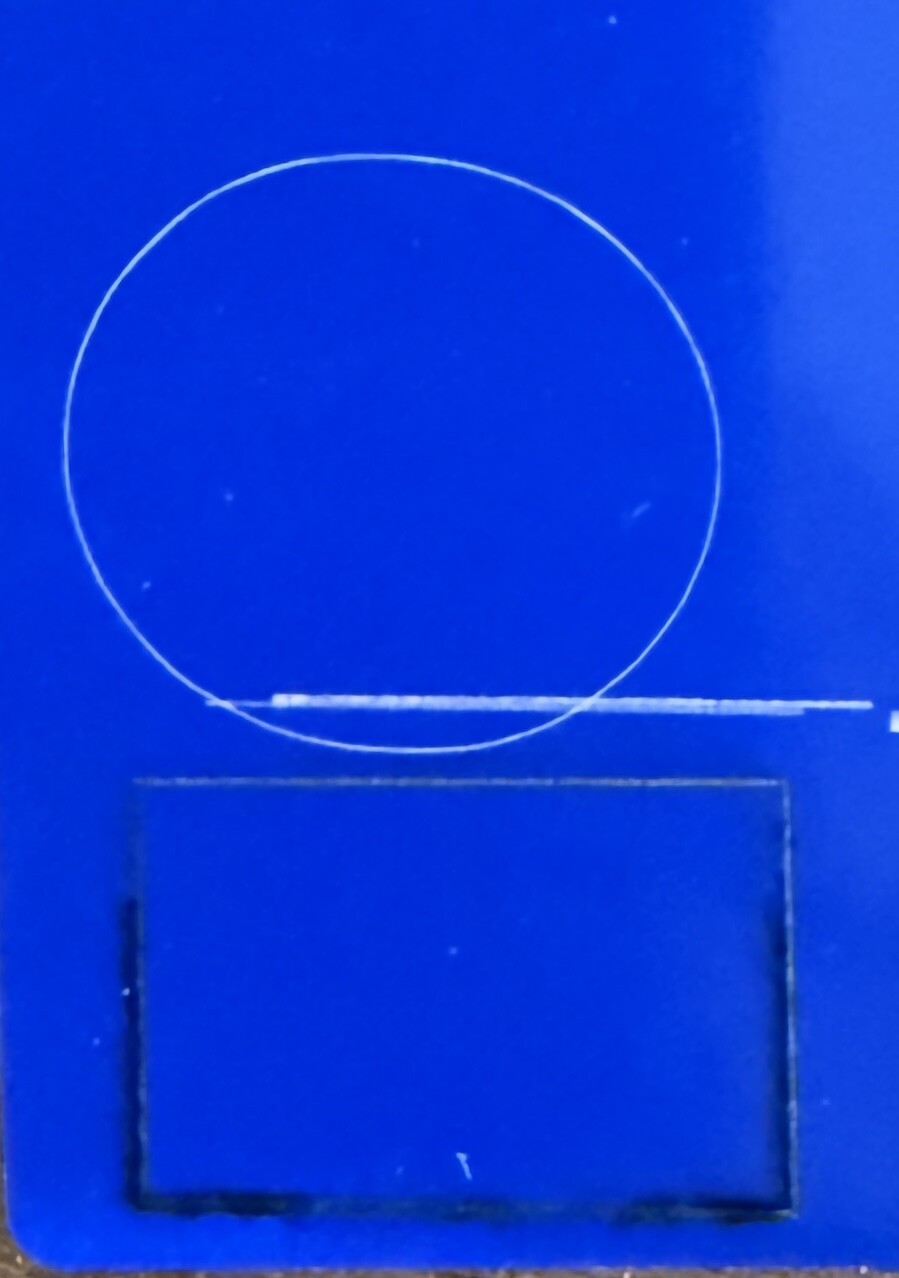

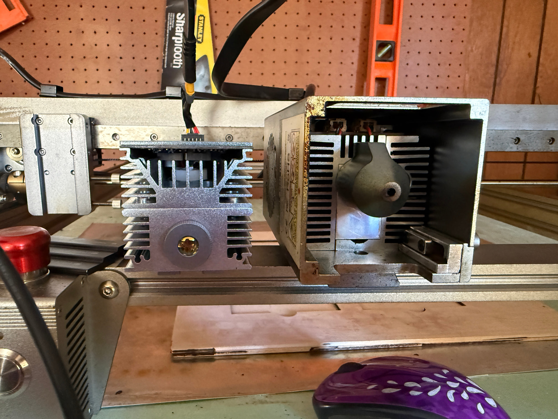

I used an aluminium card to do both on the “test” you suggested. The laser is in a different place on both modules as seen in the image attached. I also took a video at the request of Laser Tree that I will try to post as well
If you don’t know or aren’t sure, you say you don’t know. By stating “no,” it’s assumed that there is effectively no information there. :wink:
This means that there are no G-code entries to be added to commands through these definitions. I’ve never used them either, but I understand they are for making specific adjustments for a machine. :+1:
Which laser drew the circle and which drew the square?
At the beginning you mentioned that the deviation was to one side or the other.
In the image I see one drawing on top and another below. Was it exactly how it was engraved or is the image you posted rotated?

To add to what @Kuth asked, are both of those modules sitting on the mounting plates?
The Home position will not move because it is fixed by the limit switches. So there is an offset between the diode and I.R. 0,0 point. This means one module has to get an offset compared to the other. Did a little research and found an offset that works within, or on top of, the standard G54 (and G10 L1) default setting.
We can set up a G52 Macro for the second module. If that does not work, then G10 L2 will take care of it.
No worry, we will help and explain everything. What we need to know is how much X & Y it is.

The circle was the IR and the square the diode
The Circle was done by the IR and the square the diode
They are both on top of each other made to be layers, not the circle above the square but basically the circle inside the square. The circle was the IR, and the square was the diode. Oddly, the engraving of the IR did not move to the right on this particular job.

You are not confused. The I.R. is the addon, so it is the culprit.
Two very important questions:
  1. Are both of those modules sitting on the side that mounts to the Xaxis trolley?
  2. Is the top or bottom of the circle-square the side facing the front of the machine closest to the Home position)?
Click on the “I.R. Module” macro button and it will offset the 0,0 to compensate for the different size of the I.R. module.
Click on the “Diode Module” button and it will reset everything back to normal for the diode module.
Nothing else will be needed to do, to switch back and forth between the modules. I use Macro button to change settings when I switch to my rotary and back. Works like a charm. Of course, we must figure out what is needed for the switch. But once it is done, it is done.
