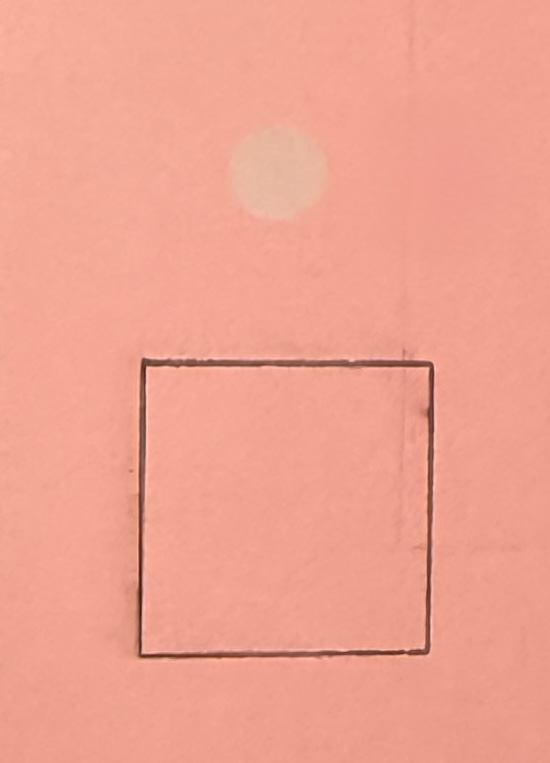

The modules were sitting on the mount side, yes.The square is closest to home and was done by the diode. The circle was supposed to be inside the square, and was done by the IR. The aluminium card was not moved. The card is long side left to right.

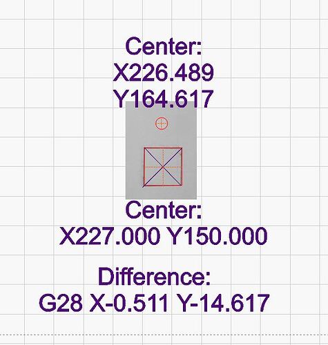

We have no information on the size or coordinates, so I have prepared a test file to help with that.
  1. Load the file, mount the I.R module, and home the machine.
  2. Burn a spot on your test material, preferably a light colored wood scrap. You can use the Fire button in the Move window for this.
  3. Without moving the test target, install the diode module and re-Home the machine.
  4. With the diode, burn the square. You should now have a square with a dot somewhere close by.
  5. Take a picture of the test burn and add it to your Reply
By knowing the size and location of the square, I should be able to get pretty close to the offset needed for running the I.R. module.

I attempted to do your file with wood. The IR module will not burn wood no matter how I tried to get it to work. What I wound up doing was using a light colored business card since both modules will show up on the aluminiumI resized the square to a half inch and place a circle in the middle for the laser. I had the diode line the square and the IR to fill the circle.

I thought I had it computed until I read this. I need your .lbrn2 file so I can get the actual square and circle locations from that. You say a circle for the I.R., but all I see is a big dot.

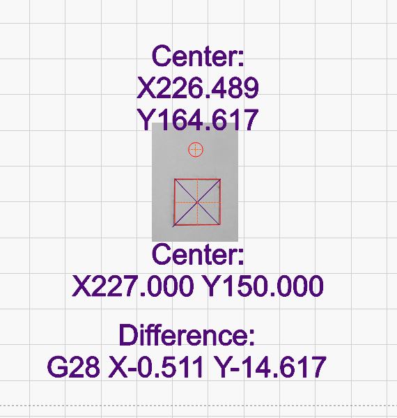

Cancel this. I think I have it.
  1. I.R module mounted, Home the machine.
  2. In the Console window, enter G28 X-.511 Y-14.617
  3. Run a test with the I.R.
  4. Let me know if it burns where it is supposed to.
Then we go from there.
Edit: I may have the signs backwards. You said earlier the I.R. was giving the out of bounds message?
That was only when using either User Origin or Start Here. Otherwise it work…well sort of.
