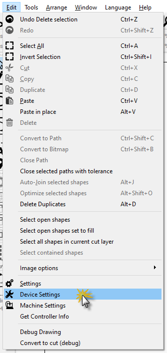

Maybe another option would be to use a parallel red dot pointer on the lens holder mount. It may work out that you could offset the parallel laser pointer the same as the actual x / y offset you needed to set. But if not, LightBurn does have Red Dot Pointer Offset adjustment as well.
OR, you could just use the red dot pointer offset configuration without actually having a red dot pointer installed to manipulate the framing result to adjust for your offset :slight_smile:
Laser Offset
If your laser has a red-dot pointer that is not aligned with your beam, you can enable the Laser Offset value to compensate for this when framing and positioning.
