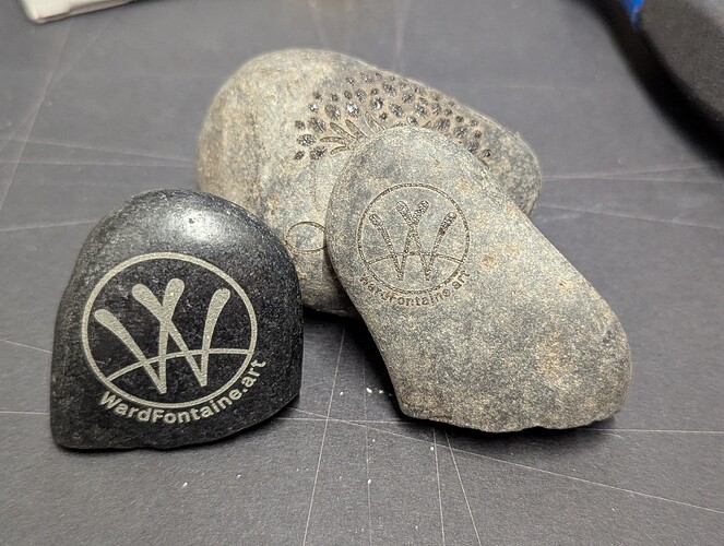

I got some random rocks from Amazon (for painting, according to the listing). Most of them have not taken lasering too well on the fiber laser. The settings I use for slate or the black landscaping rocks haven’t really done well. The BREC Outdoor Adventure test rock in the second image is a typical example – it’s kind of “foamed up” in the engraved areas.
So, naturally, I took one of the reddish ones and tried a full-parameter-space search. (It would’ve been really convenient to have logarithmic steps in the Material Test, so I’ve got a thread on that now, heh.)
Anyway, with very low speeds, I can turn it into dark obsidian-like bubbly glass, and with higher speeds and other parameters, I can get various shades of brightening. Anything with too much heating turns flaky with little bits popping off (and you can see in the center of the first rock how the entire surface near the black glassy spots completely peeled off in one big flake). I can get a decently bright result by staying just under the flaky limit (using all four parameters on my MOPA fiber), and the inclusions tend to go black.
The Ward Fontaine rock was done with my best-seeming parameters for that particular type of reddish salami rock. I hit it with the settings, then tried a couple more times, checking between each run. Didn’t really change the brightness, and didn’t have any notable ablation/engraving, so once through is likely the ticket for this particular rock. It’d probably be a nice rock for clipart-type graphics with moderate to low detail, but definitely not the best for text or fine detail.

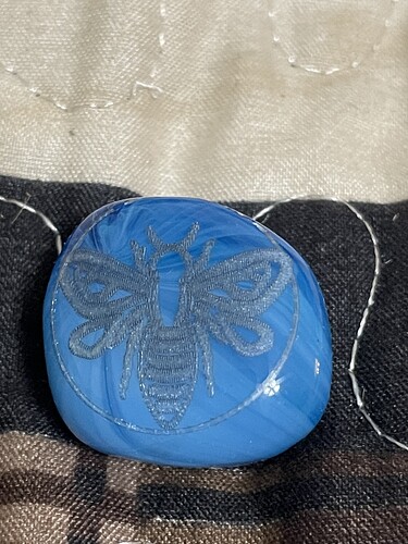

I finally received the engraver spray yesterday. I engraved a polished blue stone. I probably could have raised the power up a little. With a 22 watt diode laser I had it set to 4000/90.

If I remember right, we ran at 1500mm/m and 100% on a D1-Pro 20w

Fantastic effect! That looks like it was done on glass instead of a rock. I am impressed!

Well, that’s quite a bit different… I picked up another bag of rocks, and the difference was significant
The dark rock with the light engraving is from a bag of Wonderland-branded “Bali Black beach pebbles” from my local Lowe’s, using the same engrave settings as I was using for the other black rocks.
The light rocks with the slightly darkened and vitrified engraving are from a bag of Vigoro-branded “Mexican beach pebbles” from my local Home Depot.
The natural-finish “Mexican” rocks take engraving very well, but it doesn’t really change the color. I have the second-run settings for them that makes the vitrified texture on the surface. The polished “Bali Black” rocks have good contrast from just the engraving (it’s really “medium-dark grey on black” in person), but when I tried the surface-melting settings from the other rocks, they just looked ugly-burned.
One of the rocks I pulled from the bag of Bali Black beach pebbles, on the other hand, was speckled and quite obviously not the same type of rock as the rest. I tried hitting it with the same settings, and it seemed to ablate away much more easily and to a significantly lighter surface. It seems to be an outlier, but it was a nice surprise, even if I wouldn’t count on having any more.

I may have spoken too soon on the surfacing. I took another, engraved the face, and then tried my standard surfacing settings. Worked like a charm, go figure.
The rock on the left is the polished “Bali Black” from Lowe’s, and the rock on the right is the “Mexican” from Home Depot.
According to the Bali Black beach pebbles product page (how’s that for a little alliteration?) at Lowe’s, it’s “Grade 1, first-quality polished quartz river rock”. The Mexican beach pebbles product page at Home Depot does not specify what type of rock it may be.
I wonder what the HD Mexican rock would look like if you polished it, but I’m certainly not going to add that to my hobbies at the moment. I’m starting to think I might want to add a mineral identification book to my library, on the other hand. :sweat_smile:
So… you engraved an area and it became white. Then you engraved in the same area and it engraved black. Now THAT is interesting! You just introduced another variable in the process.
General concept was faster engraving for the first (lightening) pass, then slower engraving putting a lot more heat into the surface for the second (darkening) pass.
Those were on my MOPA fiber laser, so I had lots of knobs to twiddle, but I did something similar on my other lasers. Haven’t been playing with rocks on my diode or CO2 lasers lately, as the fiber laser is just so much fun. (Okay, and the others have been busy with other fun.)
