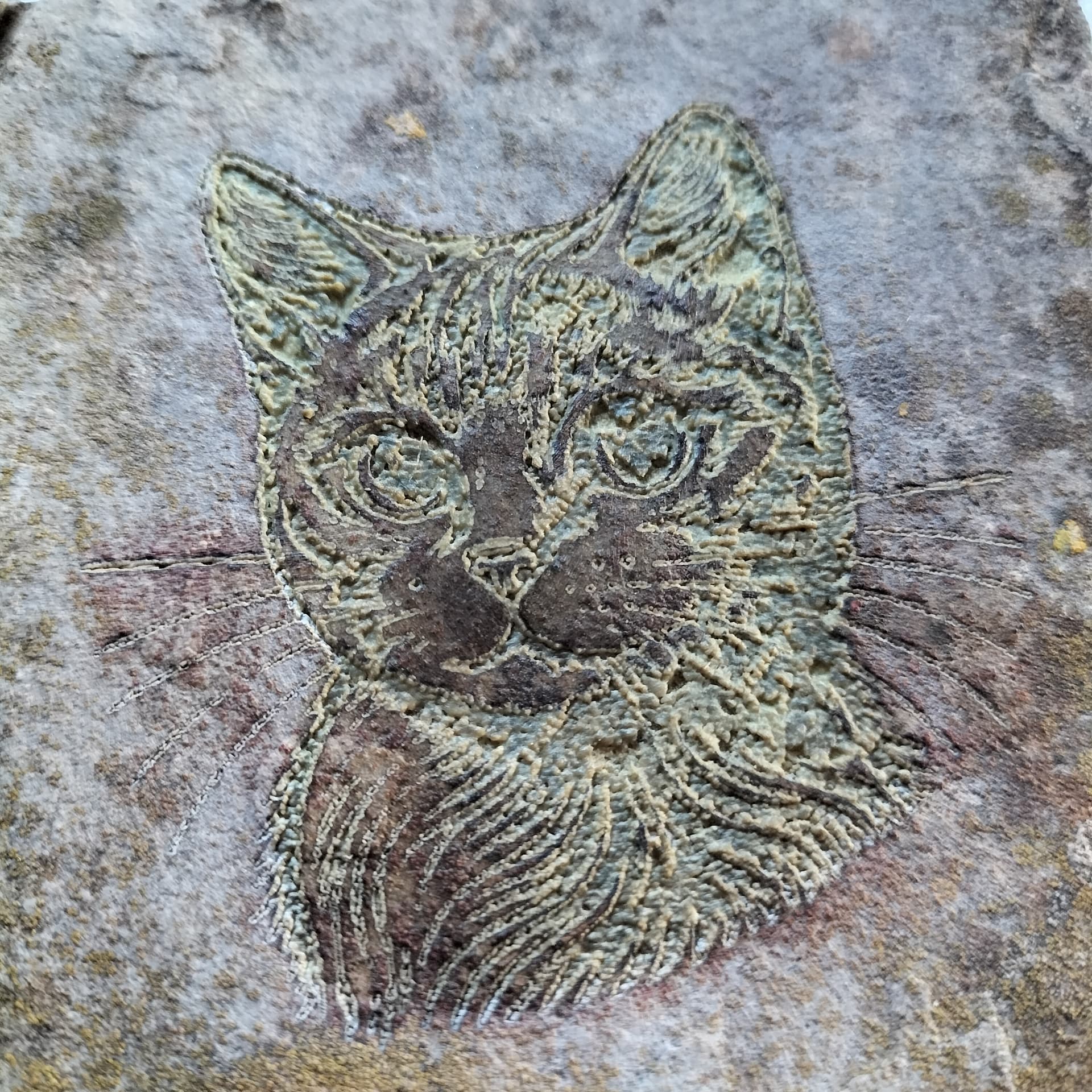

I’m wondering what color those rocks are inside. So if they were broken would the inside show roughly the same color as the engraving…but without the second pass to add more power.
Are the outsides greyblack from oxidation?
Was just looking at the ‘Conservation’ rock and thought the engrave reveals the same color as the speckles…So maybe the speckles just dont oxidise like the other particles.

On the left are Home Depot Mexican beach pebbles, and on the right are Lowe’s Bali Black beach pebbles. The former are basically the same inside as out, it appears, and the latter are much darker on the outside due to the polishing.

The rock on the left appears geologic. The one on the right appears volcanic.

Thank’s for the pic of the rock Nathaniel ;Beverly! I had recalled hitting rock with a hammer and getting brighter color dust, but couldn’t figure out why.
MikeyH’s explanation of volcanic & geologic also explains pure and mixed.rock ingredients

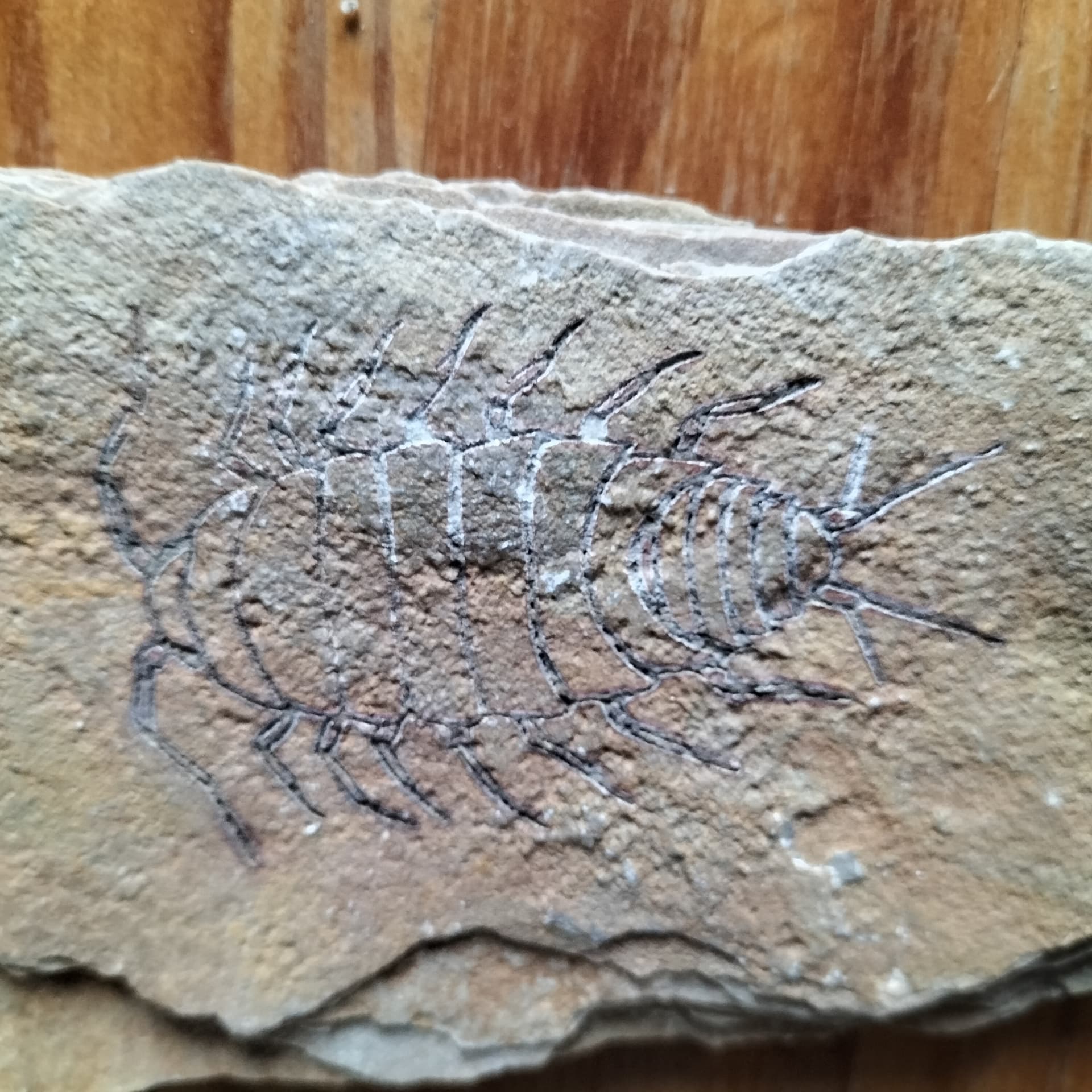

A first attempt. 500mm/min at 90% 1 pass with a 20W led laser. The stone is sedimentary rock, sand based and quite soft. Looks like a fossil. More practice tomorrow. I think a slower pass and more of them.

Thanks. This stone is used for paving here so there is a ready supply. It’s a pity that IR lasers are so expensive here. I don’t want a divorce. Lasers are great fun. It’s a pity I left it so late in life but it certainly keeps the space between the ears exercised.

What dimensions is that piece? and
What difference would the IR module make?

Thanks. The engraving was approx 10x5 cm.
The IR laser would not have made any difference in this case, though I stand to be corrected. I’d like to mess around engraving metals and acrylics.
I had the same idea for the IR so I got one along with the 20w. The IR may work for small pendant type pieces.
Did the 10x5cm take much time?
An IR is very much on hold for me unfortunately. The burn took about 40 minutes but it was at 254 lpi. Next time I’ll try it at a lower lpi.

Second try! Two passes, the first at 500mm/min 95%, second pass 500 100% both at 254dpi. Finished off with a coat of artists acrylic matt varnish. Quite pleased really! Approx 8cm square.

Did the change from lpi to dpi & number of passes make a difference to the process?
Well done brian.
LPI and DPI are the same thing, said a different way. It is Line Interval that is the other metric.
I am sure the second pass made a difference. Pretty sure most of the projects done here were single pass.
Just to clarify “LPI” stands for Lines Per Inch and “DPI” stands for Dots Per Inch.
About this matter what I know is LPI/DPI is kind of “limited” to the thickness of the laser beam. The higher the value (theoretically most definition) the higher the possibility of the laser beam pass thru the previous line. Resulting not in one pass but in one pass and a half if, for example, the line pass thru half the previous line.
