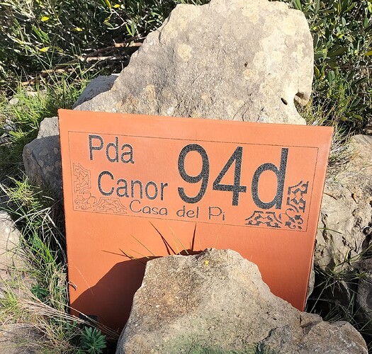

An old address from years back. A terra cotta tile. Various LPI but all burnt as before at 500mm/min at 95%. I’ll cement it into place one day.

There is no “additive” on the burn. It is raised above the surface. It’s not obvious in the photo but with lower LPI there is a flecked effect with the orange showing through.
Whatever you did, it still looks great.

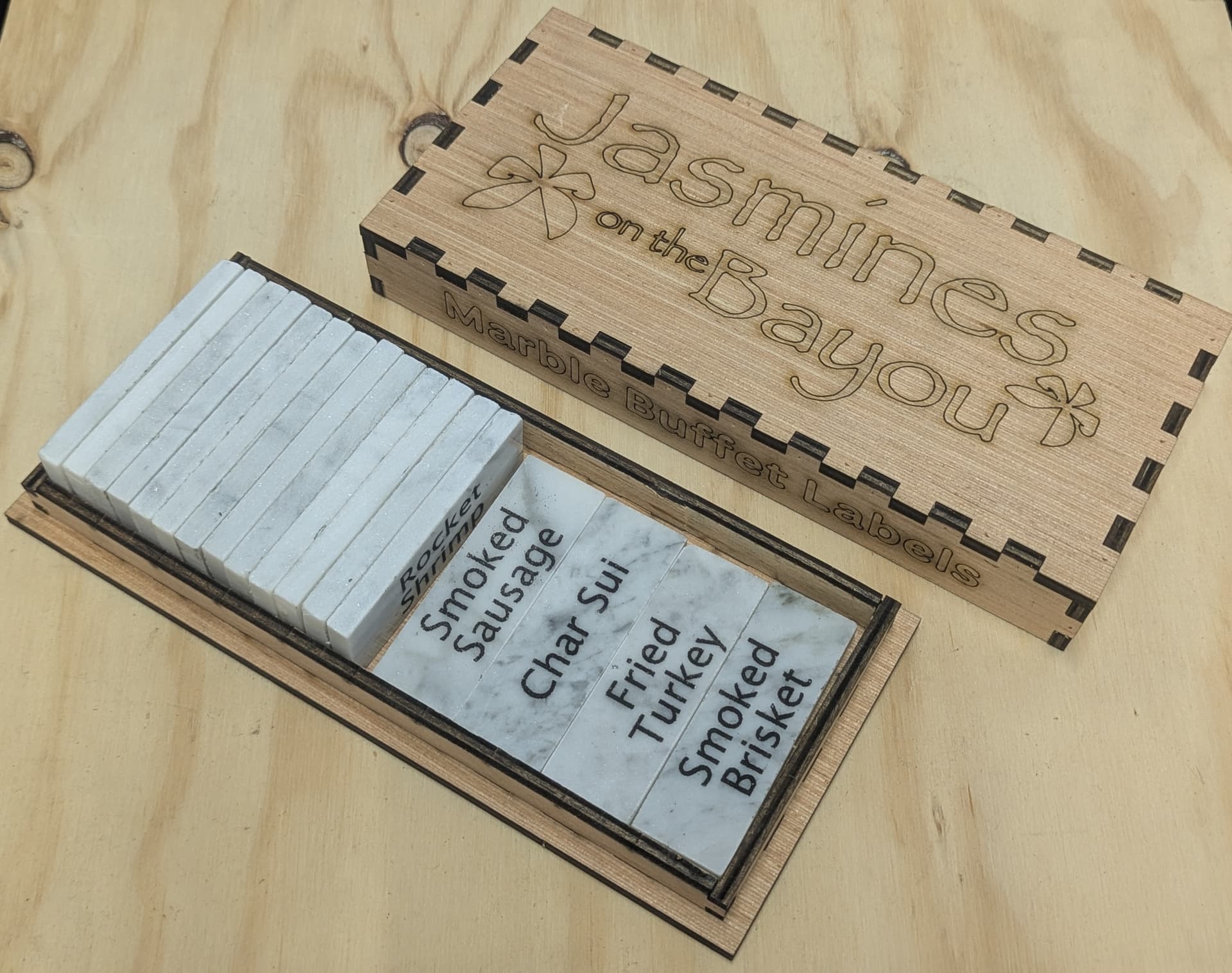

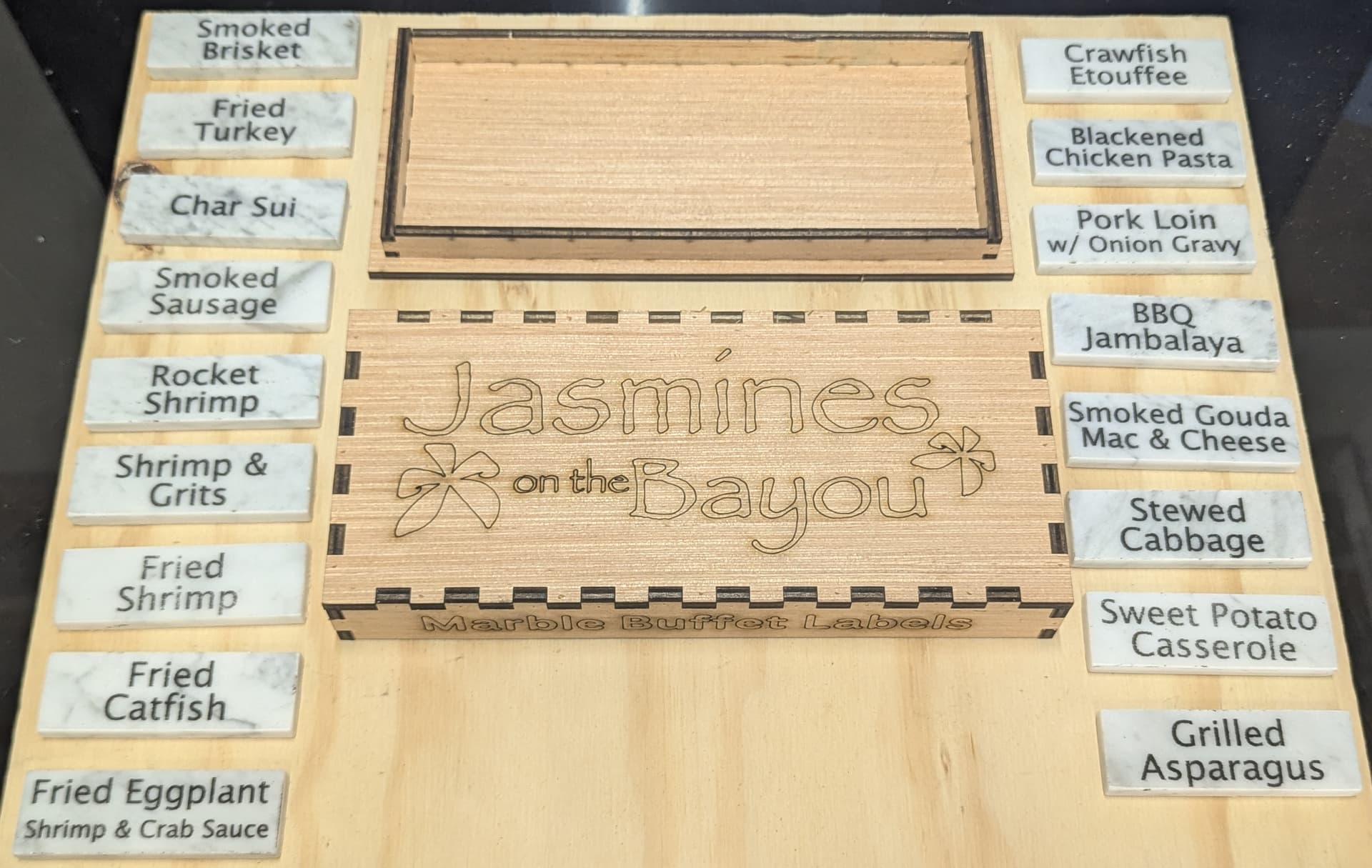

My wife’s gearing up for the big Mother’s Day Brunch Buffet at Jasmines on the Bayou (the only Sunday they’re open all year). She gave me this year’s menu last week so I could update the pretty one I’ve rendered for them each year (alas, no lasers involved, just a lot of Inkscape). That was easy enough, but it got me thinking. They usually just print out stand-up labels for the various buffet items, but I mean, hey, don’t I have a shop full of lasers?
So, I figured why not try my hand at frying some more rocks. If I ordered one herringbone mosaic polished white marble tile panel, I ought to be able to disassemble it and end up with a stack of 48 marble “labels”, each 1x3". If I then engraved them on the fiber laser and did a quick black paint fill…
It turned out to be quite easy. I peeled them off the fiberglass screen backing, hit them with the laser (3000mm/s, 70% of my 60W, 80kHz, 200ns, 0.05mm interval, three bidirectional cross-hatched passes), brushed on some black acrylic paint (the kind in the tube from art stores), and quickly buffed the polished face clean. I finished them with a just a bit of sanding to soften the edges, clean up any paint on the sides, and take care of any fiberglass threads or residual adhesive.

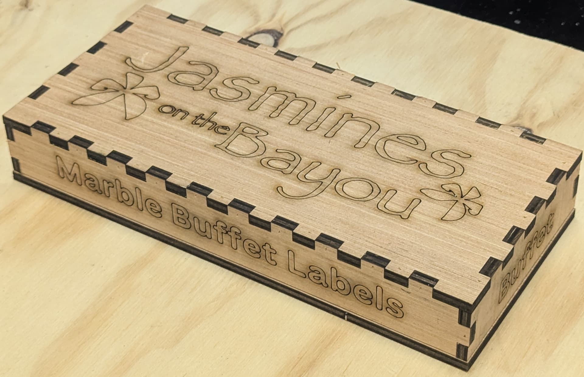

Of course, if I want them to stick around, I figured I ought to make a little storage case for them. Since the menu changes a bit each year, I made the case with plenty of room for additional marble labels, and I engraved the top (for aesthetics) and the sides (for visibility).
Anyway, here you are, some particularly rectangular and partially shiny rocks, plus a storage case.
Incidentally, the marble tended to “shatter” into grains in the engraved area. Definitely not smooth, but since I was doing a paint fill, I considered that a positive. Also, the more pure white the piece, the less deeply it seemed to engrave. There wasn’t really a noticeable difference in general, but a couple of the pure white pieces were a bit shallower than intended.
