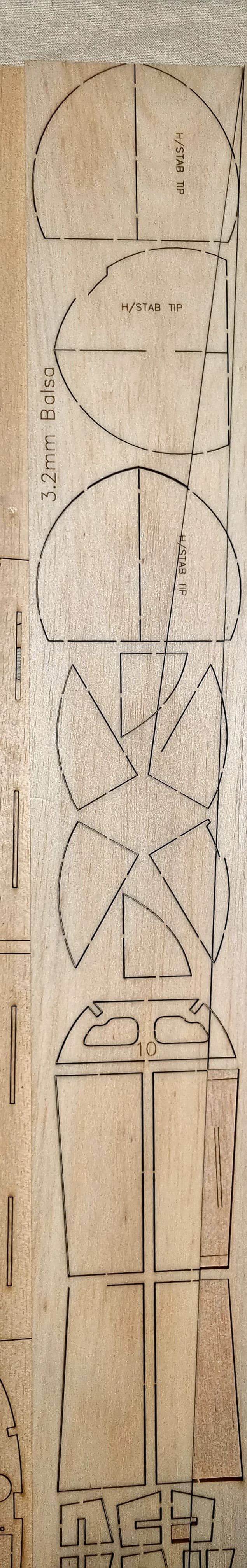

Do you have any pictures of the results you are seeing?

Attached is a pretty mild case of the affliction. You will notice that the laser played nice upto a point, then lost the plot completely
