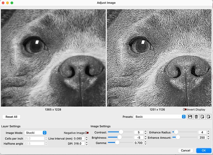

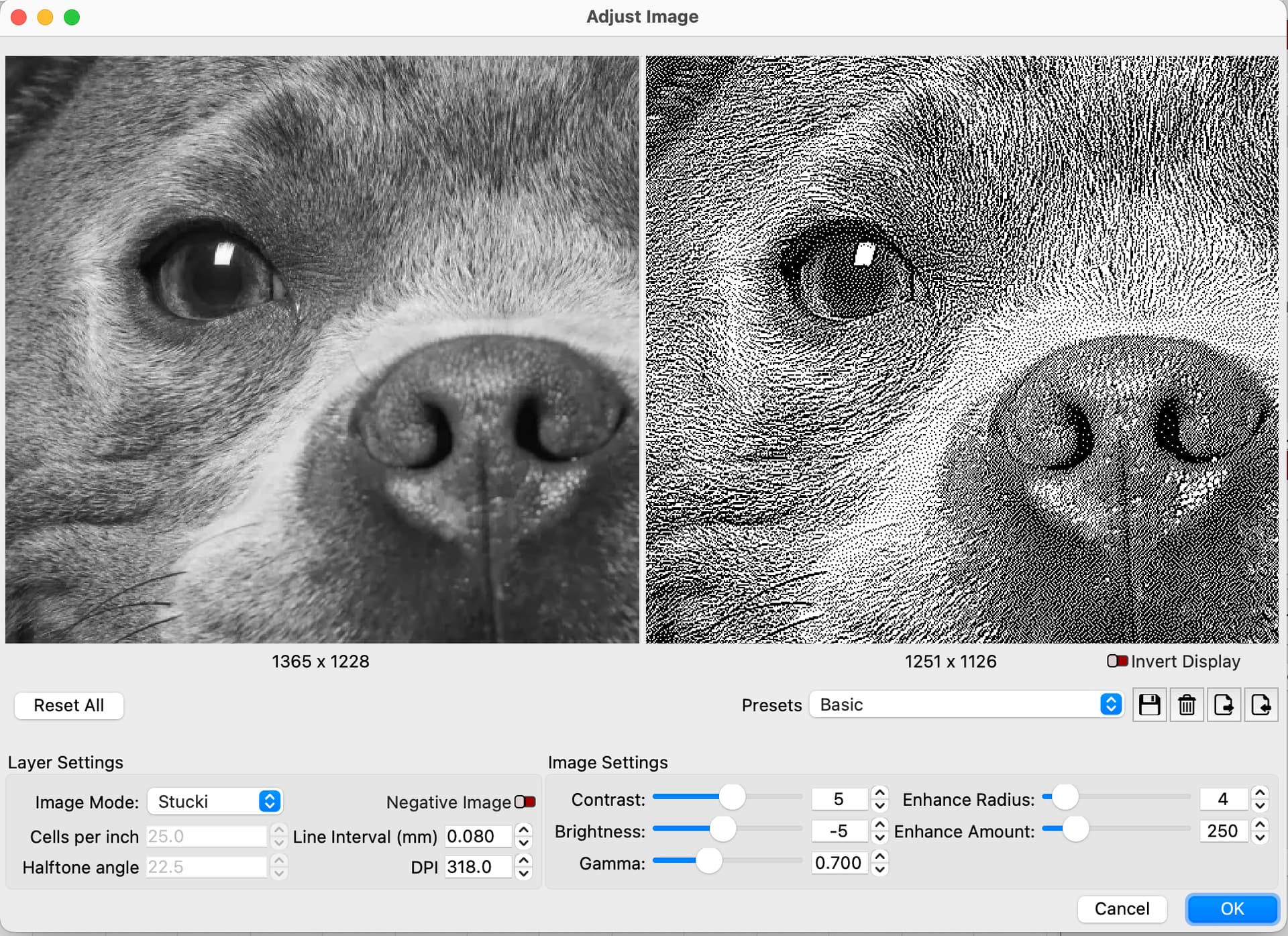

Almost all of the image modes use some kind of dithering technique, which means you will always get dots.
So you’re not doing anything wrong.
Try different image modes for various dither effects, use the ‘Adjust Image’ tool to get a preview of what the dither will look like, the ‘Basic’ preset is a good place to start:
Grayscale image mode is not a dither, but definitely worth experimenting with.
If you get stuck with settings, post a picture - but this time include something in the picture for scale (e.g pen, ruler, coin, playing card…or a banana!), and/or upload here your .lbrn2 project file, explain what the material is, and somebody will surely help.

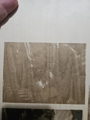

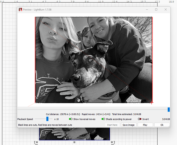

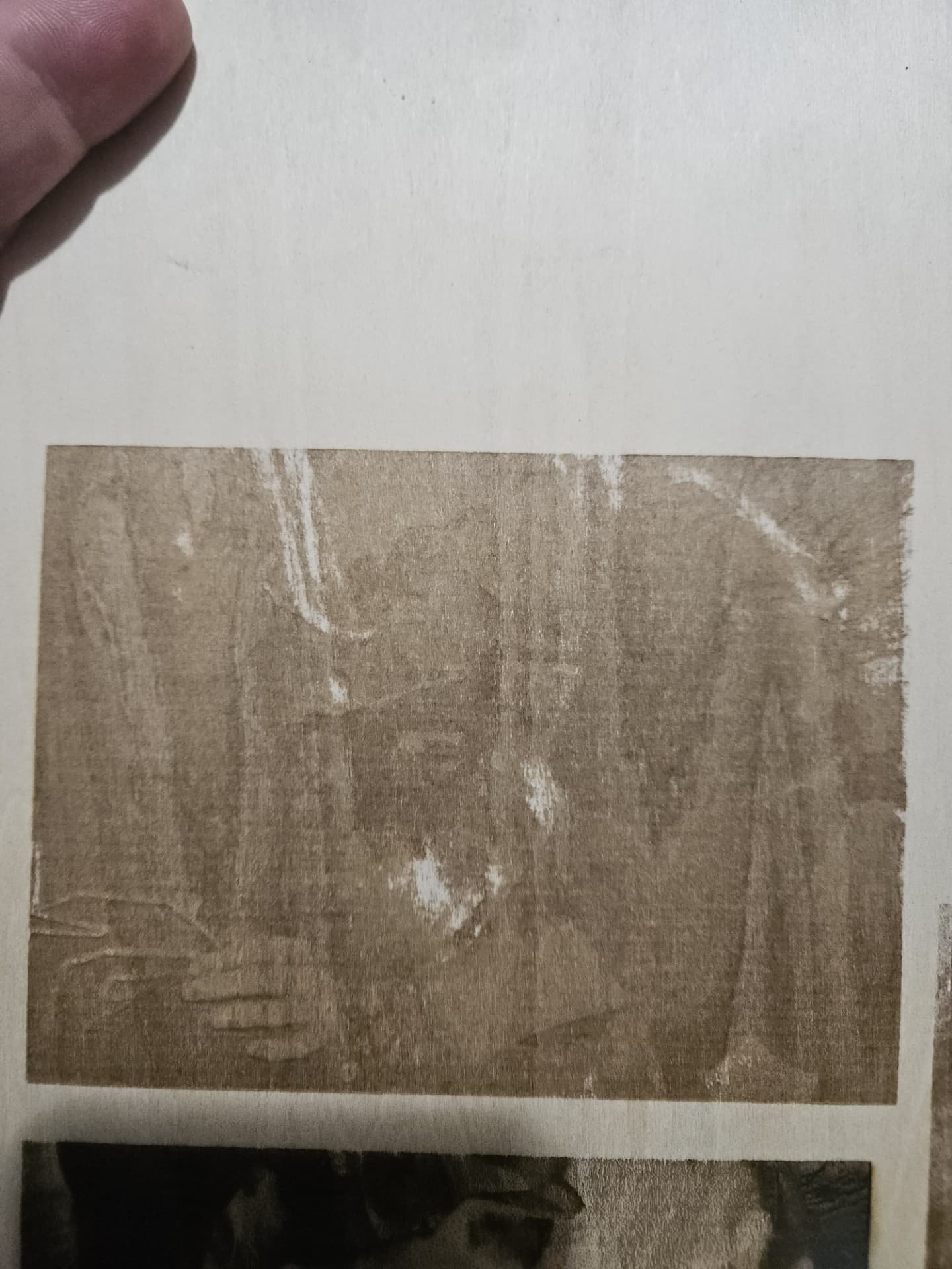

This is what the preview looks like using greyscale, Looks great but when I engrave it the whole picture is black and you can barley see the image. I attached the file I am trying to do.
G Family 1.lbrn2 (829.1 KB)

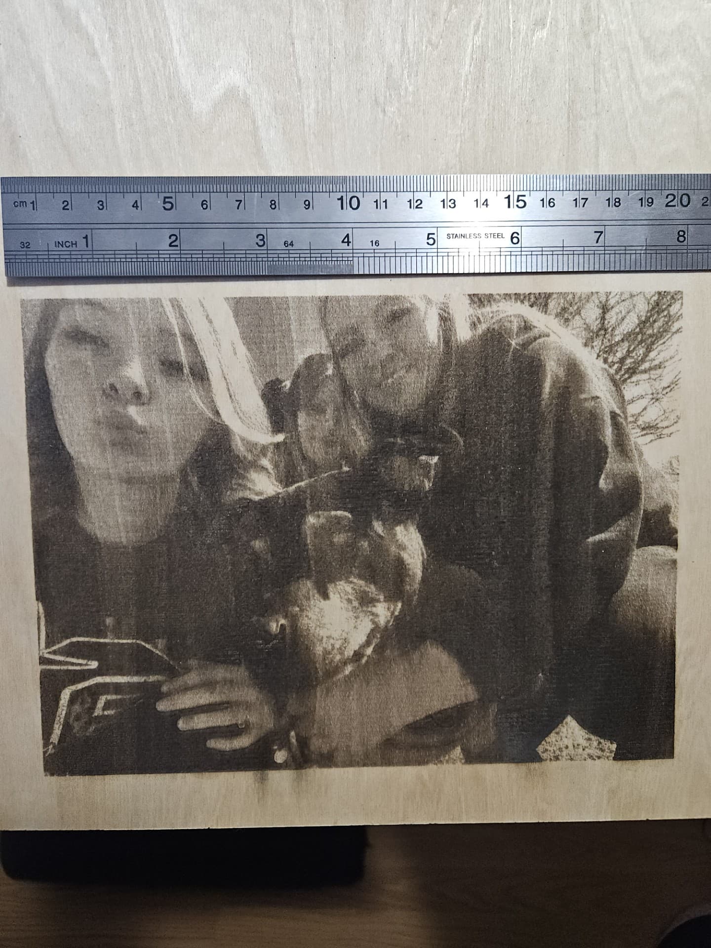

This is the best one I have done out of all of them but its dark in spots and you can see the lines. 8"x6" on wood

You have been warned about interval by more than one person, but you seem to ignore it. Looking at your project file, it appears you are attempting to do a 300+ dpi on the wood… I think it’s highly unlikely you will get that kind of resolution on wood.
The amount of detail or dpi (interval) is dependent on the tool you use and the material.
The tool may have a better ability for detail than the material.
Take some large values… you have a 1" laser beam… that gives you the ability to do 1 dpi. If the laser beam marks or damages a 2" area per pass, then your dpi is limited by the material to 1/2 that of the laser beam or spot.
Wood isn’t very good at grayscale or the ability to maintain a high degree of detail. I’d suggest you watch one of the Laser Everything videos on picking the correct interval or dpi. This is important no matter what you are using the laser for, it will need some kind of dpi or interval.

What I have found is that there is no best setting. The image properties is what determines the best settings. Every one is different. That is why everyone says images are the most difficult to do.
Those guys that show the amazing images do not mention the result might be after 5-10 tries, or more. If you do a lot of them, you will get a feel for where to start with your adjustments. Here patience is not a virtue, it is mandatory. :grin:
