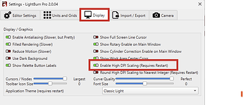

There is a known issue with this in version 2.0 and up. The Dev team is working on a fix but it hasn’t been released yet. In the mean time use the enter key on your keyboard for ok and esc key for cancel.

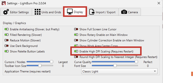

This should not be needed anymore.
Instead, try enabling High DPI Scaling in the LightBurn settings here:
I did it and is even worse…
Thank you, I did it and is even worse… The thing is that on older version it works fine.
