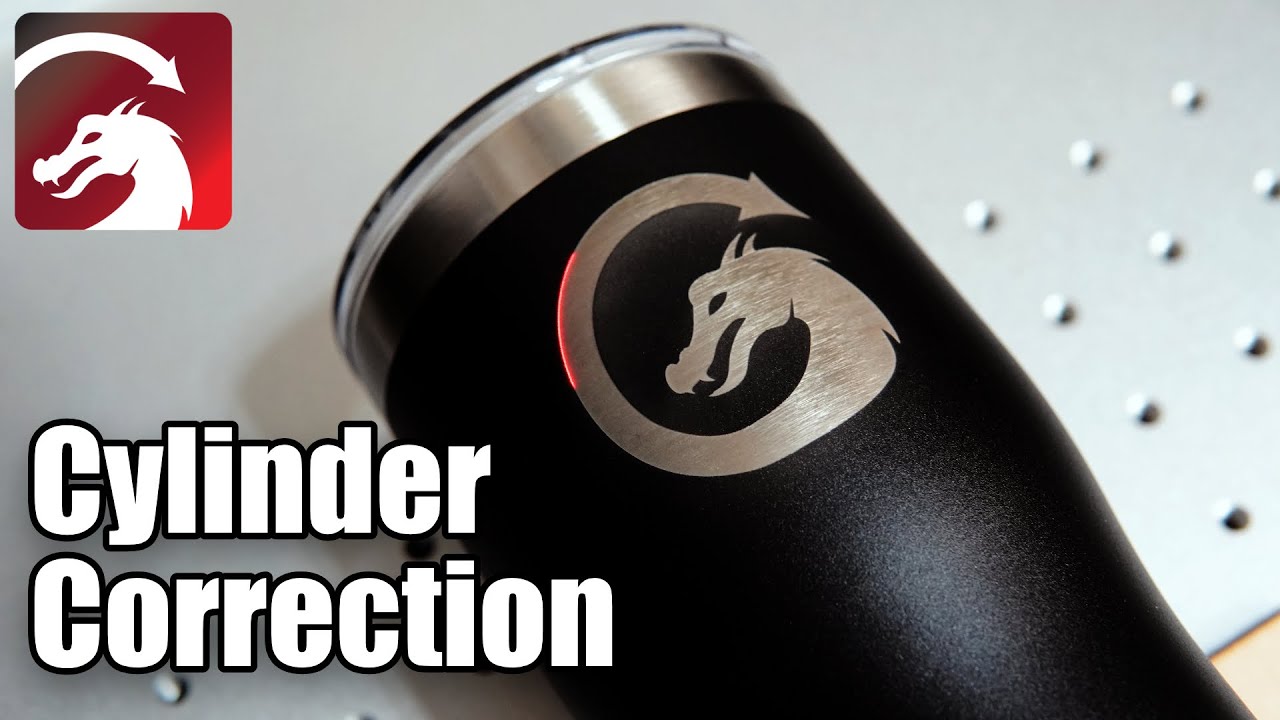

Just got a galvo myself and have not attempted this, but I have watched the video on setting it up and using it… Maybe that will help you…

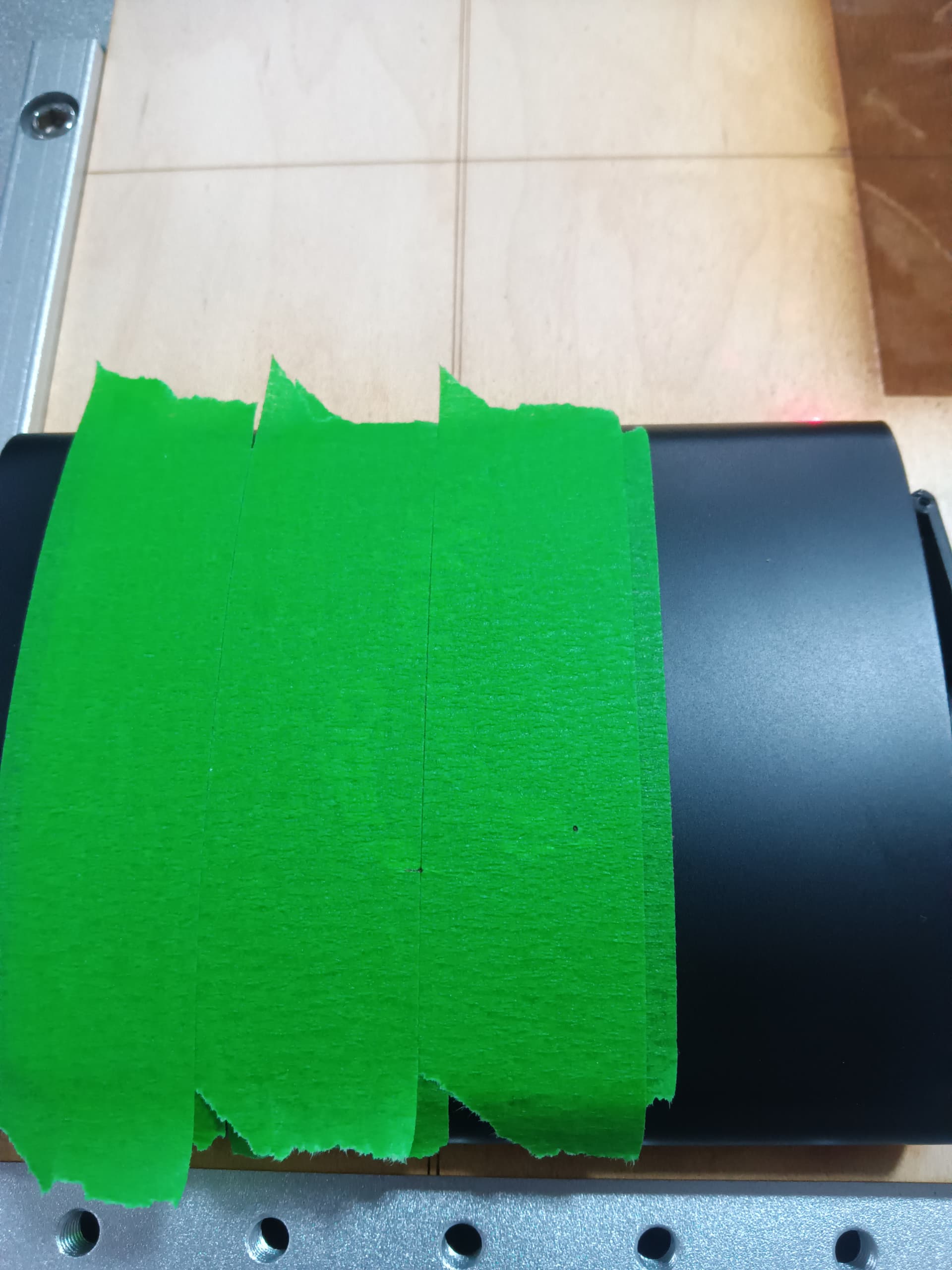

Ok, when framing with those settings it didn’t look right, so I masked over the flask, and yeah, something isn’t right with what I’m trying to do. argh
I guess I’ll do it without ‘correction’ because my friend liked how the test looked. It was only me that thought the line “cigar bar” on the right side looked off by a degree or so…
it looks TERRIBLY distorted on the masking. Not sure you can make it out in this crap photo. :slight_smile:
