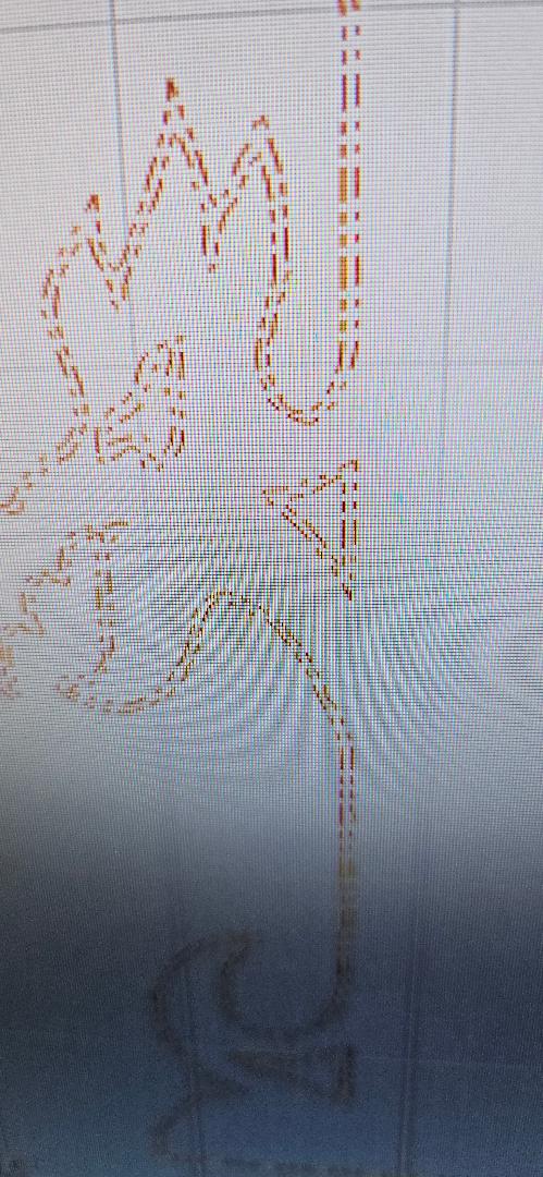

Can anyone help me with this? I used gimp to clean up some of my patterns then copy them to Lightburn. As you can see, I have 2 lines and it is a pain to clean the second after laser finish cutting. I messed up by deleting the old patterns and now I cannot take back to gimp because gimp cannot read .lbrn. I just want to delete the inside line. I cannot just click on the line and delete because it deletes the whole pattern. Spend most of the day watching you tube about removing lines and none was about my situation.

Ty both but I think I didn’t explain it very well. Yes, the patterns are unlock and I cannot click on the inside line to delete because it deletes the whole pattern. What happen is I copy and paste the pattern from gimp. Then I traced the pattern and use it to resize the size I need. This is how it turned and I did not noticed it until I cut the first 15 pieces to this clock I’m making. Is there any way to delete the inner line? Yes I try nodes also.
As stated above, the function is ungroup, not unlock. Try ungrouping, and you can definitely delete a single line as a single object.

With your project selected, and the dot-dot-dash line moving, click the Ungroup Icon in the top row. When finished, you will see a dashed line and be able to edit the shapes separately. You may have a group of grouped groups so your art may need to be ungrouped more than once.
This may be worth review:
It is ungroup. All ungroup did was single each section of pattern. I still cannot remove that second line. Guess I will have to fight with the second everytime I cut these patterns out. As you can see in the pic, all it did was ungroup the places where cuts go. I still cannot remove that second line. Thanks for all the help but it did not solve my issue.
If you now deselect everything and then only select one line, does it select both? Hard to believe, since both don’t look connected and then those are two separate objects then.
yes it still select both

I’m definitely able to select individual shapes after ungrouping, or am I missing something here?
To save getting the double lines when tracing in LightBurn have you tried InkScape’s centerline trace instead?
try to break it apart instead of ungrouping Click on arrange and see the drop-down menu you will find break apart.
Before break apart you must select all you want to edit
You may also need to ungroup multiple times. There may be nested groups. ie, groups inside groups.
In the example file that was posted there was only one level of grouping.
There was no need to break apart on the example file posted, just a simple ungroup.
