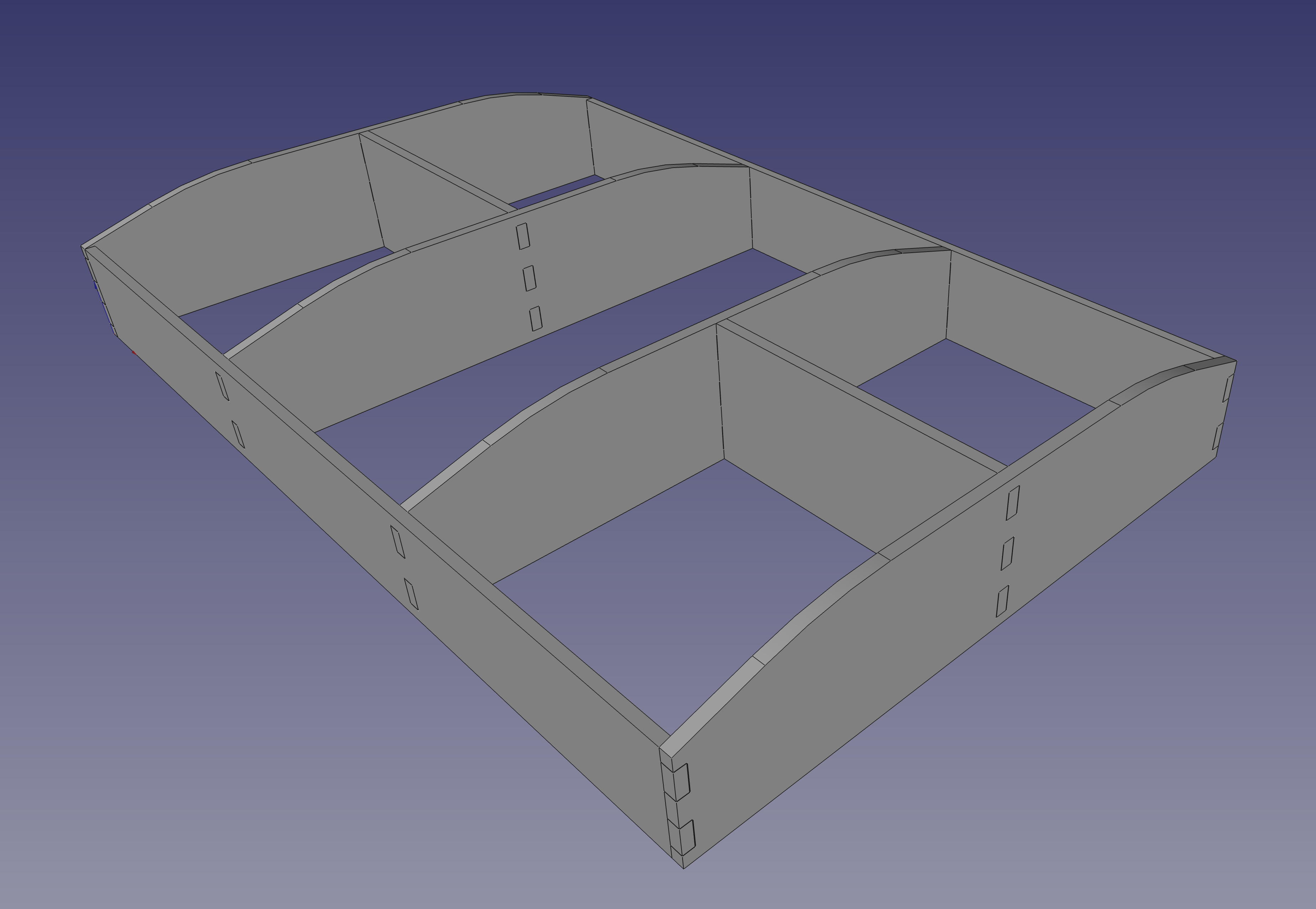

I’ve made a few handy things. The ones that come to mind are a 5-section drawer divider for my wife’s top drawer, to stop the undies encroaching on the socks. I will not be providing a photo because I would be excommunicated, but you can see a screenshot of the design in FreeCAD — the long parts juuuuust fit diagonally across the 500x700mm laser bed:
It slotted together firmly and didn’t need glue, which was a bonus! 6mm wood, possibly pine, made from some old shelves. Clear lacquer to protect the clothes from the burnt wood smell (should it smell? Or is that a sign that I’m burning instead of cutting? I imagine it should smell.)

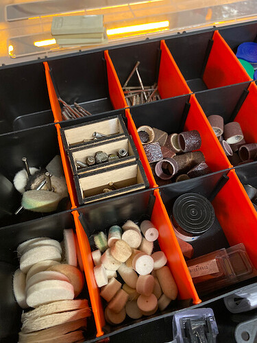

I have some cheap-from-Bunnings storage cases (fantastic for $10 each!) in the workshop, which I use for screws, components, Dremel stuff, etc. The compartments are huge for the smaller things, so I am trying out some “sub-compartment” ideas, currently cut from some dodgy 3mm ply I found somewhere. The concept works, I just need to tweak the dimensions a bit and make a lot more of them:
(very poor glue-work… a new type of tube and it went everywhere)

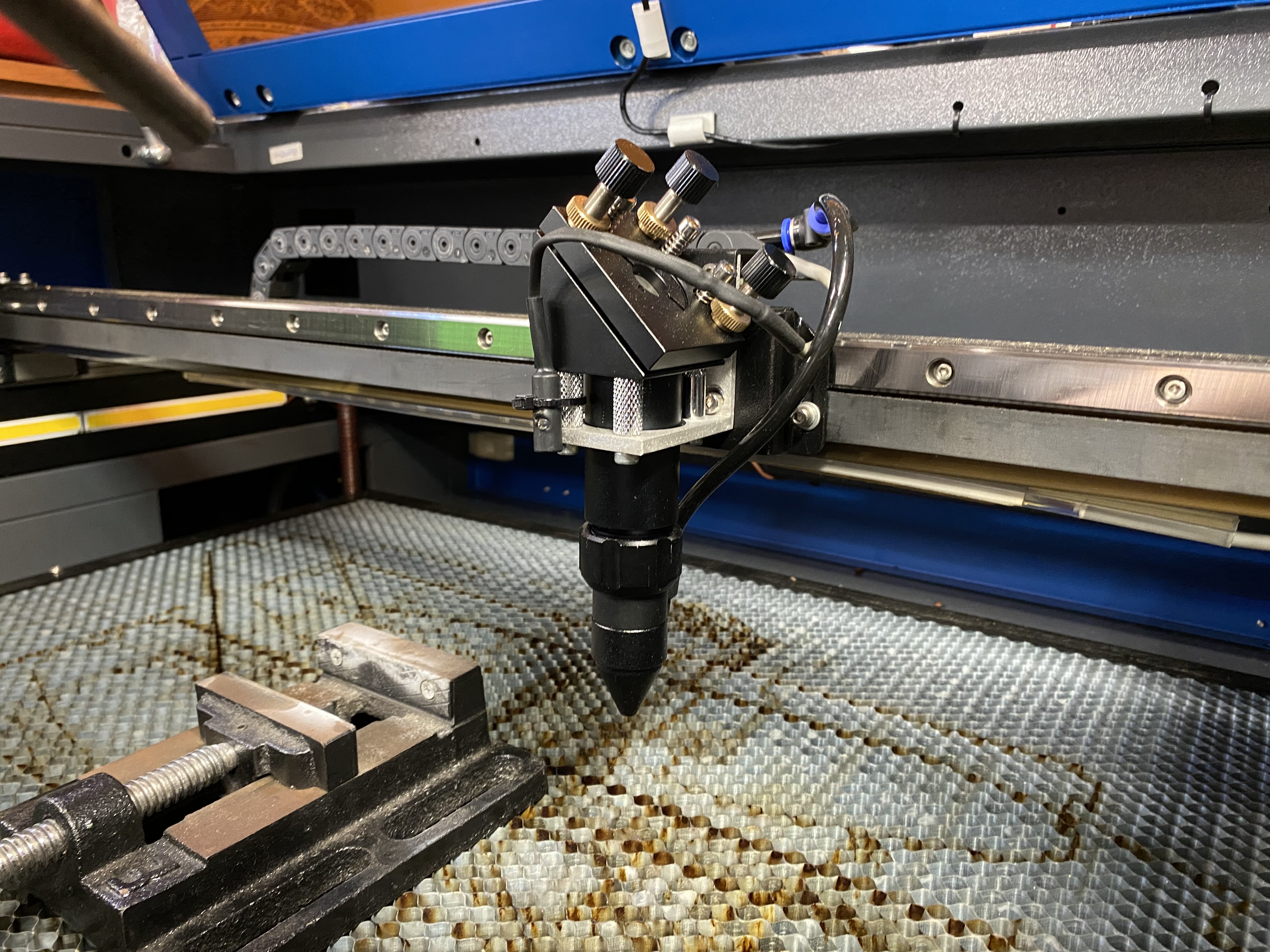

Did you get this accomplished? This is a Russ Sadler designed head, probably who designed the Cloud Ray…
This is an external view, before and relatively current… I had removed the honeycomb and replaced it with a rolled steel plate… I have alignment holes in it for jigs.
Wonder why you need to raise the head up… that much spacer is going to have a lever/pendulum effect… I would think it would be real close without any kind of adjustments…
I took a slightly different tact with the air assist… Left solenoid allows high pressure air into the system. It flows through the restrictor. When a layer executes, with air assist enable, the right solenoid bypasses the restrictor, giving full pressure… do you have snubber diodes on this somewhere?
There is no direct way to drive an led (dpssl) module with the Ruida… You will have to use some kind of external logic in order to fire the laser at the right time… The Ruida uses two signals to control an lps… the led only uses one.
A lot of what you gain with this other head, is less mass… you can increase the acceleration… and lower job times… if you add an led, just the opposite occurs… of course if it’s for fun and education… great :wink:

I did! It’s not the prettiest, but I’m telling myself it’s a prototype. I built it with the scrap I had available. T-section would have been better, but I had a few bits of 90° extrusion on hand. The spacers were made from an old tap wrench handle :rofl:
The red dot laser is just zip tied on to stop it flapping around. I’m debating whether or not I want to keep it.

I think it’s kind of neat addition also… You will have to get power out there and add some logic to deal with the Ruida having a laser enable to fire the laser, the pwm on the Ruida runs the whole time the layer is executing… So the pwm by itself can’t be used. It would have to be gated by the L-On signal of the Ruida.
I dumped the drag chain and all of that off mine… The pointer was always pointed at the wrong place and it was very difficult to adjust… I have 4 lenses, so it was more of a hassle than I wanted to deal with. I use alignment jig with good success…
Replaced my honeycomb with a rolled steel sheet with locating holes in it… Much easier to clean than a honeycomb. Removes the #1 cause of co2 fires…

Congratulations on your nozzle holder. To me it looks nice and practical.
Regarding the little positioning diode (red pointer), I like to “see” where my CO2 laser is going to cut. I first had my little holder in a self-made version in acrylic, but later found this one here on the web, Cloudray makes it in aluminum and sells it for a small amount of money.
There is, for the rest, another very good advantage in using the small diode. When I focus the diode laser on a corner of an “unknown” material, I am always 100% in focus. This of course presupposes that I have set up the diode correctly.
Me too, but it wasn’t right very often without constant adjustments… then change lenses and it’s the same issue…
The fiber has a pair of laser diodes on the galvo head… ok for a single lens, but a bear to adjust and if you change lenses like I do it takes more time to fiddle with them than I care to spend.
There is no pointer on my co2 at all, no drag chain, and these focus diodes on my fiber are turned off.
Considering the resolution of these machines, they are always off a bit. Mine is bright and much larger than the laser spot…
Do you have two diodes mounted on there in order to focus them?
