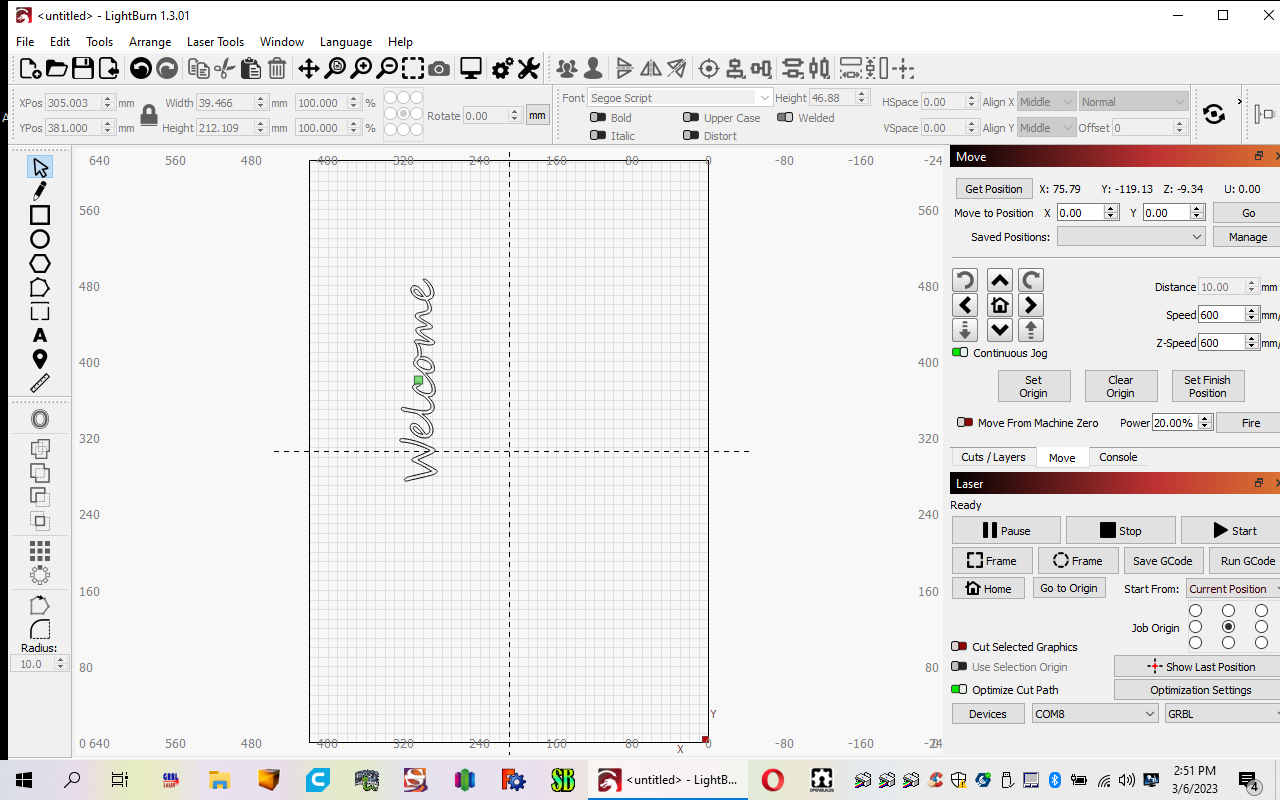

Thanx for the reply! Posted above all the info. I built my machine myself using generic materials. It is 24 x 36 with a 50 watt spindle head and a 30 watt laser attachment. When I try continuous feed the
head moves about half way across the table and stops, x or y axis. I have soft limits disabled and hard
limits enabled with limit switches. I can’t rely on the machine to jog properly as it tends to switch axis direction at will? When I try to home it only tests the upper z limit switch, one x axis limit and one y axis limit. Usually when I jog the x or y axis with continuous feed enabled the machine moves the same direction for both arrows, won’t reverse. The funny thing is that once I have a gcode file properly configured for Open Builds, LB will run the file perfectly, go figure.

This is the likely source of a good portion of your difficulty. You’re running in negative workspace.
Can you confirm if you ran these commands immediately after homing? If not, can you clear the offset, home and then rerun these commands? Clear the G54 offset with G10 L2 P1 X0 Y0. I’d like to understand where that leaves you.
Let’s revisit this after sorting out the negative workspace.
I see this as standard. Can you describe what you’d expect this to do? Homing in GRBL systems only identifies a start point, generally origin. It does not subsequently extend in positive direction to identify dimensions of the machine. Is that what you’re expecting?

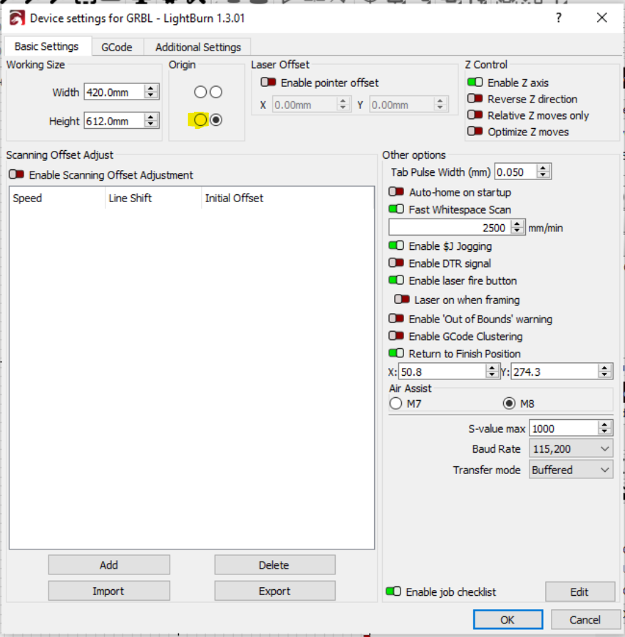

Machine homes to lower left corner.
Including screen shots.
You’ve set Origin to bottom-right. Is this deliberate? I’m going to go out on a limb and assume your machine should be configured for bottom-left as bottom-right would be extremely unusual for your setup and rare in general.
Can you change your origin to bottom-left?
Post that, can follow these steps. You missed it from my previous post.
  1. Clear G54 offset by issuing in Console:
G10 L2 P1 X0 Y0
  1. Return the output of those commands please.
  2. I wanted confirmation on expecting homing behavior. What you described seemed normal but you indicated that you were expecting something different. Can you elaborate?
