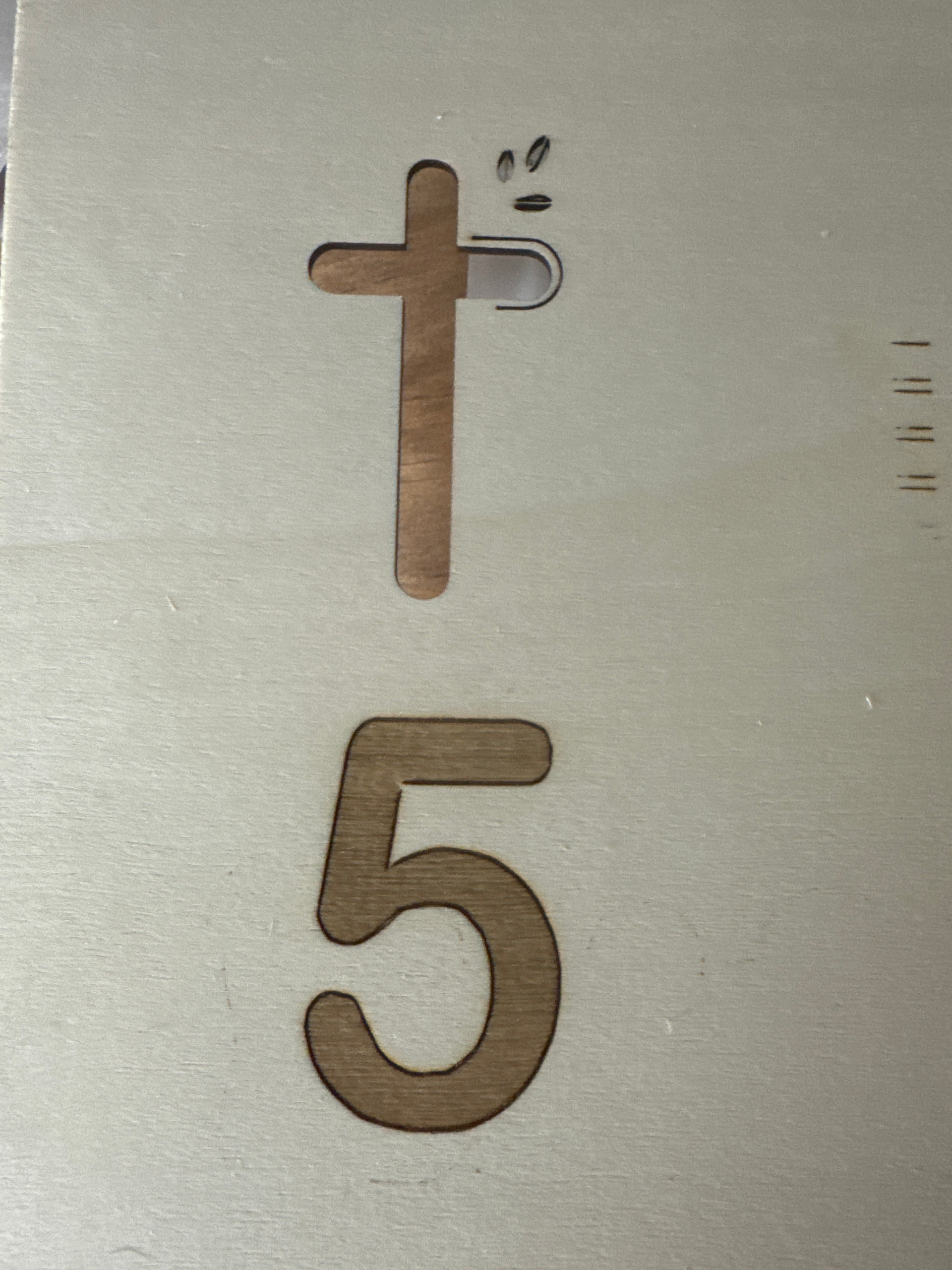

I just started using my woxcker JL7 and one file from creative fabrica worked fine. I used Lightburn font to try to cut out and fill in a 5. It filled it in but didn’t cut it. I tried using the word “home” to cut and it went through the motions but wouldn’t cut.
What am I missing?

cutting on basswood the word HOME in script. The laser will go through all the motions it just doesn’t cut anything. not sure how to add a photo on the computer.
It is a 10w. I have had it cut a cross in a bookmark and then stopped it. I then tried the word HOME in script written from the font on lightburn.
When I preview it, it has about 4 red lines around the word so I’m not sure what that means but the laser will show me where it will be cutting and then goes through the motion, the laser is on but it won’t cut anything on my basswood.

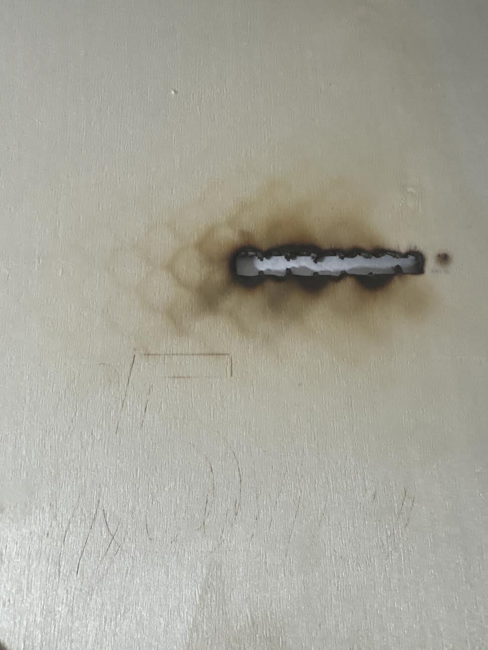

the burned spot is when my husband was doing a test awhile back
In the top picture you can see where it was trying to do the 5 and the word, home
a word i typed out on lightburn. the word Home…
the 5 is good on the fill but it wouldn’t cut it out

Here is the summary after the smoke clears:
  1. You can etch (burn) the “5” quite well. This establishes the laser is working.
  2. You are not cutting thru the Basswood. This suggests you have a settings issue.
Try these settings for the cut layer:
Speed = 800mm/m
Power = 90%
Constant Power = ON
Passes = 6
>>> Let us know if this works!
Problem sending to laser = Reseat your USB cable connections.
It worked! thank you!!!
