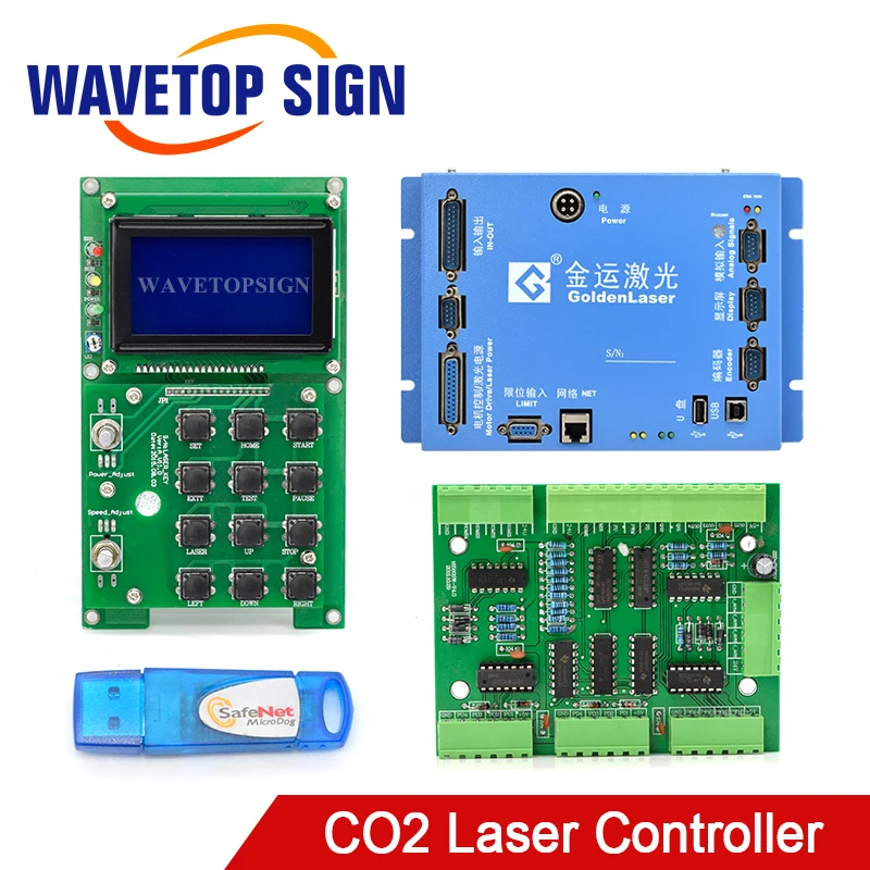

Not sure, but it might be this controller.
Thats the replacement one you can get by that topsign company dosent actully say what the controller is tho
I guess I read it wrong, looks like it’s saying it’s a Trocen AWC708C…?
Ummm just googled that and looks nothing like that lol
Looks like a good collection of parts!
Just reading the ad, maybe it’s in a different box???
Couldn’t hurt to try…
