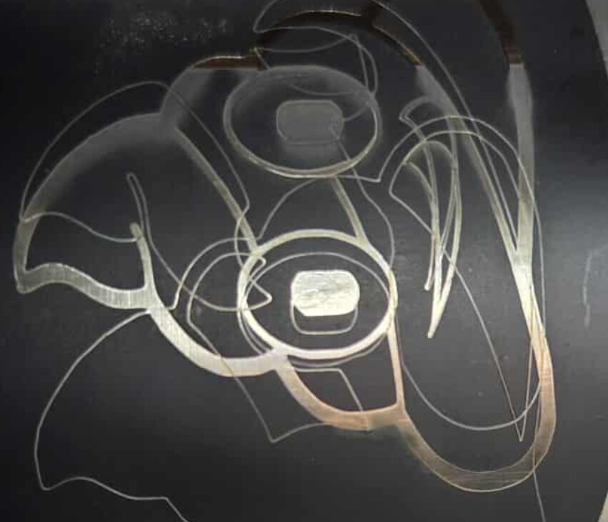

Good evening all, I am having an issue with my JPT MOPA 100 and rotary/chuck. I have gone it set up with the Lightburn crash coarse. And I tested the setting and it rotates a full 360 like it should. But when I go to engrave the chuck does not move. I sure I am missing a step, any ideas? Thanks in advance.

Sorry I was play around to see if it would rotate on the Y axis. I have it set to X axis while I am trying to get this to work.
I understand what your saying. I did test on both x and y axis and it will rotate. I just doesn’t rotate when engraving.

Well I kind of got it going. I am rotataing after turning off run whole shapes, if possible. My 1st was engraving from top to bottom and image was flipped. Turned on reversw rotaty direction. Framing works good now. Look at the video, see how the laser is firing, is that a speed thing. Thanks again for you help

Please start posting screenshots instead of phone photos, easier for us to read.
@chuckcnm —Yes, please … I haven’t be able to read these without downloading and looking at them in another image application.
Don’t know if I’m up on this but, it appears to me, that these fine adjustment, may be an issue, but this looks like a real problem.
Which seems to look correct, but I’m pretty sure not what you want.
His step rate is in the 10 micron range, likely smaller than the spot size of his lens. I have my overlap set to zero.
Why do these show a lot of layers? Seems only one is needed, so I’m not sure I follow the whole concept.
@chuckcnm you can wrap these in a black masking tape and test your rotary and marking without destroying a mug. I use very low power and I can see where it’s going to mark.
yes that is a problem. I think I have fixed now. When I have the image set to fill, it engreaved but tumbler never rotated. When I set line, it engraved the lines that you see. I was running out of test tumber space is why the pic it the way it is. I have since turn off the run whole shapes if possable, that has fixed that issue.
