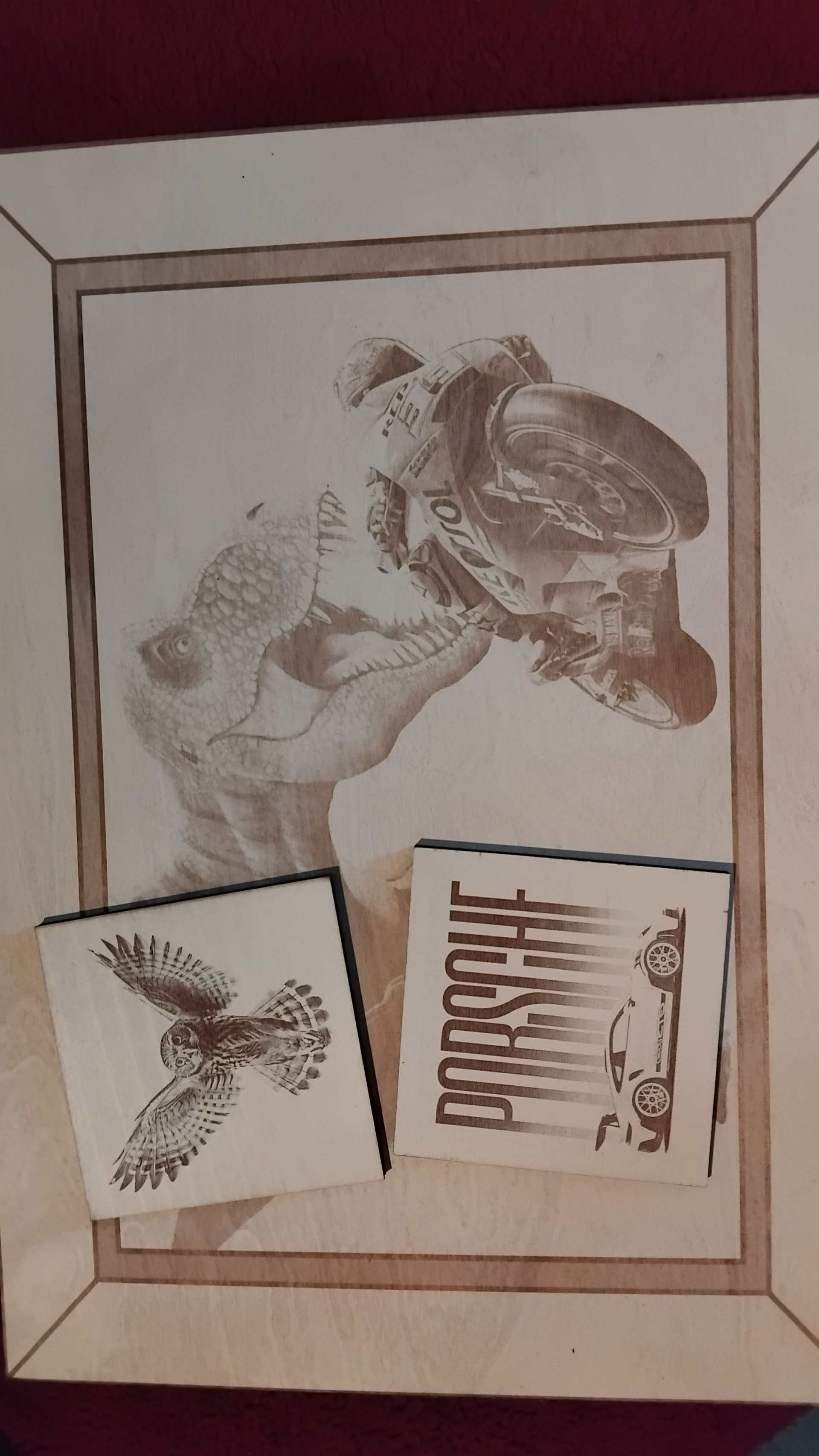

Lightly sprayed white on birch ply and lightly engraved dinosaur, the coasters were done at approx 20%/3000mm/m
They look really nice, the big picture could use a little more power..
Well it’s an odd one, had no idea what to do so I just put the bike on screen and decided to follow the surrealism of the big slate with two bikes on racing track, but one bike visibly leaving the frame (all unrelated images) and thought not to follow through with the usual. I noticed the Dino was also in motion and could be made to be in contest with the bike…and willing to play dirty.
I purposely engraved the Dino lightly as a solid engraved was too obvious and wouldn’t play with the eye, so the bike is quite visible but occupies the smaller area while the Dino is ghostly but fills the larger area…keeps the attention for just that bit longer and departing with a ?
Also the framing came out with a nice hint of gold reflectance…common when engraving on white acrylic.

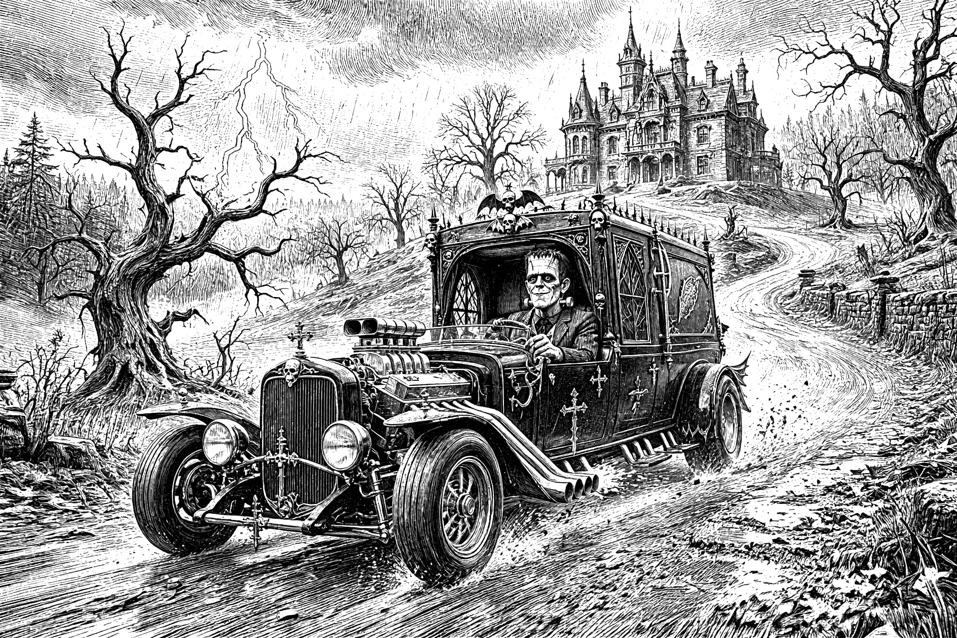

Then I ran 2 scripts with a minor change.
KEEP: Keep the exact positions, scale, and pose of all foreground subjects Do not move, remove, or add foreground objects.
Redraw everything in [vintage STYLE]. highly detailed black-and-white woodcut engraving / vintage ink illustration, but on a paper white background, with dense cross-hatching, fine line work, and engraved texture but in 16 shades of gray
Same script but with a reference to Ansel Adam’s style
KEEP: Keep the exact positions, scale, and pose of all subjects Do not move, remove, or add objects.
Redraw everything in the style of ansel Adam’s . highly detailed black-and-white woodcut engraving / vintage ink illustration, with dense cross-hatching, fine line work, and engraved texture with a paper white background. I like this one, the one above is ok, but looses the mood.

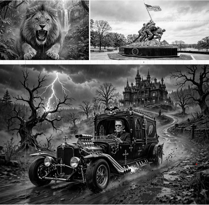

I don’t want to burn divots in the board. I’m going to give the borax treatment and see if that makes a difference. This image is the 8 bit top image with my adjust image settings applied, no scripts or other enhancement. All LightBurn. The data is there it just needs to be black and gray. I’ll try white paint if the borax doesn’t work. I even have some titanium white used for tiles. I have to wait until th weather is better, because spraying requires outdoors.
The data is there, now all the experimentation goes to making blacks black while leaving whites white.

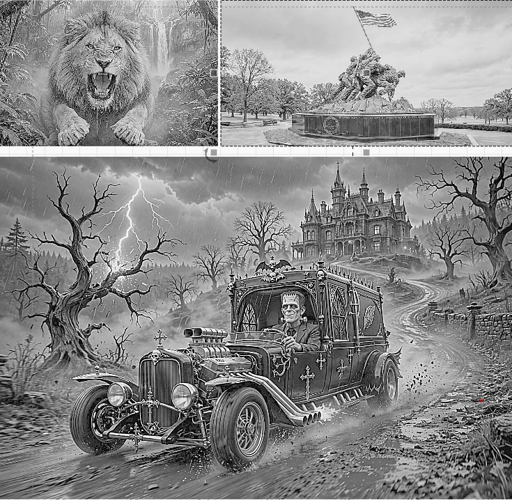

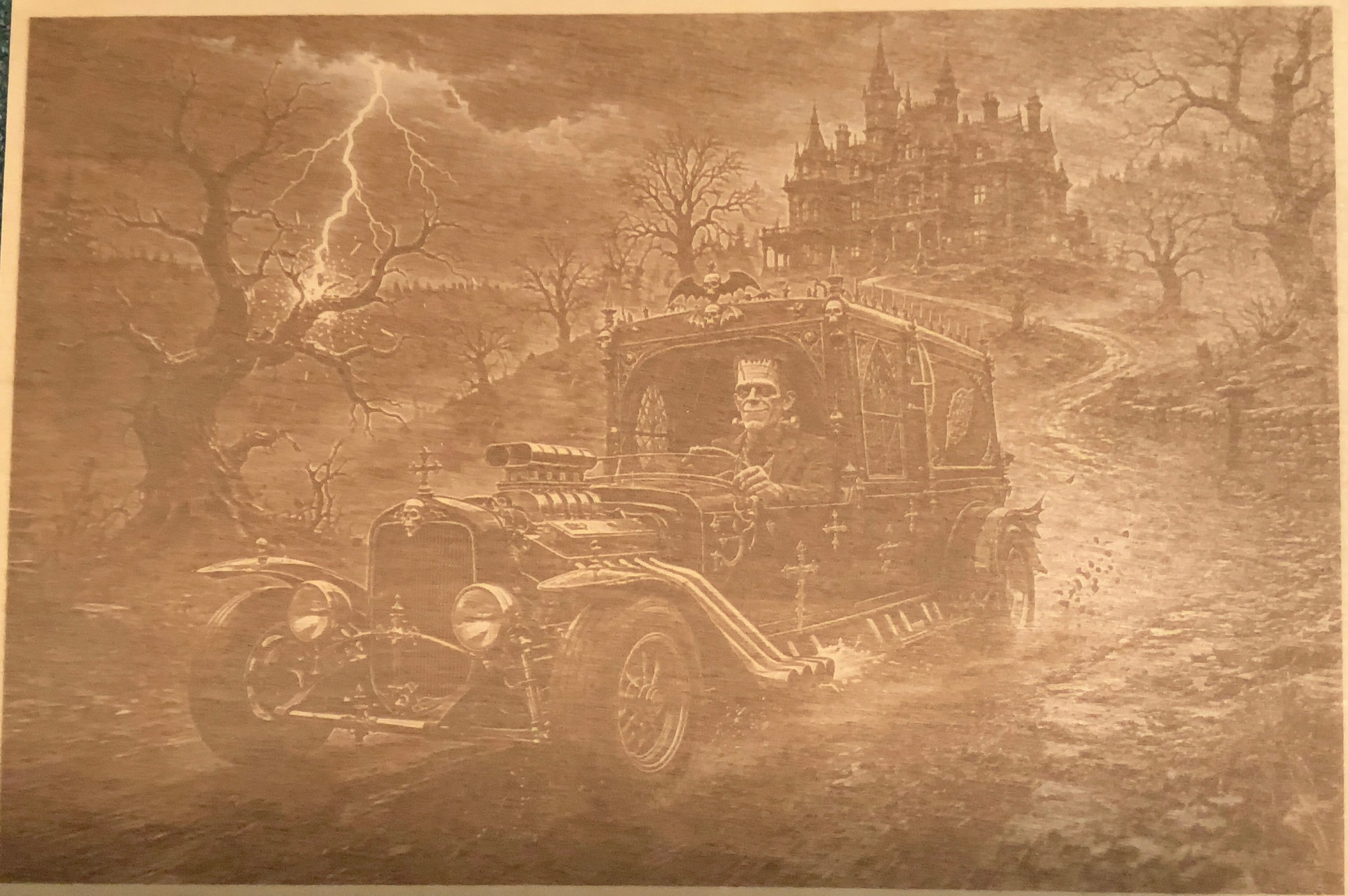

I think this hilights the issue rather well. If we observe the frame of the lasered image, the lightning hitting the tree branch, the headlights of the car and the radiator grill.
The brightest part of the screen image that are important for detail/contrast are the lightning then the headlights and then the vertical brighter lines in the radiator grill.
The brightest possible tone (lightning) can be no brighter than the base material itself. Therfore, all tones darker than that in the screen version get relegated to a tone below Tan (wood colour). This means the greys shift closer to black while black remains black…Detail lost in the radiator grill.
Basically it removes a whole level of contrast from our palette, highlights get clipped and the same from the other end of the spectrum (blacks get crushed).
Now our 16 Tone contrast is reduced considerably and we get a muddy/washed out result with all the potential detail there but not enough contrast between them for perceptive separation.
The radiator grill shows this most clearly.
The less Moody image above with the White background gives us that extra level of contrast, but remember our material is Tan not White.
For the blacks and greys, we must burn the darkest without char, so all greys must be perceptualy brighter than black and perceptualy separated from each other. Then you are left with a narrow choice of midtones.
So as Misken stated earlier regarding slate engraving (or in associated post) ā€˜We can expect approx 5 tones’ So white/Tan is the base colour, Black ā€˜0’ is our darkest…That leaves us 4 tones that must be perceptualy separated for viewing quality on material…not the screen.
This is where the Swatches become useful for colour (value) swapping in Gimp etc or Line tracing/ node dragging to remove/delete grey pixels that border other grayish pixels or dark pixels for high contrast…like around the radiator, so the apparently bright vertical lines become the brightest possible for contrast..Which is the Base colour.
It’s the same for slate, but in Negative.
While a nice screen image gives good (backlit) tone separation, the optimal result on material comes from material and image mode that offers tone range suited to picture size, placement, lighting conditions and viewing distance.

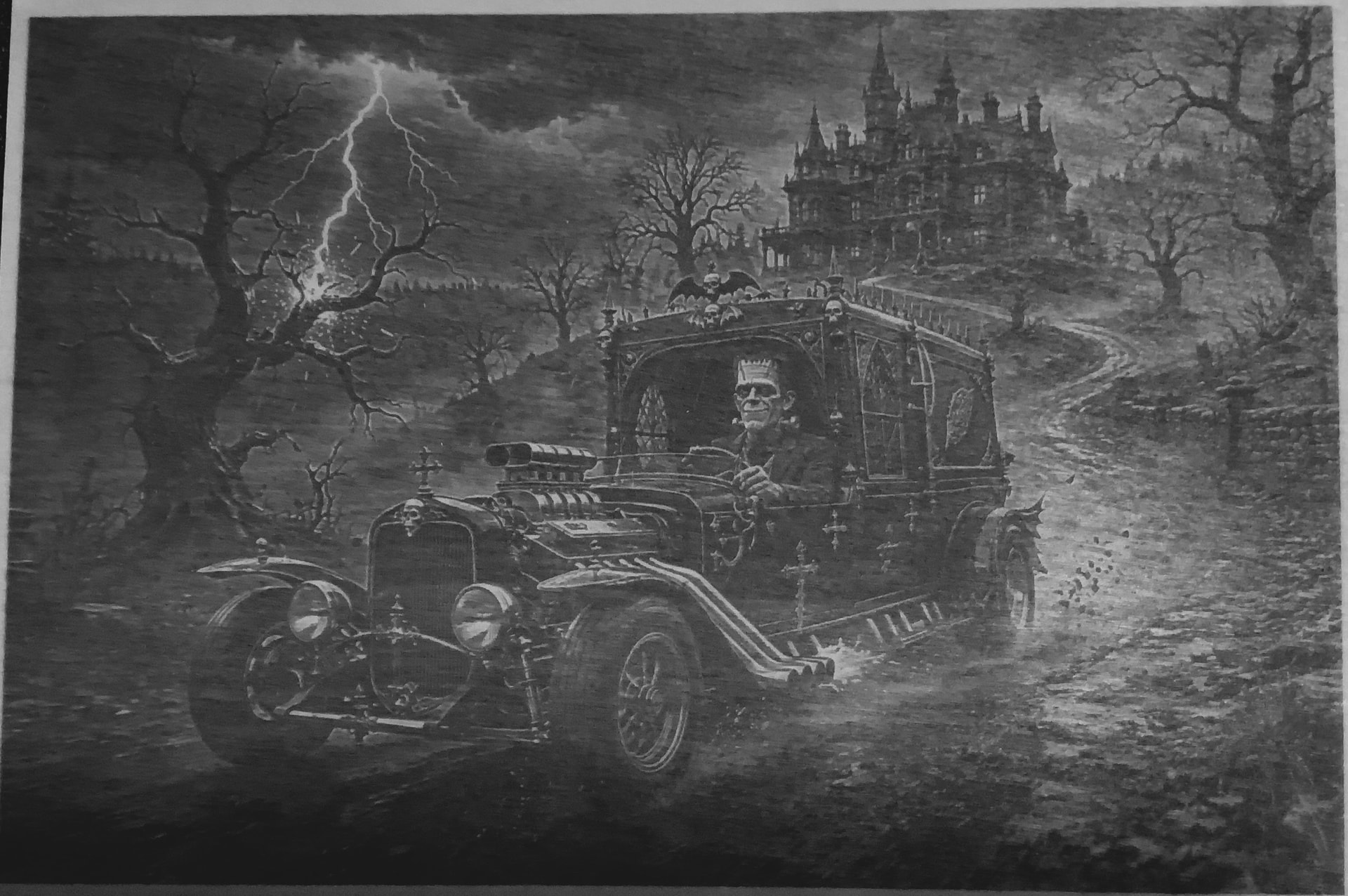

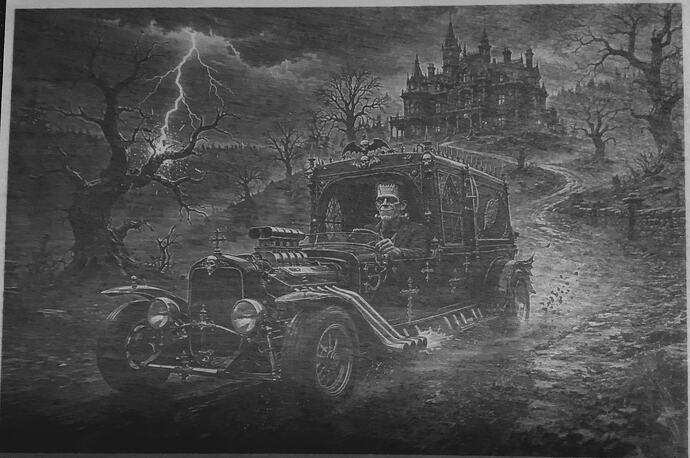

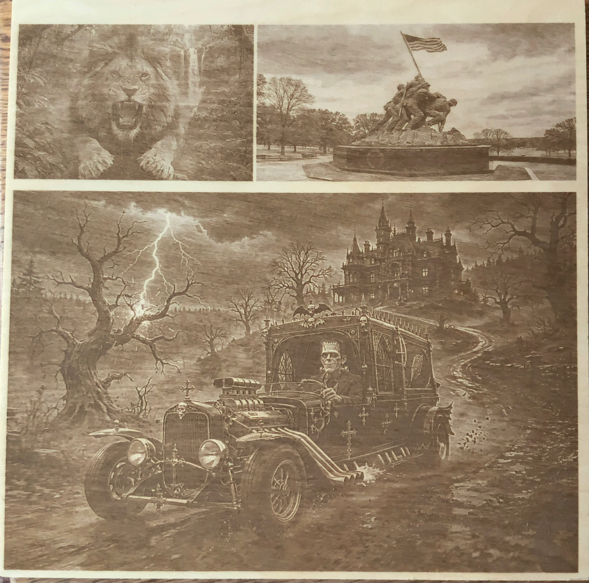

Better lighting, but still not the best. Camera lighting does make a big difference. In low light you don’t see all the detail. Borax or white paint may mak a difference. I am concerned about what happens with the mid-tones. The paint should improve contrast. We shall see, because I haven’t tried this before. I may have to either adjust the LPI or dot size.???
I had done my color lion, and then the monument
Everything uses the same settings.
In brighter light things do look better.
The car image looks good in that light and so does the monument, the grain is pretty obvious in the lion image though, which is odd seeing as the settings were same for all.
This is the original workspace before adding my settings.
then after my settings applied.

This is the outcome on Baltic birch.

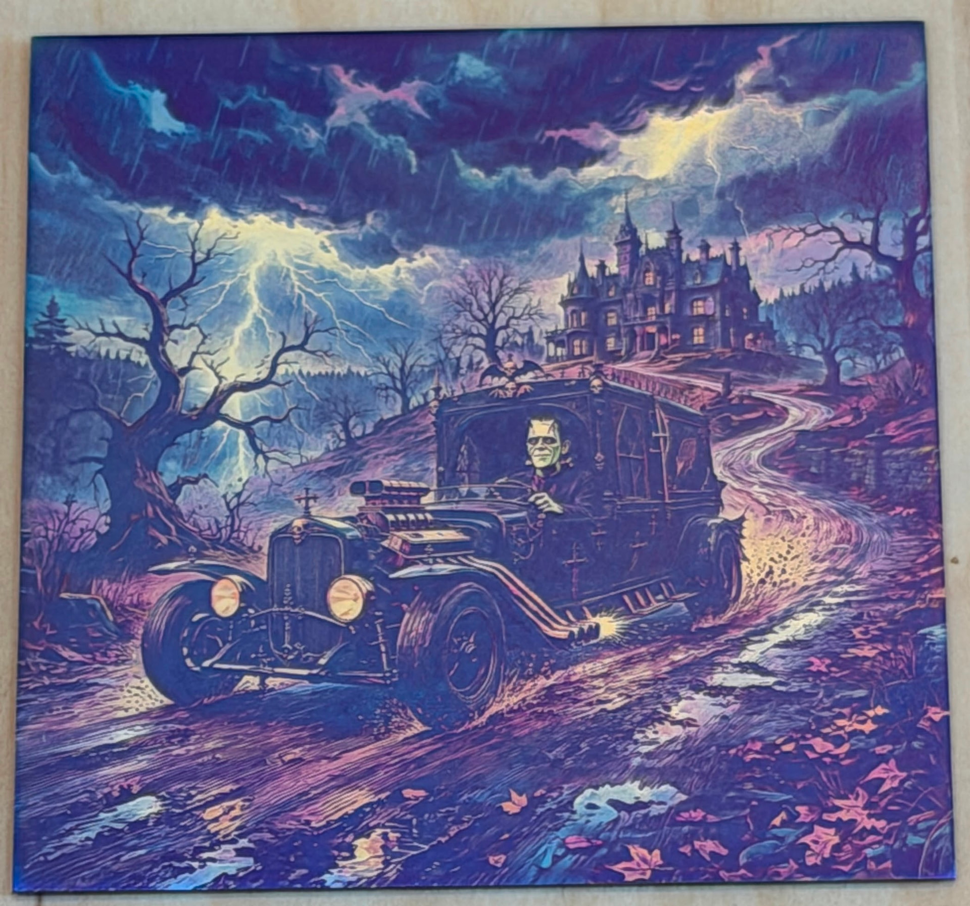

This post about spectrum reminds me of my challenges with lack of contrast in the titanium palette. I agree about not having try white or true black clipping/crushing the contrast. I wonder if there’s a way to bleach the wood to get closer to white.
I charred leather trying to get it darker, and I found I could pull the char off without smudging using wide masking tape. I don’t know what a laser purist would think of what I did. :wink:
Here’s the halloween image on titanium. I think it looks slightly better in real life (gotta find a way to get better photos). The grandkids liked it. :slight_smile: Thank you again for sharing!
