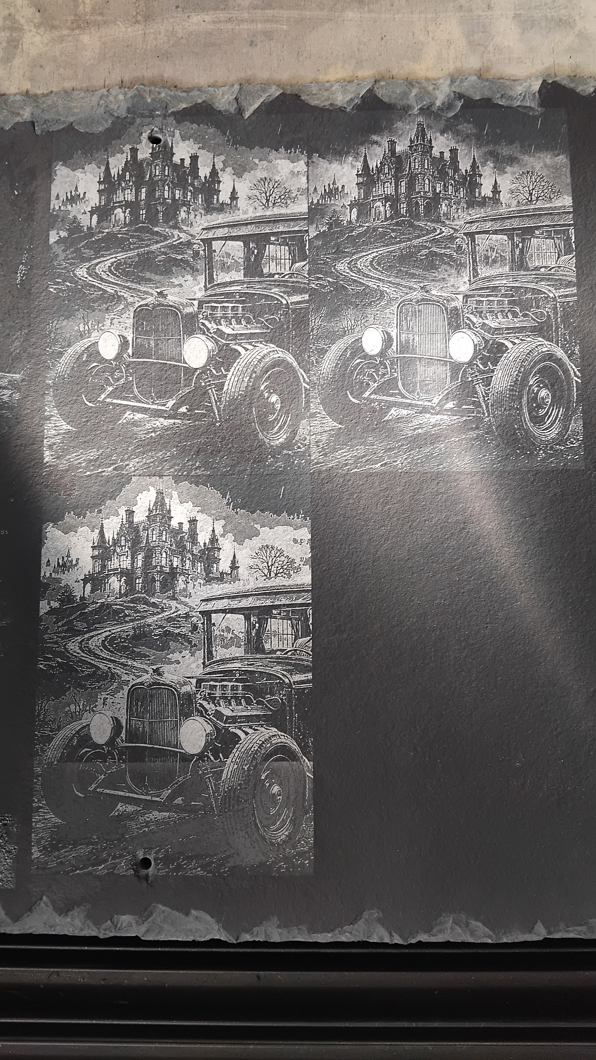

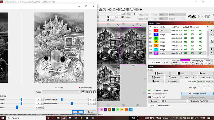

I finally got a chance to do some lasering today and had to make it quick. I cropped the car images from both sides and decided to do the 8 layer posterized with some adjustments in LB as the original just seemed a bit dark.

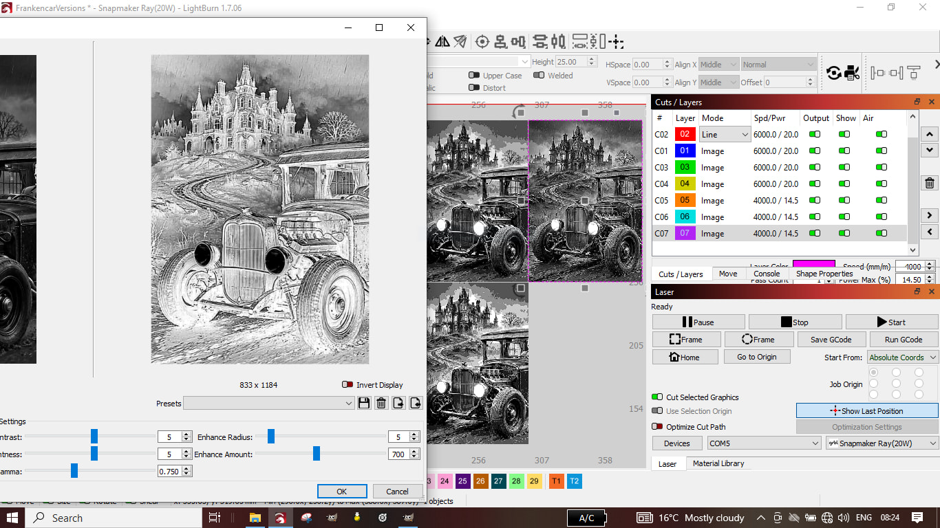

I repeated that but increased the sharpness, brought gamma to just below 1, and increased contrast a touch.
I had to do the original (top right) un-posterized but did sharpen, contrast.
These are definitely presentable. The posterizing works but is not all together necessary…just a matter of preference really.
They are on resurfaced slate with black added, and while it does add contrast I’d like to see it on raw slate as I’m not sure it needed the black to create the stark contrast, the grey of the slate may have been enough…again, maybe just individual preference.
160mm tall with a slight bit of sunglasses on the tile.
Upper right looks best overall.

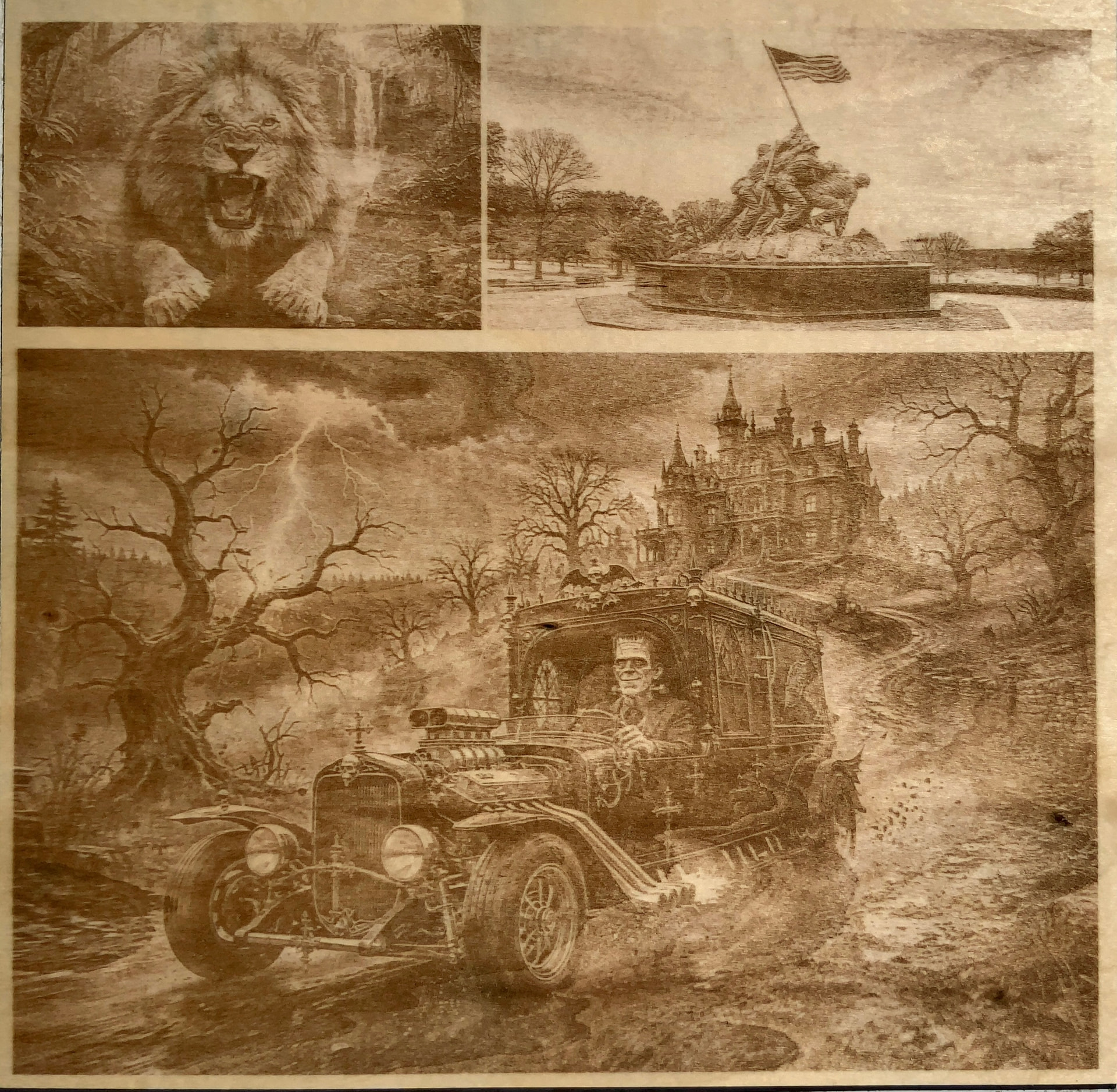

I also am engraving that page with the Lion, Monument, and Munster on Basswood, no 16 levels raw image and my settings. Therein lies most of my Issues. I need a totally different setup for Baltic Birch.
Image to come.

I did achieve what I set out to do. My biggest problem was, I originally calibrated everything for Basswood, and then stupidly switched to Baltic birch and using the same settings. I need to do the same calibration process for Baltic birch. I even got the mist around the lion. Too bad the wood grain gets in the way.
Taken in bright sunlight.
