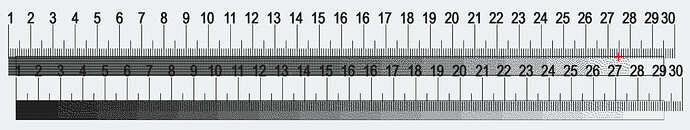

This is what I found out.
Export creates an .svg file which keeps the adjustment settings, so when you import it back in it is still the same image with the adjusted image settings.
if you save processed bitmap then it saves it out as a .png file.
This is what you should use.
Good catch. that is why i was getting mixed results.

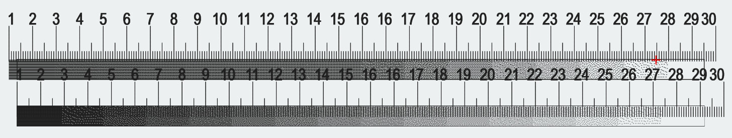

This is a test for output purposes. select all and examine it un the display window. you can see the differences in all the various outputs.
The stochastic is Ai generated to the same specs as the other and output using passthrough.
It is interesting that the Ai stochastic is close to Stuki and Jarvis. Sort of in-between. the only problem is if you change size you change the dithering.

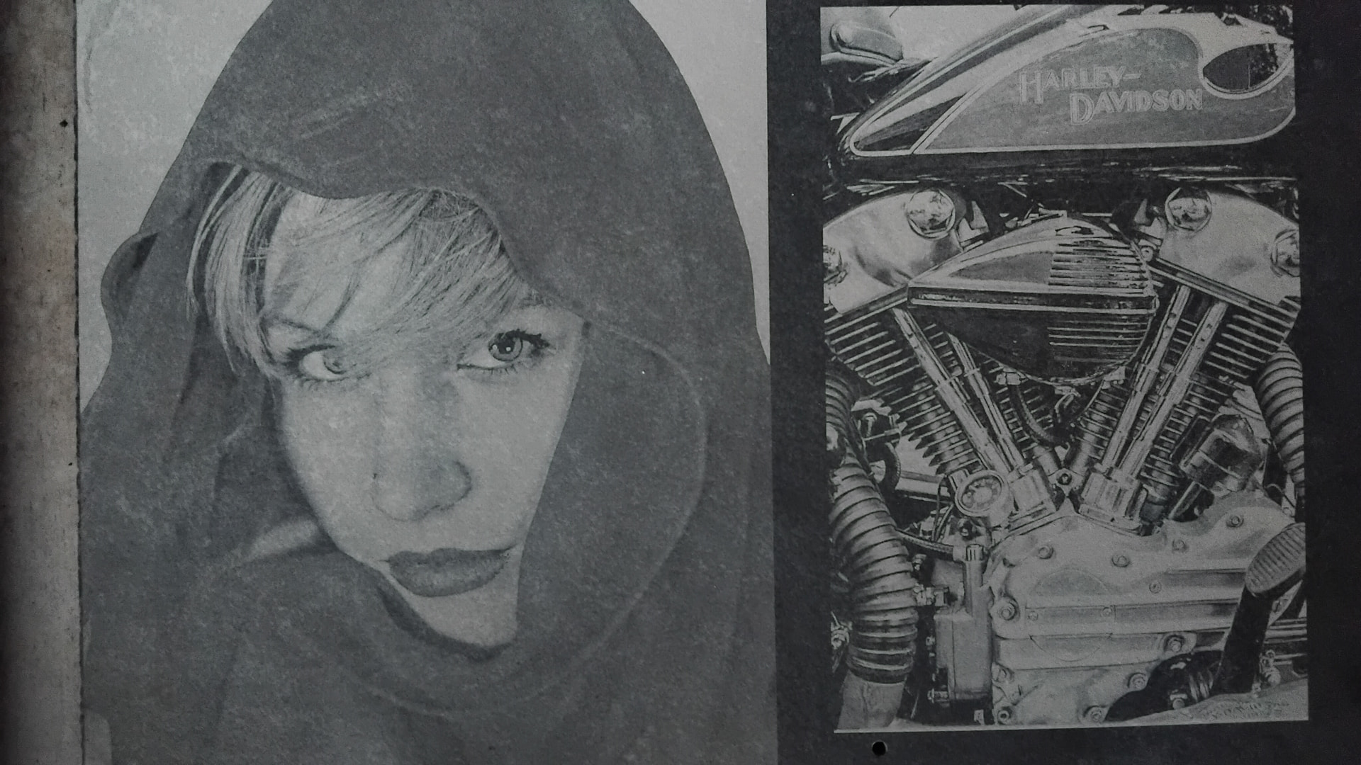

Have you looked at ā€˜News-Print’ as an option. I’ll never forget when I first got started, switching to newsprint and suddenly realising how it all worked…looking at my very first half decent image. It’s variable and may have that coarser look your after.

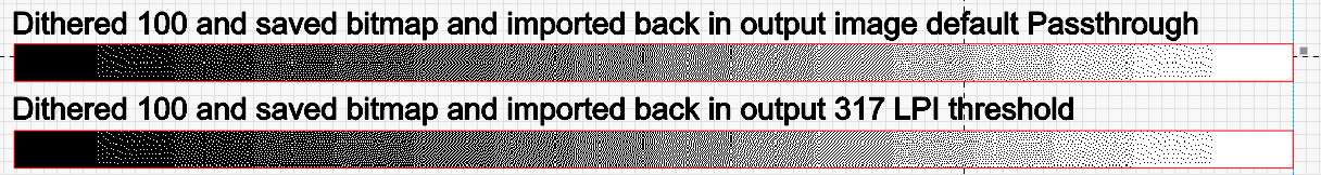

The image is just shy of 11.5 inches, 1148 pixels wide.
The passthrough version is the same 1148 pixel wide image, but when output it is about 5mm longer.
This image shows what the workspace shows.
This image show what it looks like in the preview display, and it outputs that way.
Both images are the same image imported back in from the same saved bitmap which is 1148 x 33 pixels.
Note that they both end on the right end flush, but the top image starts about 5mm in front of of the true starting point, see the box around the image.
The only difference is top is passthrough, and the bottom one is 317 dpi and threshold.

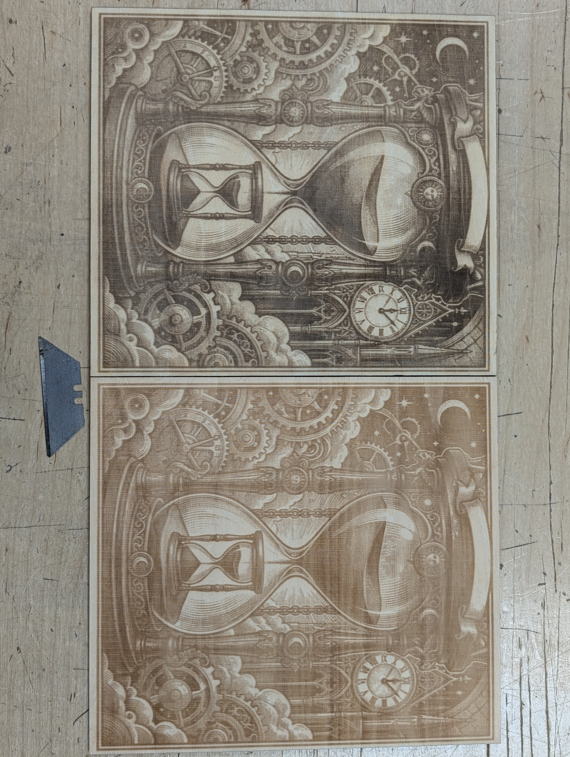

Grayscale PWM toning on an RF-CO2 on a Ruida at 1000mm/s. The dark one is borax-in-methanol, the tan one is baking soda in water but it turned out whoever mixed it up made it so weak it had little effect.
Utility knife blade for scale.
