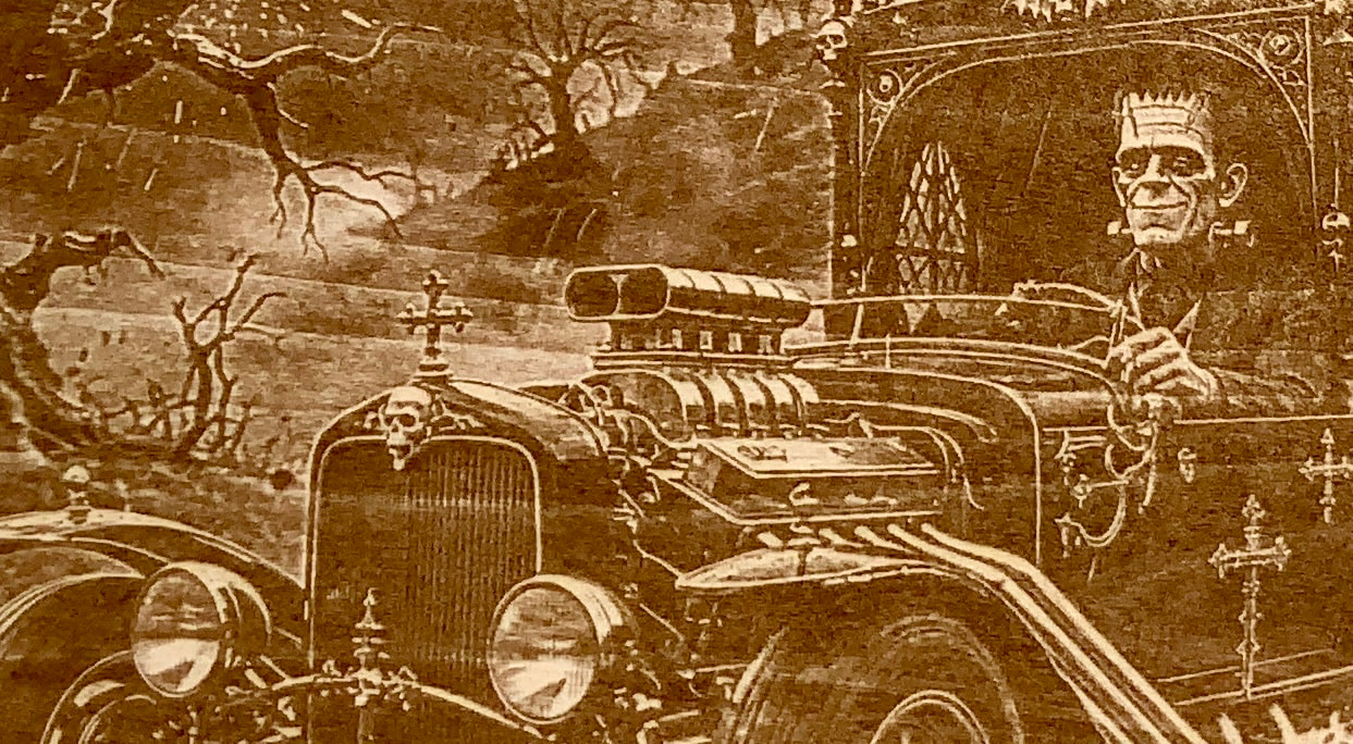

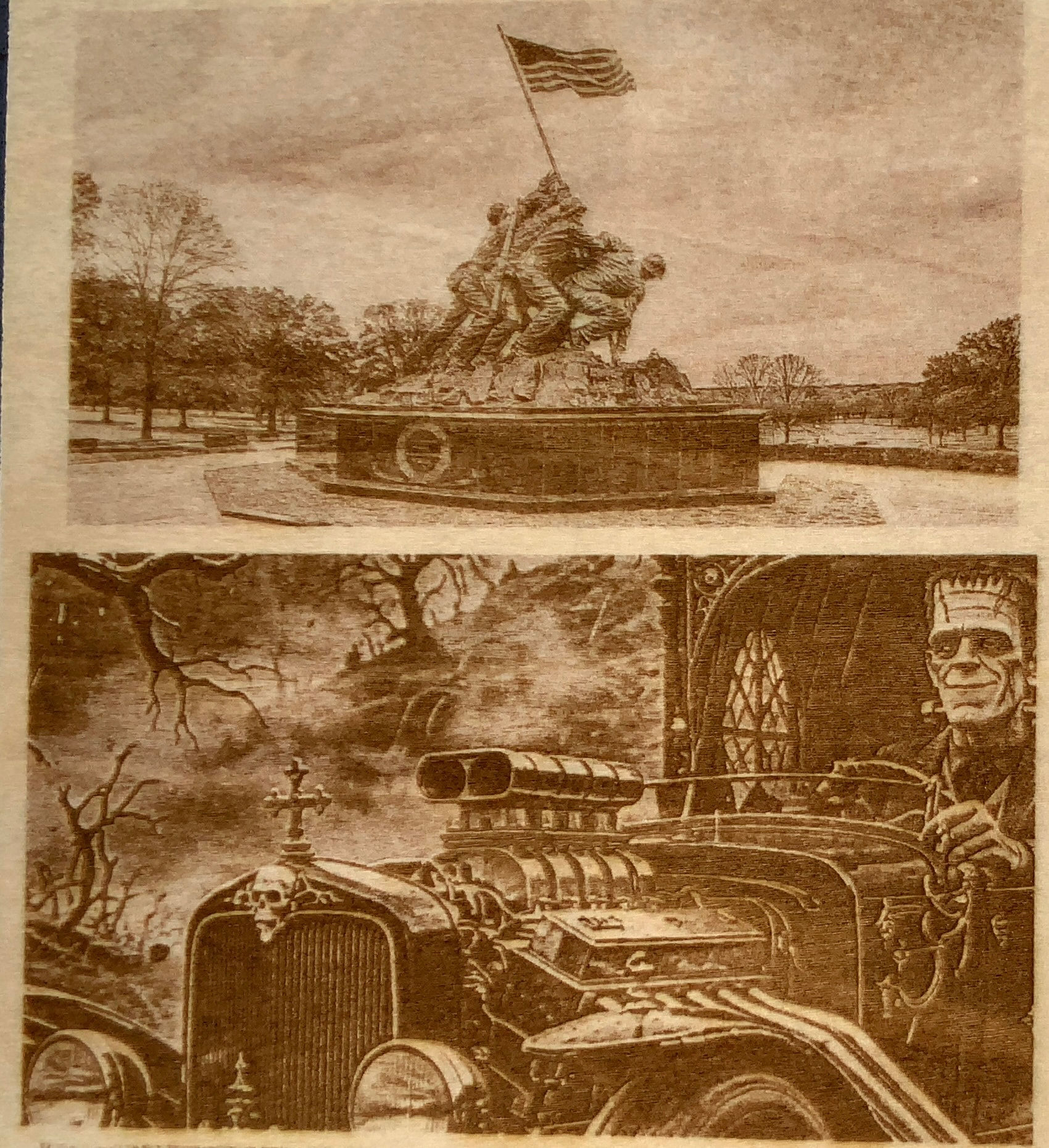

In the long run, I think we are stuck with some sort of dithering.
I’m sure there is a special term for lifting the grain and sanding, and repeat. I think for a finished piece before moving on to the next masterpiece, the cost of a nice piece of wood is acceptable.
That’s your best yet Jay. Really nice up around the front of the car (lights, wheels, engine etc) and back along it’s length. I would look right past that grain issue until you find material worthy of it.
Did you Dither or greyscale.
I do not think that is a solution. The grain is harder than the not-grain (proper term?) and the laser tends to burn less than it does in the softer areas.
I’m almost certain the term for this ply/wood surface working was mentioned here on the forum and the strange thing is I heard it used in a TV program that same week. Never heard it before or since…like a word only a tradesman or artisan would use. I meant to look it up was too busy with cameras and slate at the time.
Anyway, I guess it just a quick sanding for the practice ply and a reasonable investment for a quality finish.
I searched and the best I could do was “heartwood”.
I like to do the “cloth test” - if it sticks to the wood fibers, then the material needs some sandpaper first.
That was all grayscale no ditherallowed. I think I have hit in the rirght settings. Mission accomplished, it can be done.

Yes, that’s great news about the greyscale…but is the mission truly complete! I noticed up at the old spooky mansion, there may be a little loss of detail.
Problem is in order to get that last little bit of detail will screwup the other areas. I blame it all on the wood.
Working on other grayscale ideas.
I may run a dithered sample just for comparison.

Everything you suggested can be done with trace image and masking, but it isn’t worth all the trouble. Every area could be done, but that snot my objective. I want a standardized setting that can be tweaked a little and give good settings.
I did that with a family picture that I scanned with my 30 year old epson scanner. I adjusted the image with my settings and did a minor adjustment and got pretty good results first go.
I don’t think that doing any of this on wood is a good choice. I will keep posting stuff
I tried something yesterday. That was to use my setting, but changed grayscale to Stuki.
6 of 1 and a half dozen the other.

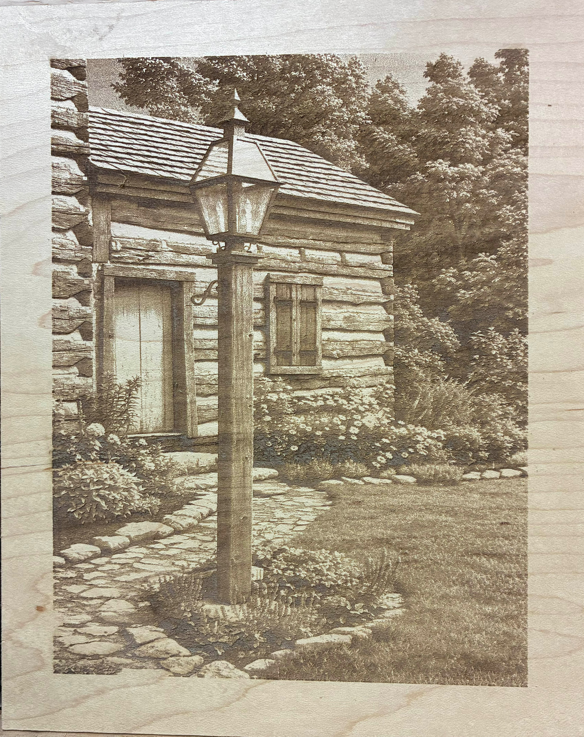

Still on basswood. Grain still shows up.
It is probably easier to get dither to work, because you just need to control power and speed. 317 DPI.
Frankly I don’t see any real difference. Stuki may be a little sharper.
Stuki, not as bright.
Grayscale
Definitely where the grain is heavy it’s noticeable and not really for finished work, But apart from that, to have the greyscale look as good as the dither is good and will certainly come into play at some stage for future makings.

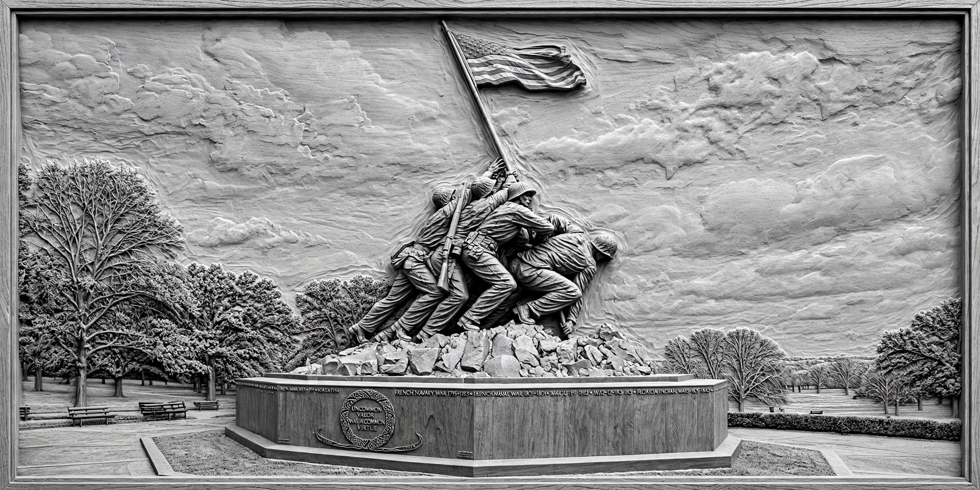

I just had to jump in here again, forgive me. This is 3D ILLUSION with GRAYSCALE
Ferg
Looks great you can see the depth,and the trees look further back. The biggest effect is in the grass. It looks as if the blades of grass get bigger as the lawn get closer to the front (lower edge).
I see that your power setting are a little higher than mine. I can tell that because the darks are deeper than mine.
I haven’t tried the higher powers, because I was trying to get as smooth surface as I can.
I wonder what the Munster mobile image would look like with a 3d effect.
Doesn’t look much different, but it stretche the front of the hearse some, and it put the mansion farther back, and added more foggy haze.
For a little fun and a lot more action.
Crazier yet. I find it interesting that there is even detail in the under carriage of the car.
I just had to try something with the memorial image. I went back to my original chat with meta, and it assumed I wanted images for laser engraving when I asked for a 3d effect. This is what I got. I also got a .stl depth map for CNC which I am sending to a friend to see if he can produce a 3d carving.
