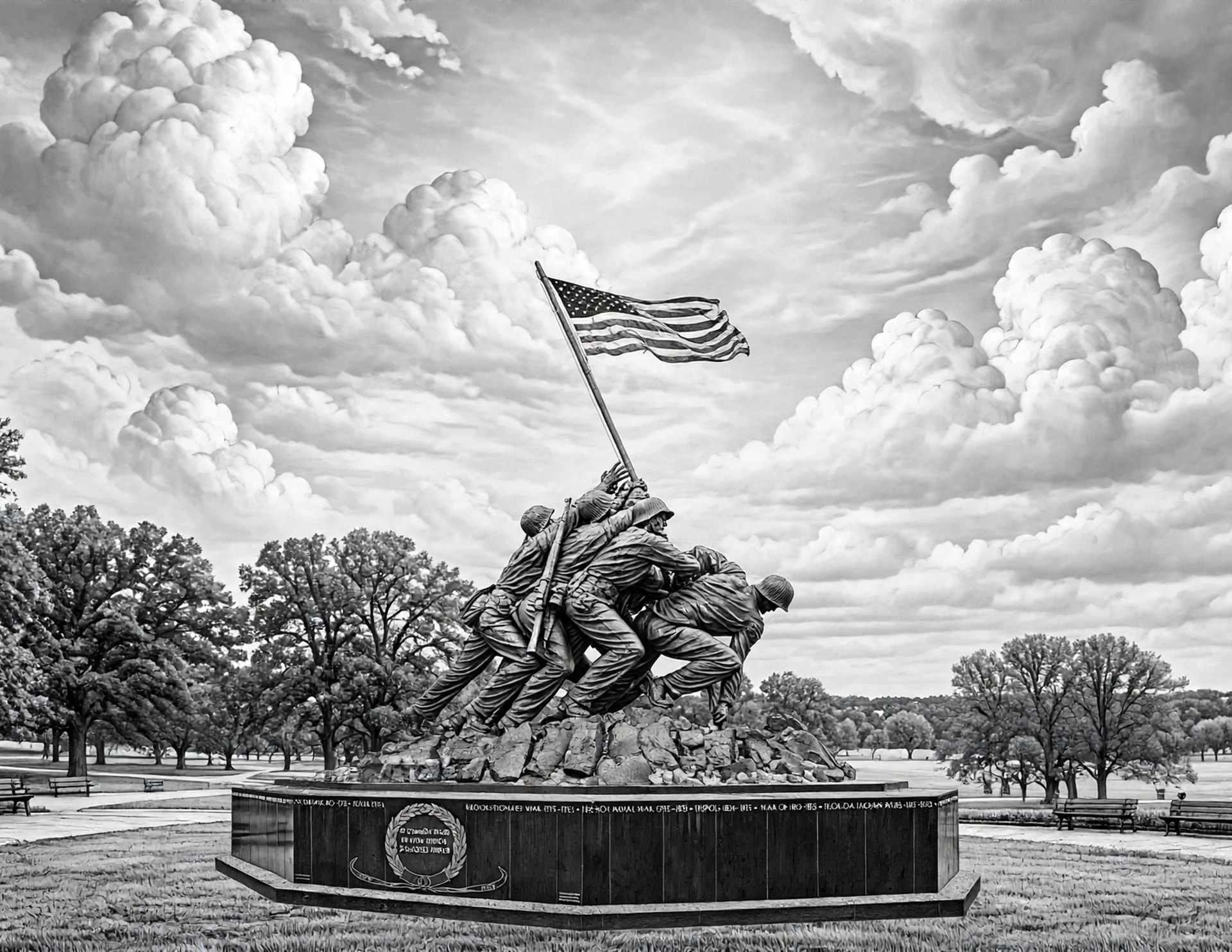

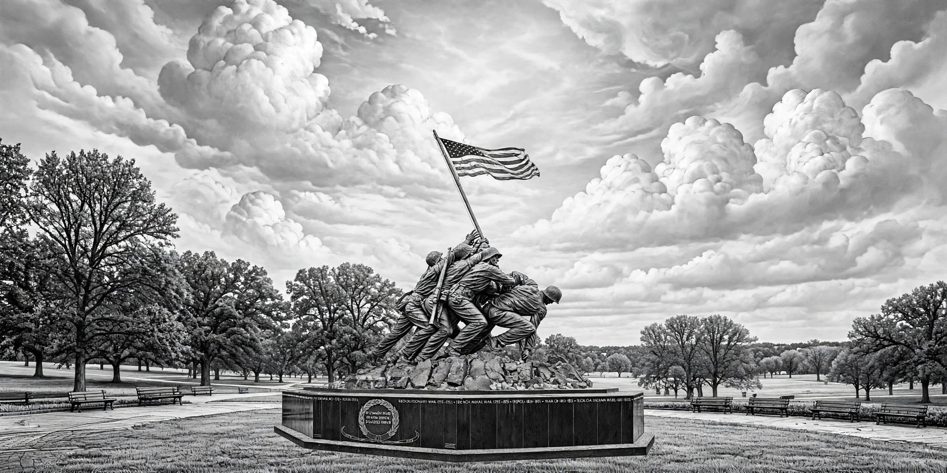

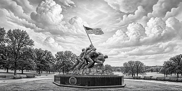

How is this? Problem is they are smooth grayscale images again.
I personally like this version better. Could a little bit of ā€œdramaticā€ be taken out of the sky, just a little to give most attention to the center of the image?
Jay, I just had a thought. What if you tell the Ai to brighten the darkest areas, I believe the clouds are getting lost because they are mid-tone.
If the monument base etc is lighter or Hatched/Cross-hatched then the clouds will be on an even footing and should lase…maybe.
It’s the same problem on slate
Actually, you could Trace the hatching and run it on another layer, too however you like it.
The first thing you have to realize is Ai is not Photoshop.it is mor like a 2nd grader trying to color within the lines.
Tracing is the worst thing you can do with photographic images in Lightburn. Every one of the traced area burns the same shade. It works great for line art, but not photos. That’s why there is the various dither patterns.
When I asked it to make the image a .jpg file, the image I got had 2 flags. I had to have incorrect that.

All the images I have created hav actually been in a RGB grayscale 16 bit format.

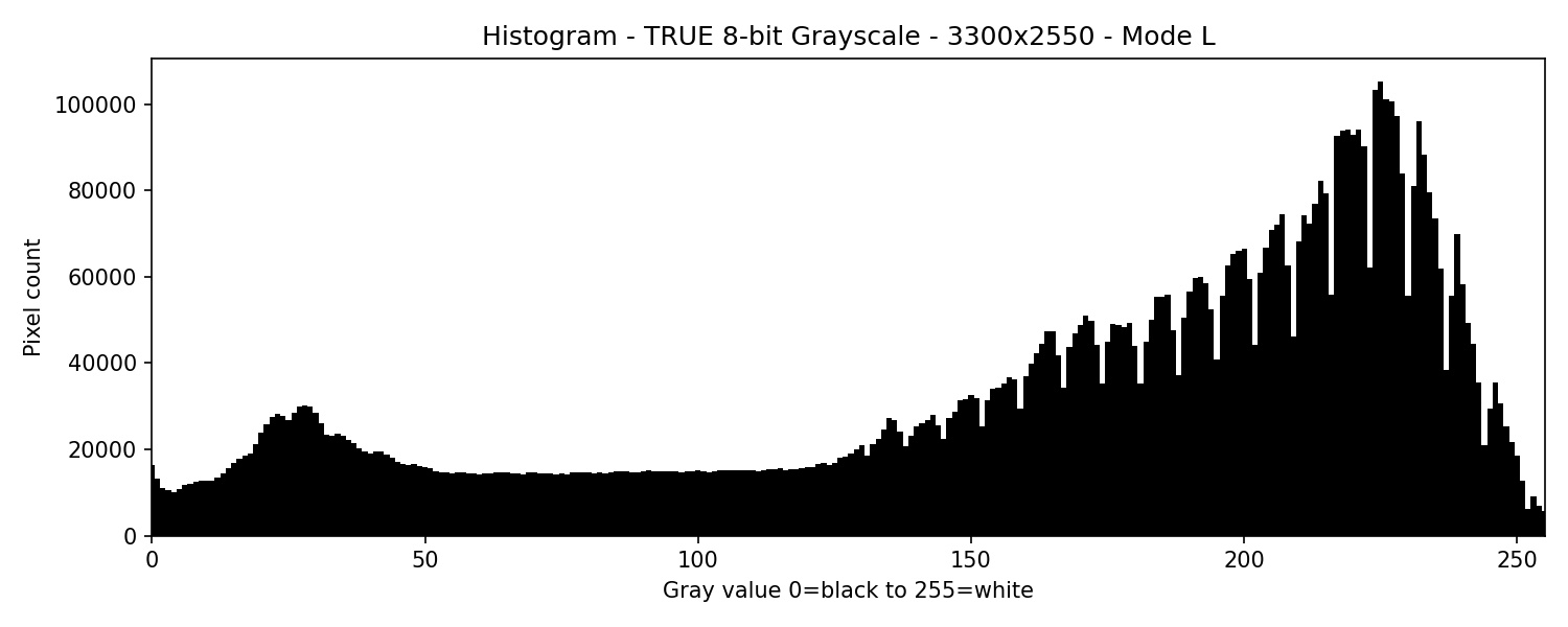

This image is a true 8 bit grayscale image
This is the histogram for this image.
  • Range: 0 to 255 full range (no clipping)
  • Left peak = deep blacks (statue, flag details)
  • Middle = statue, trees, grass
  • Right peak = bright sky + realistic cumulus clouds
This is now laser-ready — true 8-bit grayscale .JPG, not RGB.
Now I will have to tell Ai when I start a project photographic not line art, that I want 8 bit true grayscale images. It will make a big difference in file size as well.
I keep learning. Hopefully I remember all of it. You will notice the image is lighter that the 16 bit version above. Same image bit depth is the only difference.

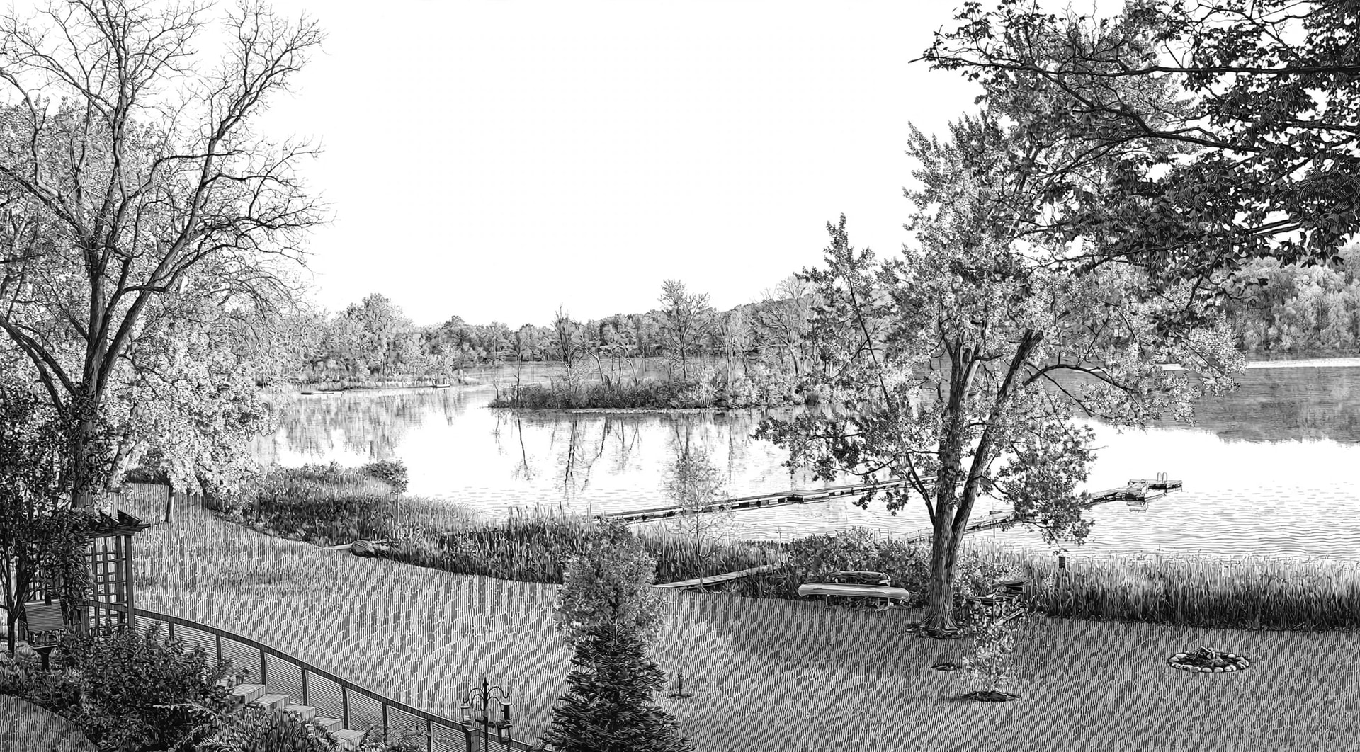

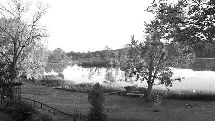

I do have another less complicated image to play with. I have just started playing with this image.
Original color image out my back deck.

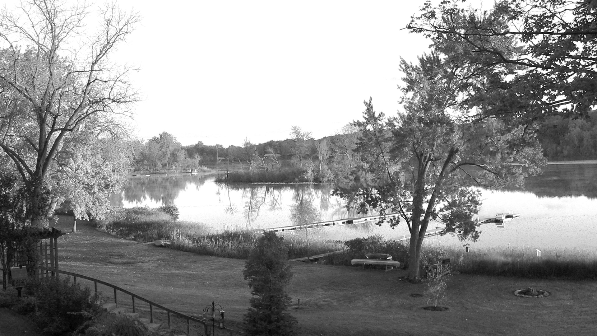

B&W 8 bit adjusted image. Lightened converted image by 25%, and Ai adjusted contrast in the shadows. Decent B&W image.

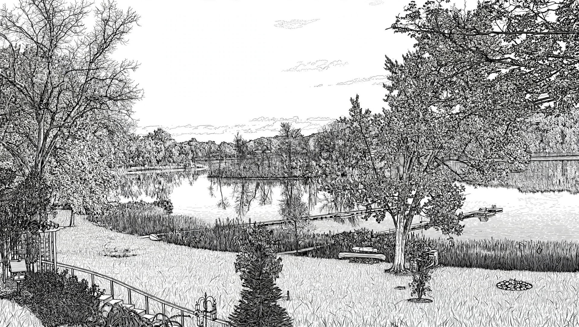

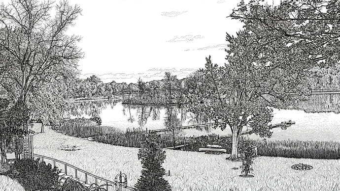

A line art version.
All are still in a 8 bit grayscale format.
A very busy ish image. Not a good candidate for engraving.

I think why I got the good results of the centerline image was the fact I modified the brightness/contrast of the converted grayscale image.
That last image would look cool on slate or a tile.
this is the script I used used on the adjusted grayscale image.
