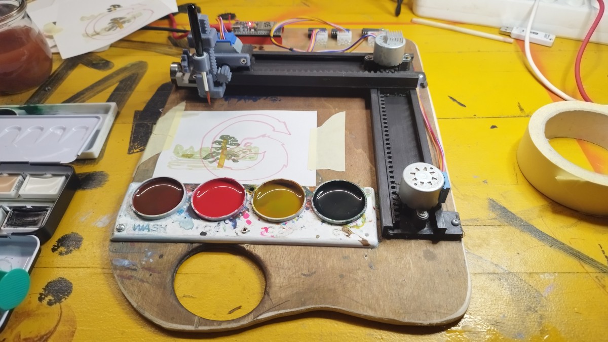

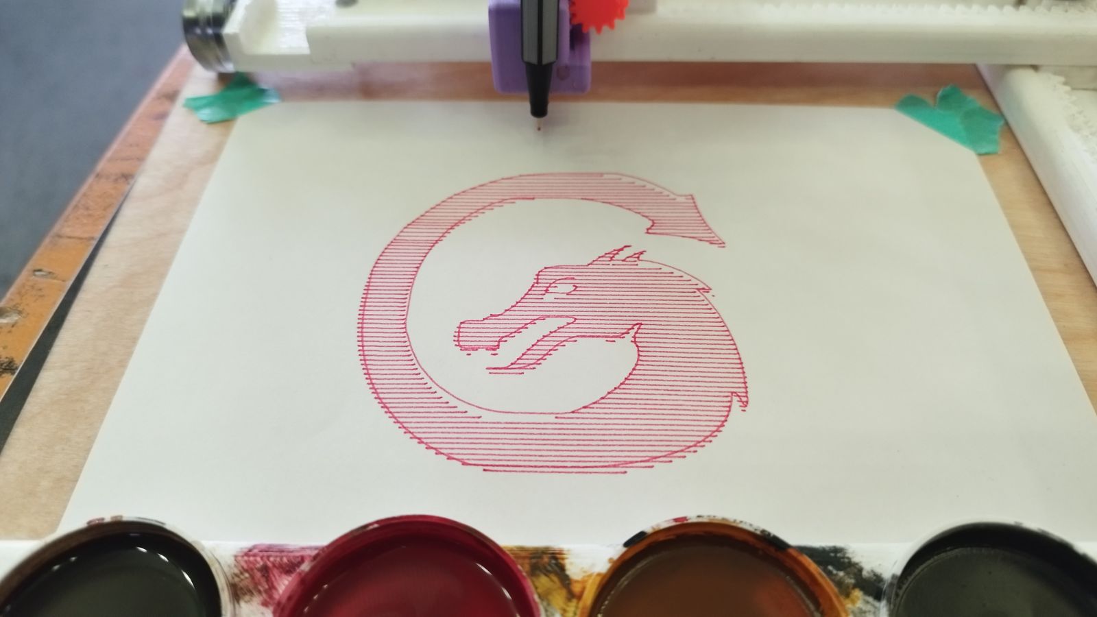

We have been working on this great DIY project to make a low-cost art painting machine for workshops, creatives and gcode-geeking enthusiasts. The plotter mechanism is based various freely available and open designs, and is fully 3D-printed. Unlike all those “pen-plotters” out there, this one is using a real brush, can pick up colours, wipe them, wash the brush and apply your artworks onto a size of approx 130x120 mm.
Documentation still in progress on: Brushograph - SGMK-SSAM-WIKI
brushograph_closeup

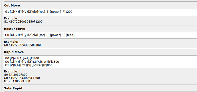

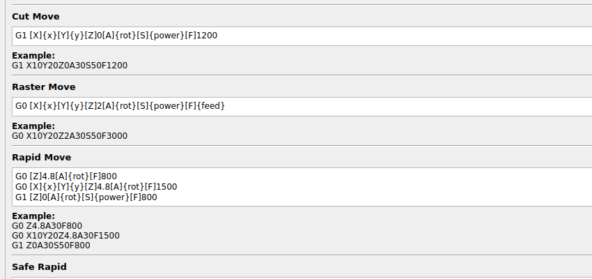

It turns out Lightburn can be a very easy start to get your art ideas and designs onto canvas. But we had to modify a few things, custom g-code settings that allows lifting the brush during rastering (a problem desribed earlier in this forum, @LightBurn still hasn’t implemented a pen plotter mode) and an external python script for the colour pick-up and washing the brush. Luckily @Aaron.F is sitting next to my desk and is a lightburn expert and g-code geek! Thanks for adding the “art” tag to this forum. The settings file is in the github repo linked above.
The main thing was adding custom gcode for lifting the brush properly… for line scanning that was a problem. By modifing the Rapid Move with an additional lift and drop gcode it solved it.
Question to the community:
We were wondering if there is anyway to send the gcode directly from Lightburn to a local pythin script (or webapi) and receive it in the Lightburn software again to run it (and look at it in the preview). At the moment i just “Save GCode” , run the script from the terminal and then “Run GCode” and selecting the new modified one. Works also smoothely, but no preview…

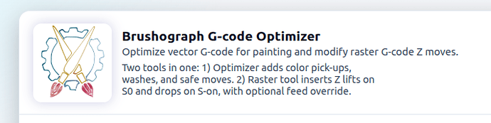

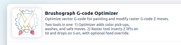

much easier now with this java script version:
forget the links above.

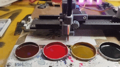

We spend another couple of days on a Brushological Retreat in a forest house, geeking with our painting machines, field-testing them on battery and learning and developing more tools for the openBrushograph.
We rewrote this javascript extension completely with g-code painter preview function, fixing the rastering issue from LightBurn exported gcode, recalculate the relative moves into absolute coordinates, applies a backlash correction and picks up colour.
