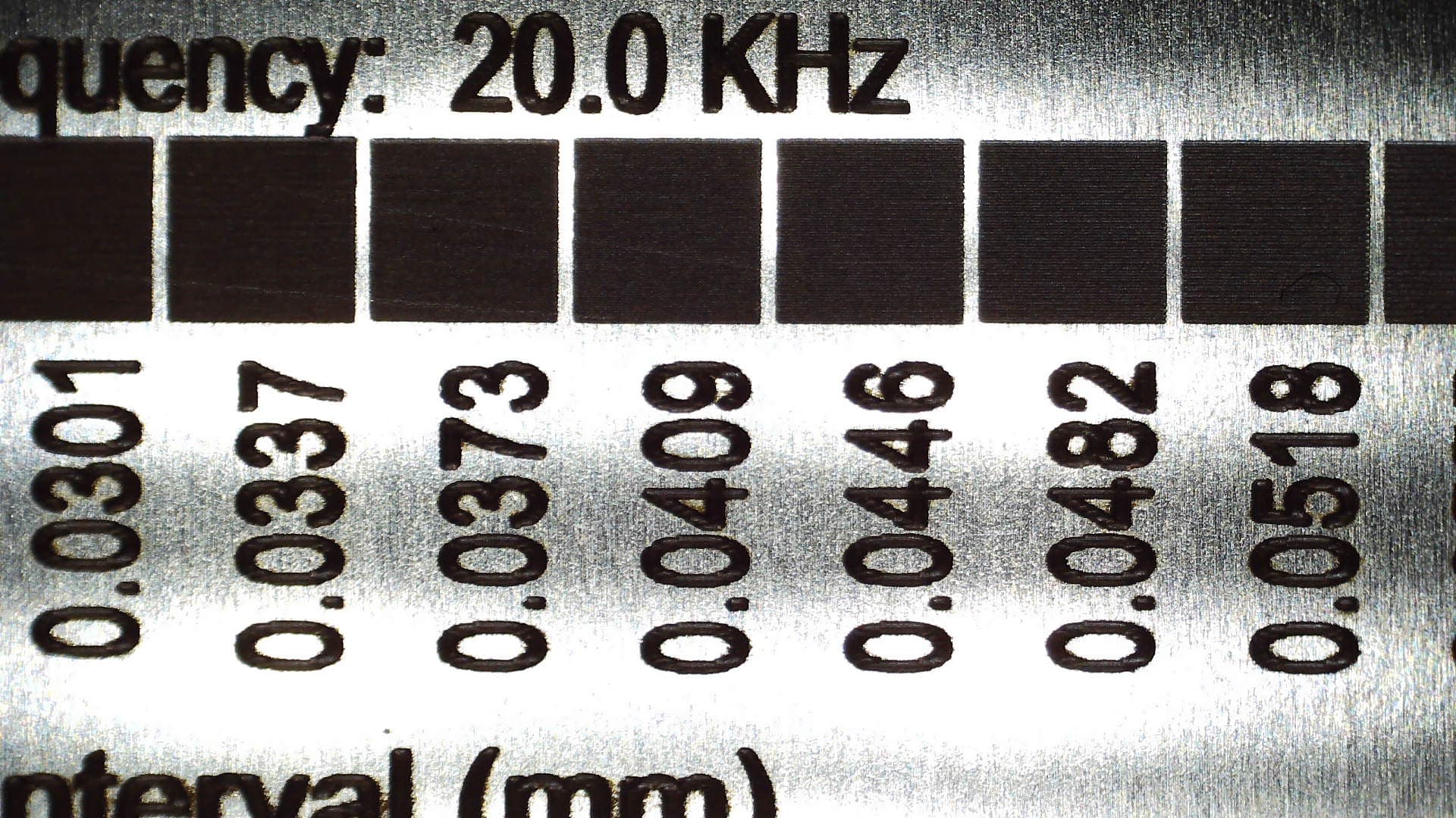

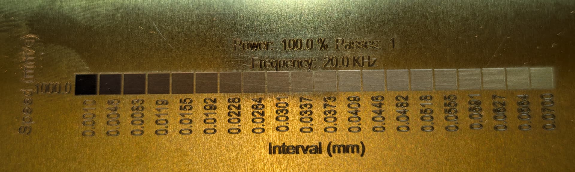

This shows the Line Intervals on brass, using a Gweike G2 Pro 30W with a 150mm lens.
The layer lines start disappearing at 0.04mm. Below this, the beam is overlapping.

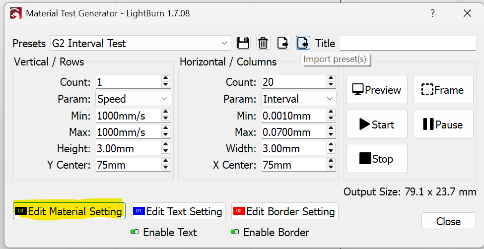

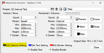

If you are using another focal length lens and want to do your own tests, you can import this preset file in the Material Test Generator
Galvo-Interval-Test.lbmt (1.1 KB)
(Edit Material Setting here and change the Mode to Fill)
