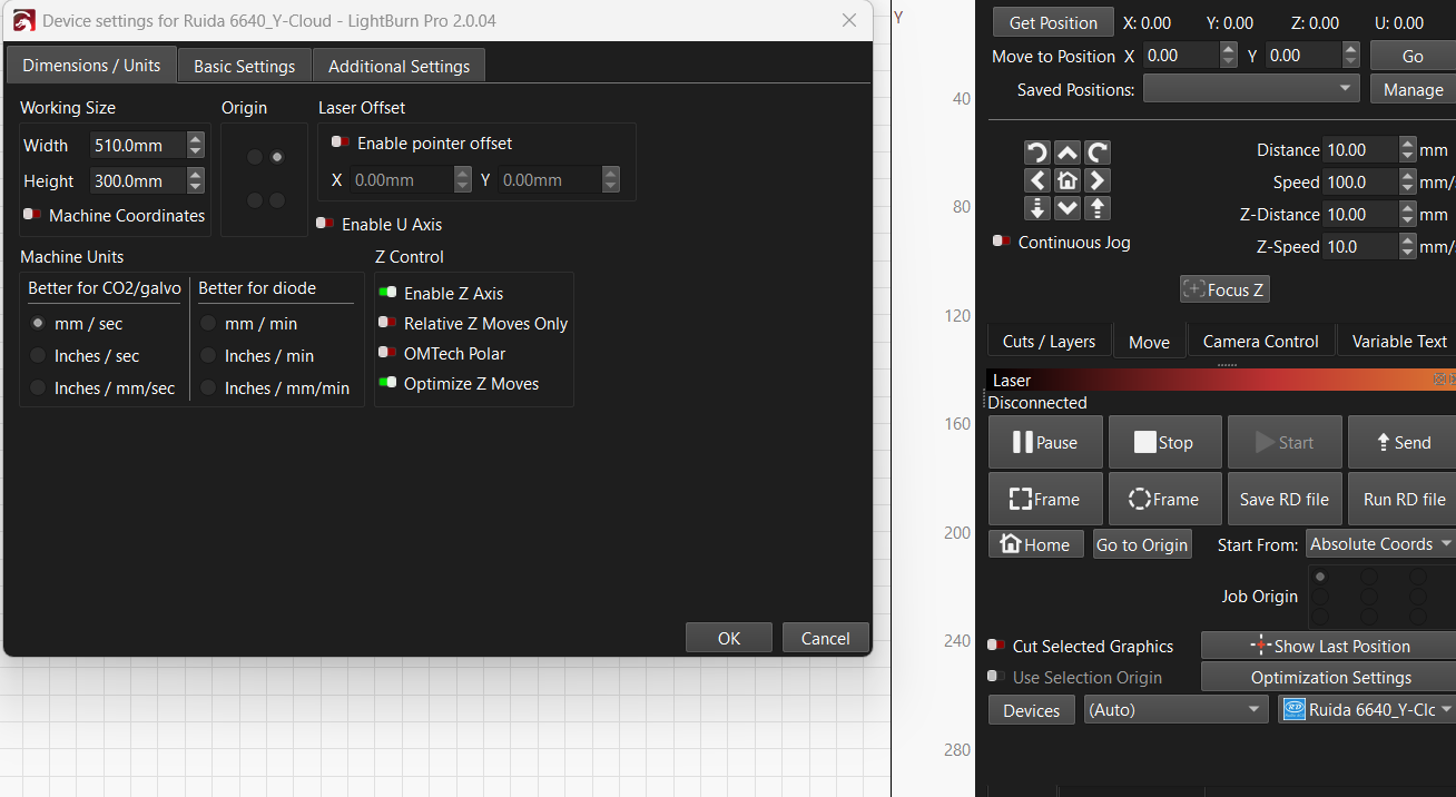

Z control settings are as follows per previous posts (running Lightburn 2.0.04)
Enabled Z control
disabled Relative Z moves Only
disable OMTECH Polar
Enabled Optimized Z moves

Can you check these settings:
Laser Tools menu >Device Settings>
  • Enable Z = on,
  • Optimize Z Moves = on
  • Relative Z moves only = off

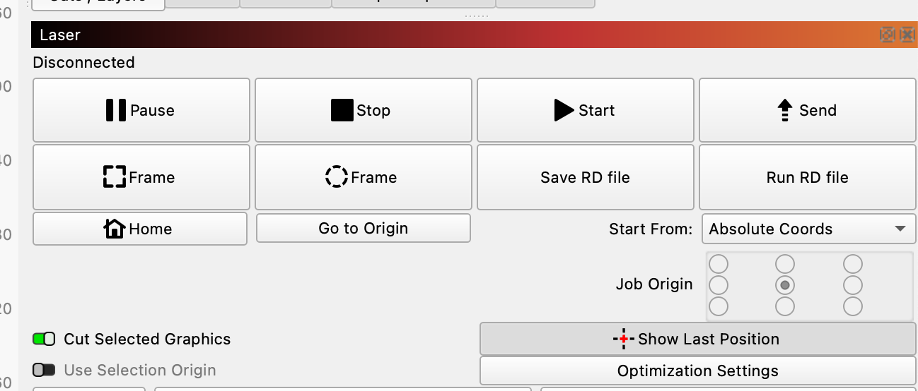

Laser Widget (on the right hand side by default):
  • Start From = Absolute Coordinates.

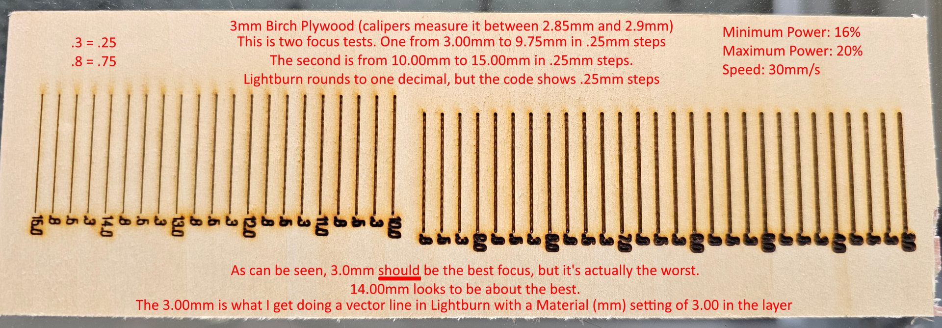

I don’t know if they broke this in version 2.0.04, but after almost a month of frustration, I found this to not work like it’s supposed to. I just did this today (see picture). Please note, when I enter the material height of 3.0 or go even more accurate by using calipers on the material, it looks like what you see in this focus test on the 3.0 side (far right). In these focus tests, I go up to 15.0 in steps of .25 as noted and 14.0 looks about the best. So if it DID work in Lightburn before, it sure as heck isn’t working now and it looks like you still need to do the 17.0 minus material height. I’m going to write tech support to check on this and run an actual project by putting 14.0 in the material field on the layer just to make 100% sure, but that’s where I am now with this.
Again, it’s been an insanely frustrating month as I’ve yet to do a single project with this machine and, until today, I did everything I could to figure out why I couldn’t get a good vector line engrave (or cut) doing all the right things. Also, “autofocus” produced the same as manually entering 3.0mm in the material field. Gweike tech support told me today to manually set it on the move menu, which is absolutely unacceptable to me if I have to put a measuring block in there and click up and down in Lightburn for everything since the machine and the computer are not within arms reach of each other. LOL
EDIT: Just an update. I did a small engraving and set the material to 14.1 (material with calipers was 2.9) and it was perfect. So in Lightburn 2.0.04 you still need to do the 17.0 minus material height math to get a good result.
